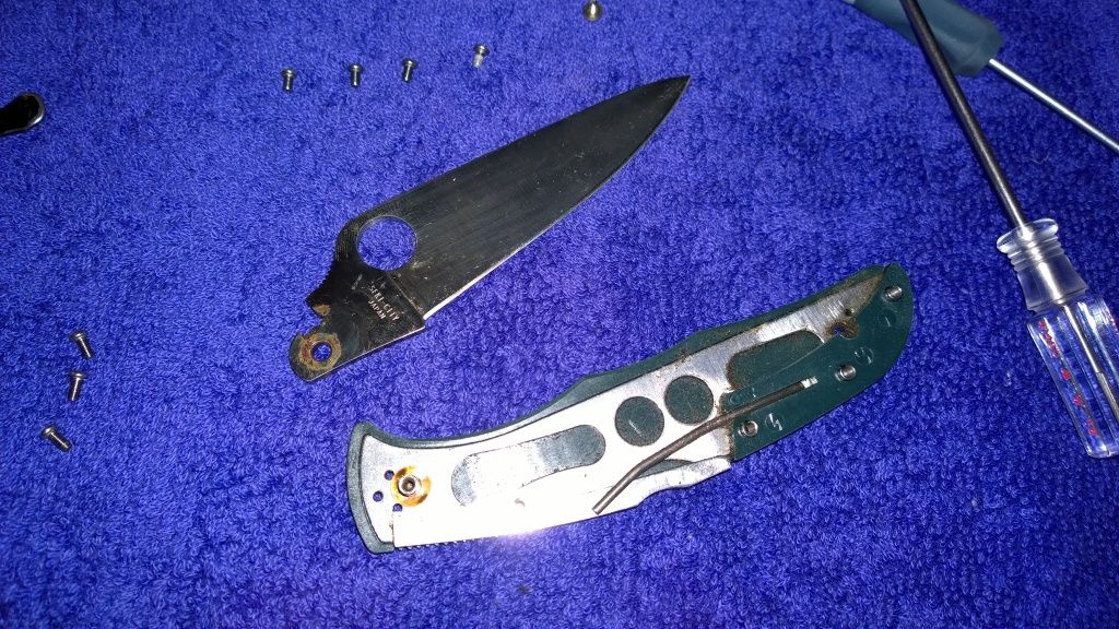

My zdp-189 Endura started to get a little more difficult to open so I took and took it apart and this is what the pivot area looked like. I was able to get rid of a lot of it and its nice and smooth again but I don't carry it as much as I used to.

That's scary. I never warmed up to ZDP-189 but I do have a Gayle Bradley on the way so I will watch for this.

I recall reading before that ZDP-189 has most of the 20% chromium content "tied up" as carbides, so this doesn't leave very much for stain-resistance as it normally would because it is low-alloy.
