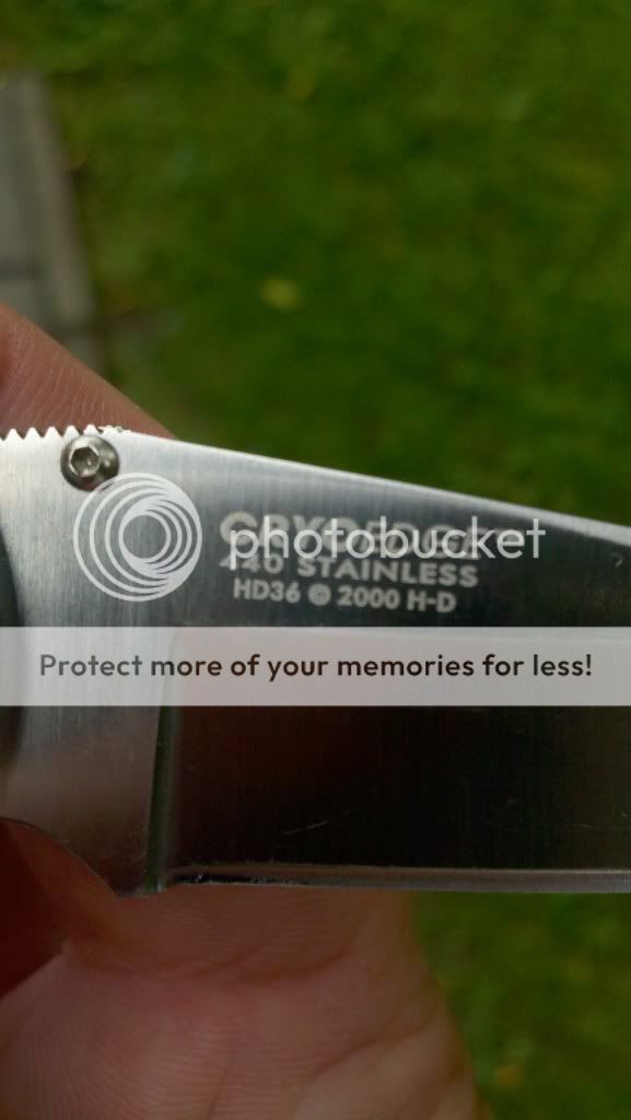

Anyone know about this steel?
Aug 11, 2012
810
Is the "cryoedge" of any importance? I figured it is 440a with a dip in liquid nitrogen? Just wondering if anyone has any experience with it.
I remember cold steel used to do that to 440 or 420; they called it Sub zero quench though. I forgot what they said it did though.
It isn't specifically a Cold Steel thing. Here's my layman's imperfect, and hopefully entirely accurate :D, explanation. Heat treating a blade changes carbon bases steels from ferrite into austenite. Quenching below zero, with dry ice is most common I think, converts more austenite to martensite than other methods. This allows for a knife that is harder and more wear resistant. In knives, I think it is more commonly used with stainless steels than anything else.

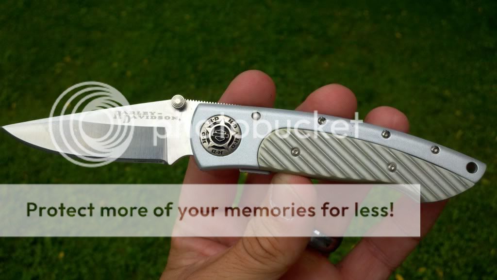

I'm looking to sell it to a friend and want to make sure it's not junk.
