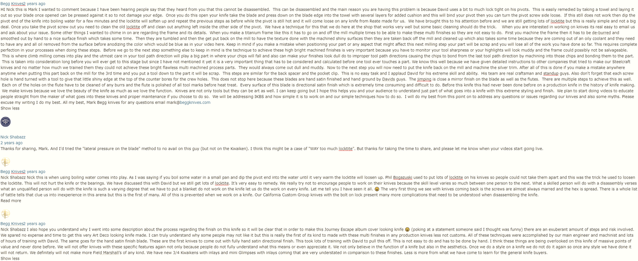

This was a discussion between Begg knives and Nick Shabazz over on Youtube regarding a Field Marshall but utilize the exact same pivot system as the Kwaiken
