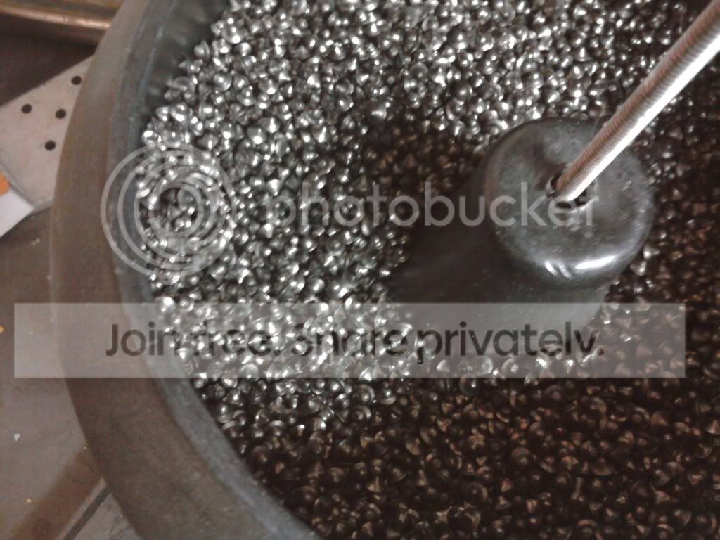

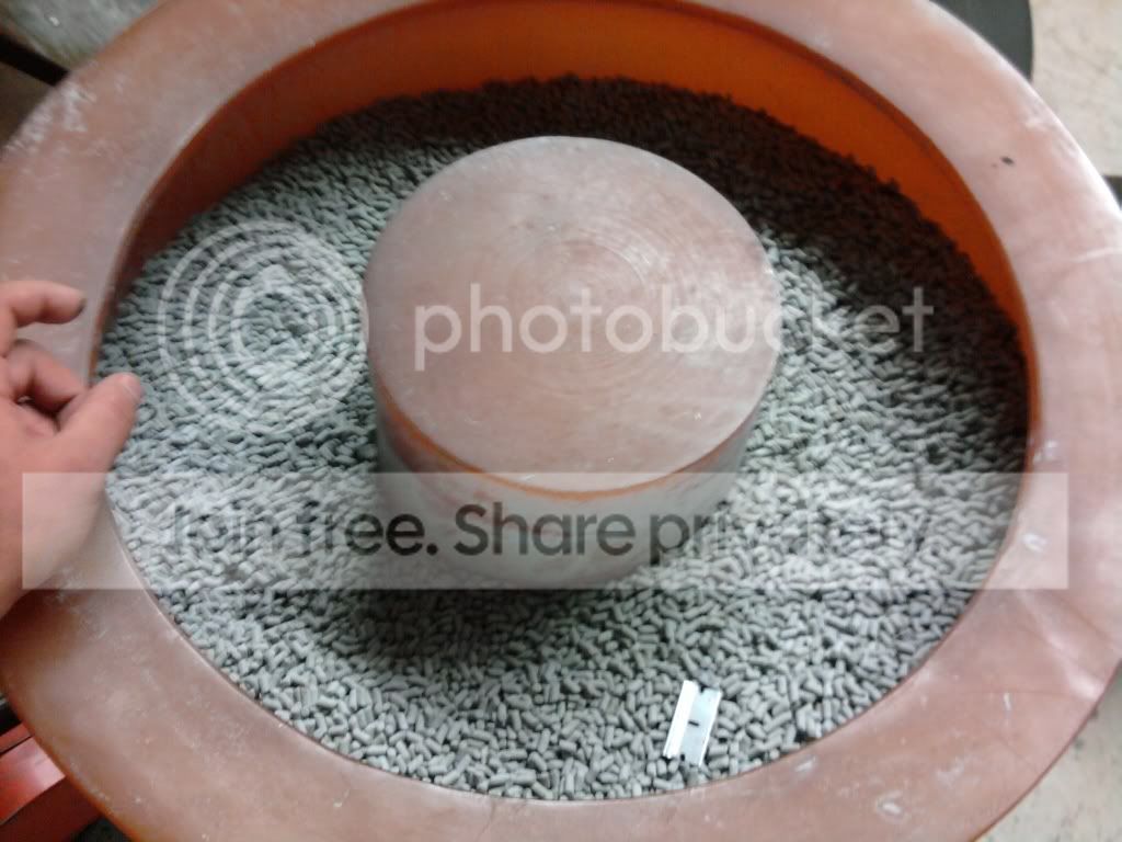

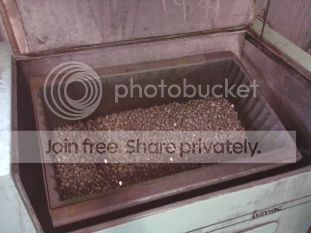

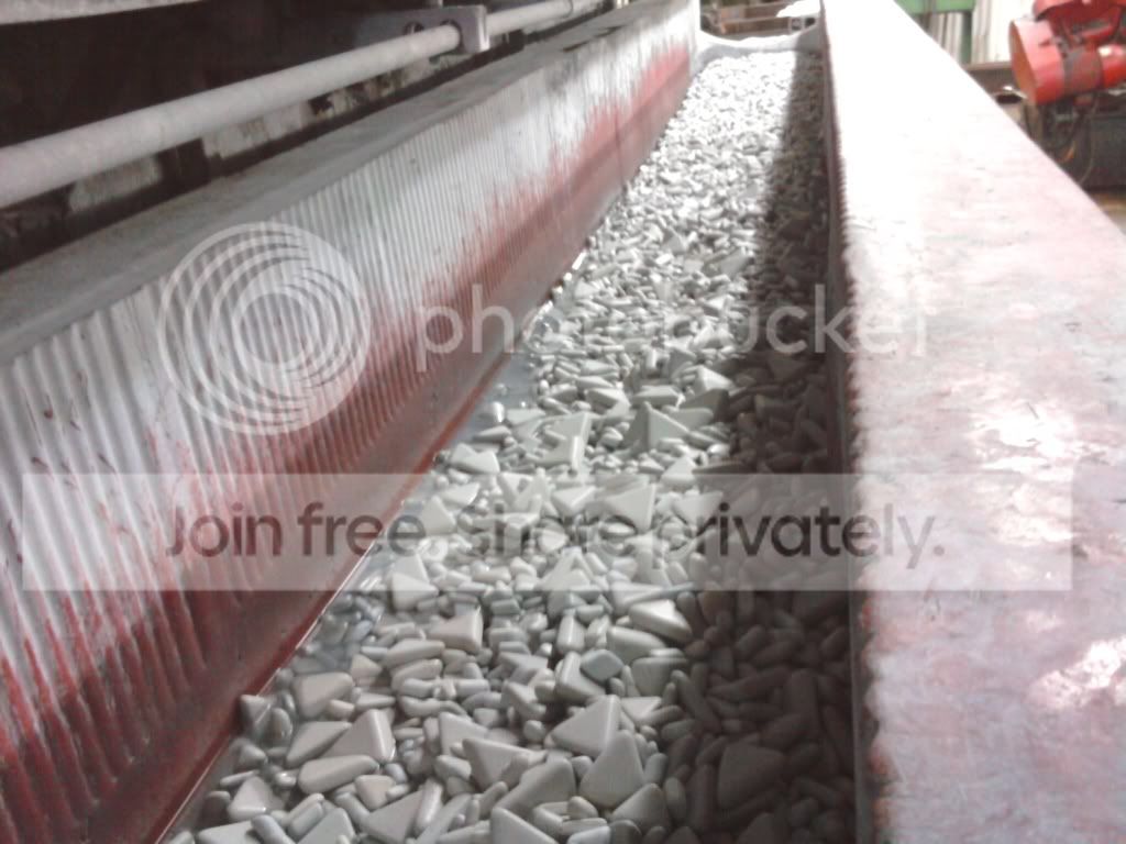

Here are a few we have at my work:
Small steel "UFO" shaped media.
Small round shape with small ceramic media.
Small square random ceramic for general purpose.

Our largest for oversize parts, and large batches. Upper right corner 8" Hort saw
There are all types of media for different applications.
Ceramic— The best media for removing large amounts of material. Great for rapid deburring, it can also be used for polishing. Ratios of media to parts are as follows: 2 to 1 for heavy material removal, 4 to 1 for deburring, and 5 to 1 for polishing.
Plastic— Produces a smoother finish than ceramic and can also be used for deburring. Ratio of media to parts is 4 to 1.
Porcelain— Good for burnishing and polishing. Ratio of media to parts is 5 or 6 to 1.
Organic— Leaves the finest finish. Can also be used for deburring. Ratio of media to parts is 3 or 4 to 1.
