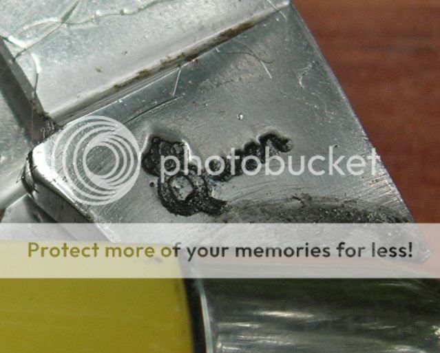

This is an older Queen, and I don't know what they used back then. It is sharp though, takes a good edge.
