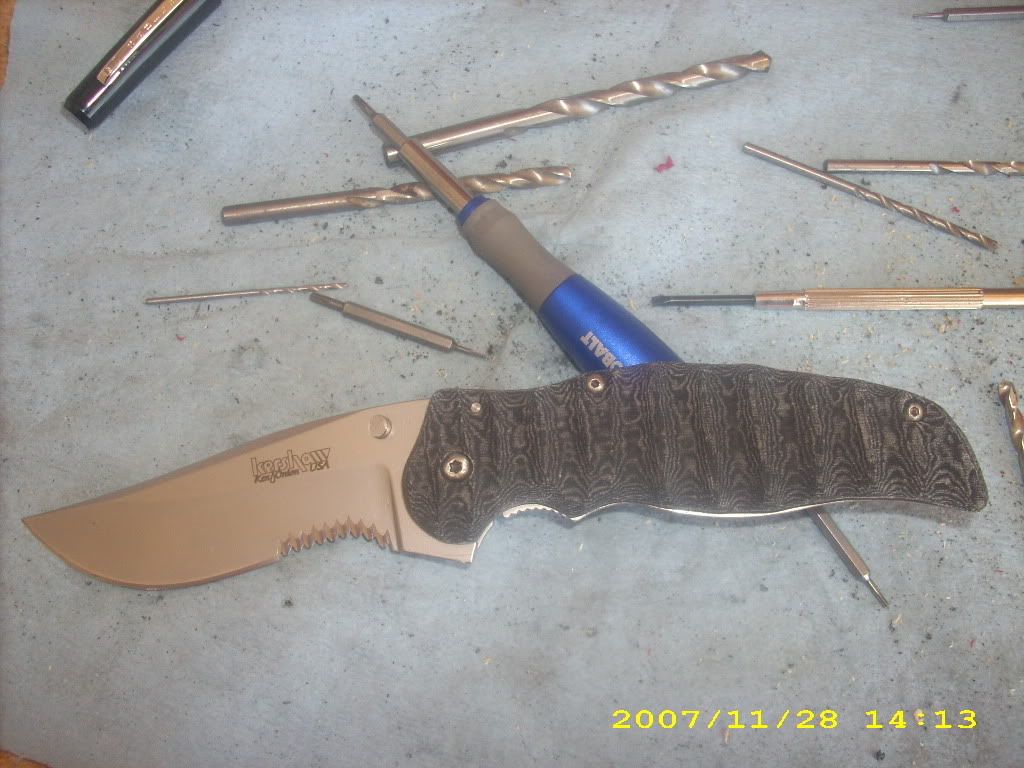

Post pics of your work please! I was thinking of putting some hardwood handles on - Possible?
It's definitely possible. The difficulty just depends on the knife. The RAM is pretty simple, others are more complicated. For the RAM, all you need is is a drill press and sandpaper. Belt sanders and other tools will speed things up though.
I'd love to re-handle my Speed Bump. The difficulties lie in machining the recess for the torsion bar and the attachment of the clip. I'm sure that many of the AO Onions are like this.

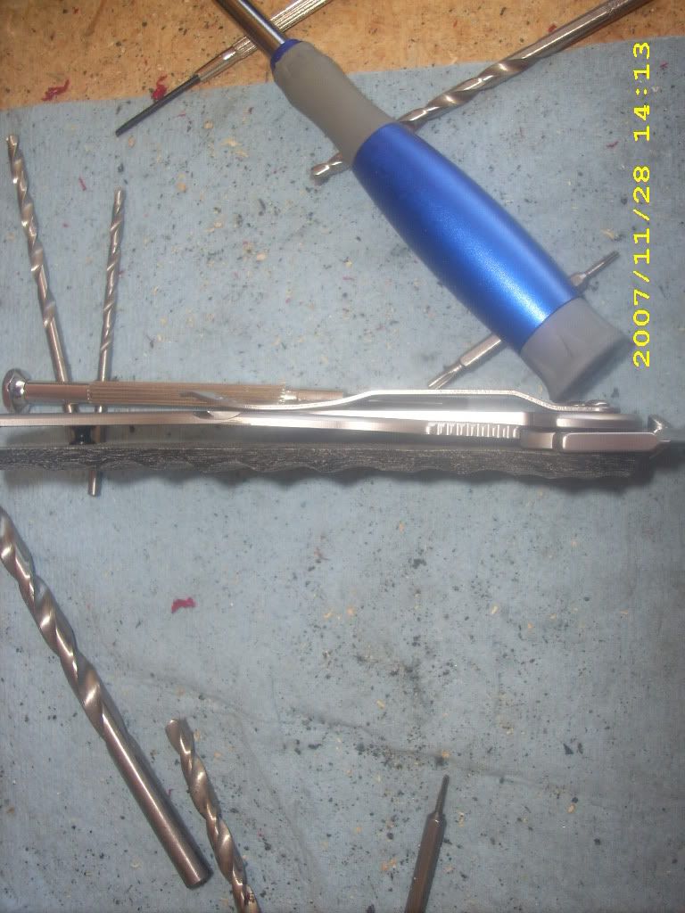

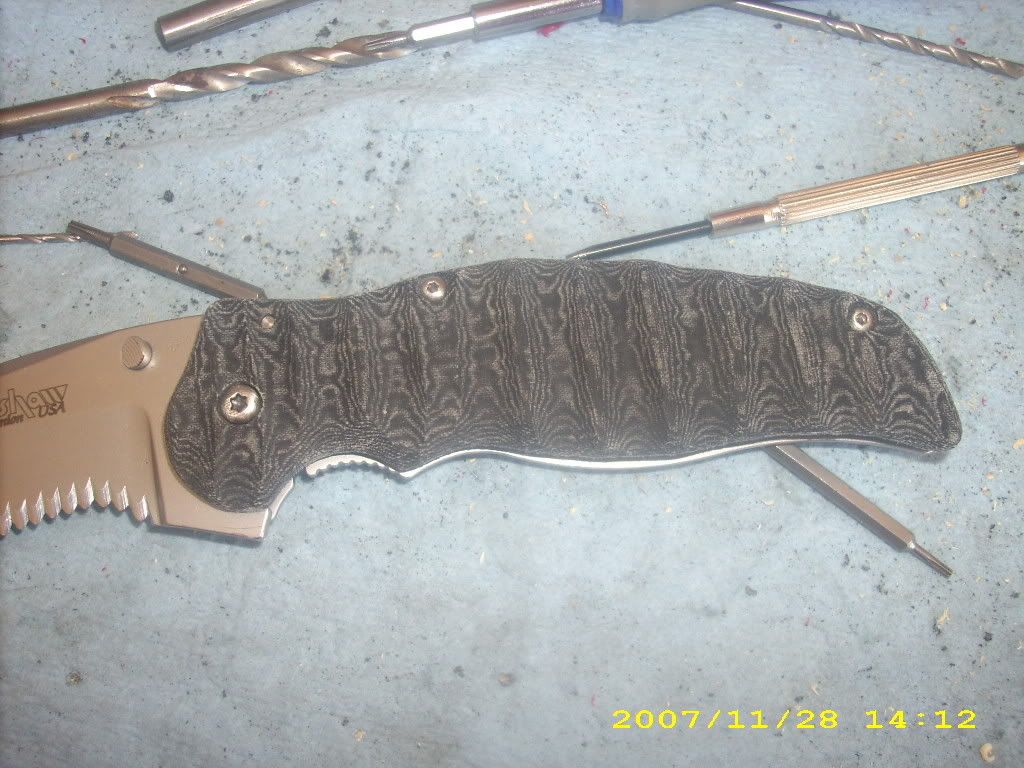

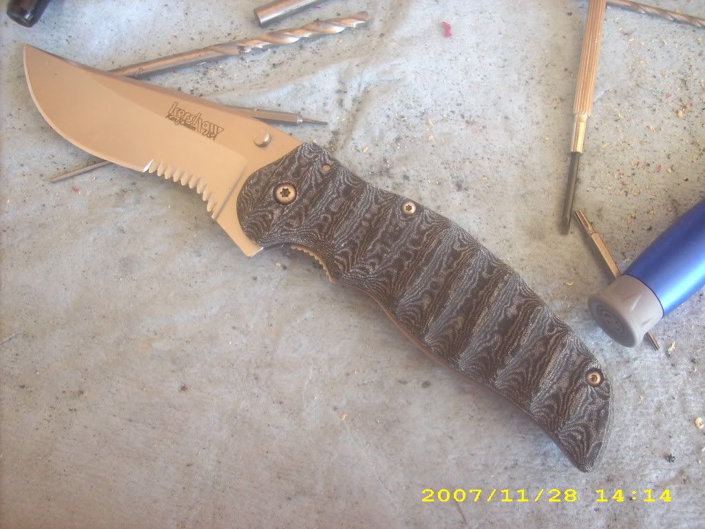

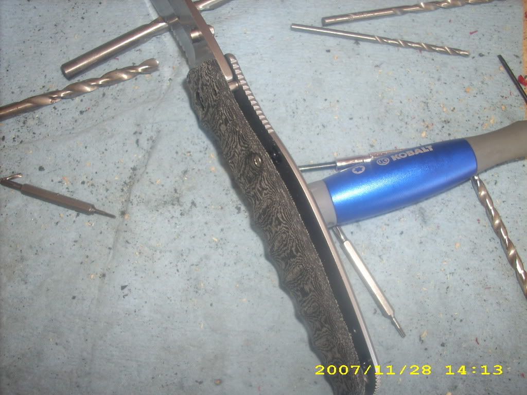

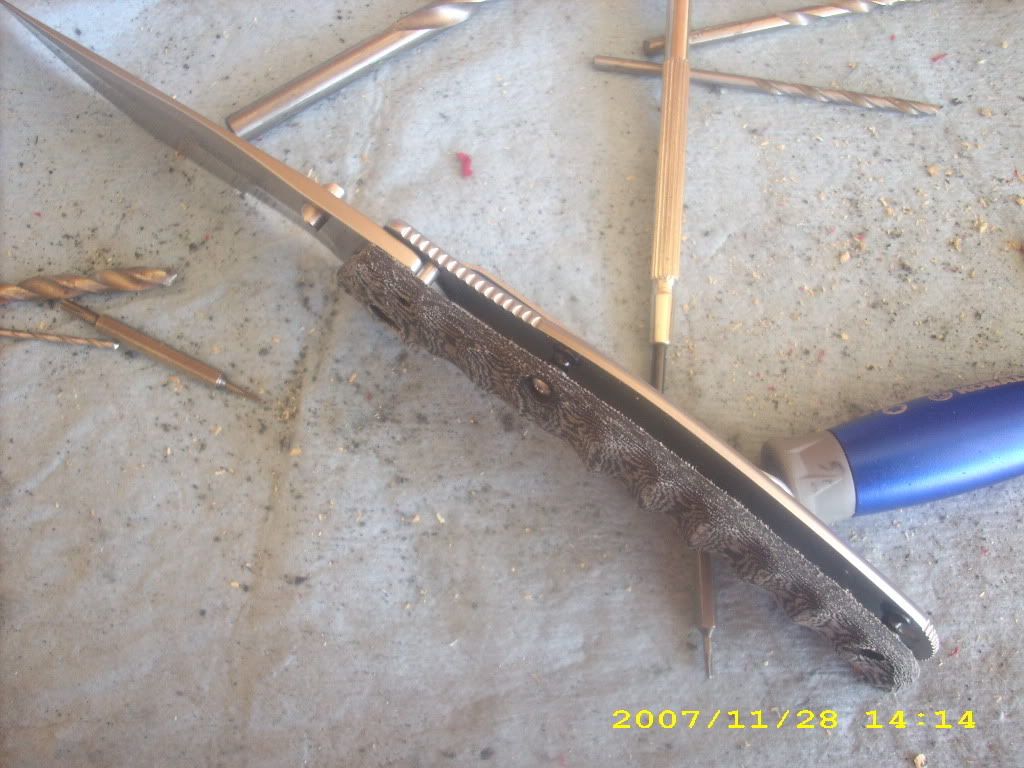

I re-scaled a Needs Work. Blue/Black g-10, new clip. Speed safe still works. Drill press, Belt sander and a dremel were the only tools used.

I would love to have a set in cocobolo like that. Looks great Phillip!! :thumbup:
Man that RAM looks nice. I want to see some nice spalted maple, or really anything I not that picky! Great work!
Nice Storm also, really makes it look like a new knife that is for sure.
