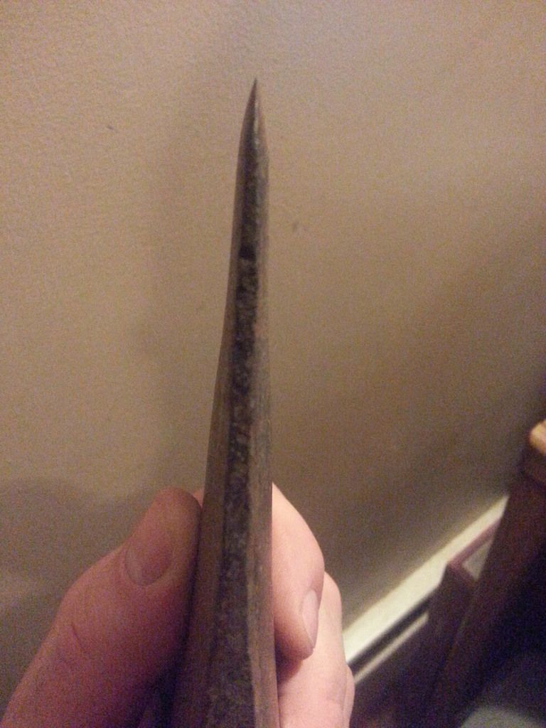

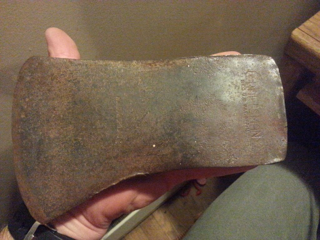

Anyone seen one of these? New to me, and interesting.
Sep 3, 2014
3,741
It looks like a normal Craftsman Michigan head, nice but nothing super special.

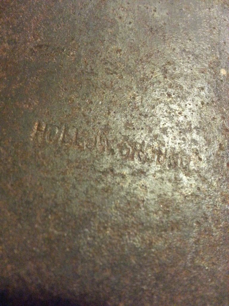

Then I noticed this.
See it? How cool.
Interesting! I've read references to hollow ground axe heads but not actually seen one.
From a previous thread:
Vaughan currently produces Made-in-USA axes (including double bits) that they say are "Hollow Ground".
Deeper penetration but more sticking? Marketing gimmick?

Awesome...I bet that's a rare bird and it's in great shape. Should make a great cutter, though maybe splitting tougher logs could be problematic? Try it out! :)
It sorta has both though right .... high cheeks right behind the hollow? Cool. Are you gonna hang it and give it a test drive?
Looking at the excellent 'hollow ground' double bit picture provided by Steve Tall the scallop or 'hollow' looks merely to be an exaggerated version of 'banana' grind sharpening that is favoured for high centerline domestic axes.
Presumably the performance of these is no different from flat cheeked Euro axes that were beginning to be imported in n. America after the second world war. Great blades for limbing and chopping, but not so much for splitting.
I haven't tried it to test it, but after the hollow grind it is full traditional American concave cheeks all the way, so may still work well for splitting.
It's not so much the wedging action of blades that causes problems but the 'sticking' of uniform thickness blades in wood. With a high centerline physical contact is most pronounced only at the middle and presumably this makes it less likely to be a bear to remove if/when the round doesn't split during a strike. All axes can and will split wood! But I do recall having to use chisels, hammers and wedges and even a chainsaw on occasion during my younger days in order to retrieve limbing axes that were hopelessly stuck and buried in ornery pieces of firewood elm or maple.
I understand, it just looks like this should get deep enough to reach the high cheeks and take that problem away. Maybe not, only use will answer the question.

Yup, looks like it would, it's much flatter and thinner and for much more of it's length.
Is it still hollow ground? If yes, how does it compare to other grinds you've used?
