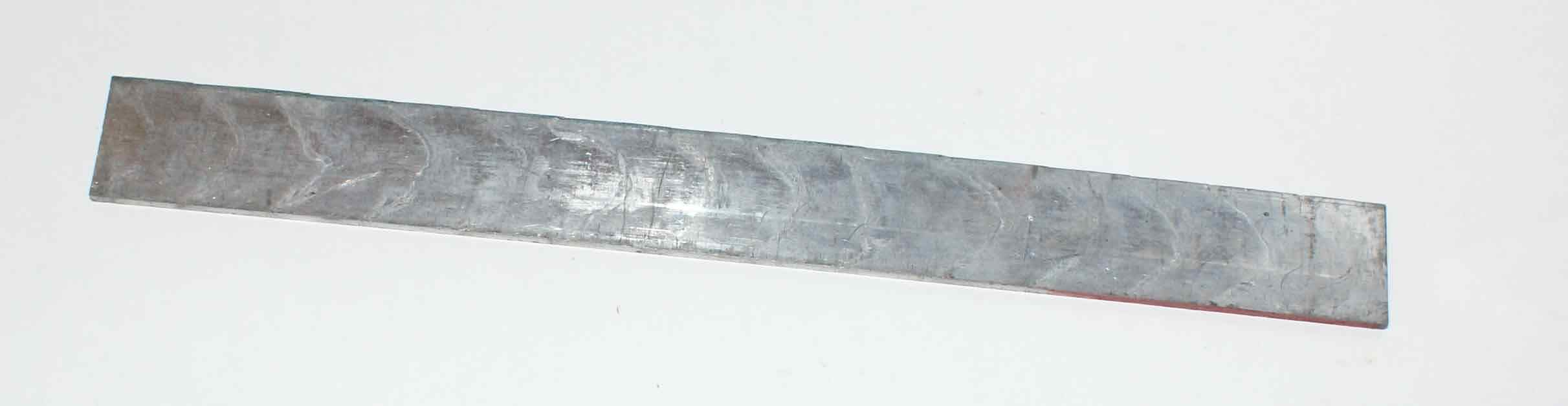

Lacking any beater knife I don't care about (with a considerable spine enough to experiment on as I would on a kukri), I'm going to cut up something like this:
- (put to use those thick metal strips I have lying around in the garage) then grind something on it that will resemble a "bevel" and experiment some convexing with a stone. This steel being quite soft, it should be quite fast obvious whether I'm doing something right or not.

Thats the way to do it:thumbup: Dont forget the sharpie!
I'm so doing that!
