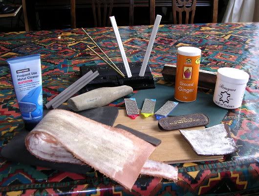

I haven't done much sharpening on mine but I've put convex edges on knives that didn't come with them so the sebbi will stay convex
if you look in this pic
you can see a block of wood with some foam backing glued to it. I hold abrasive paper on this with drawing pins to keep a convex edge sharp.
often I'll just use a mouse pad though
