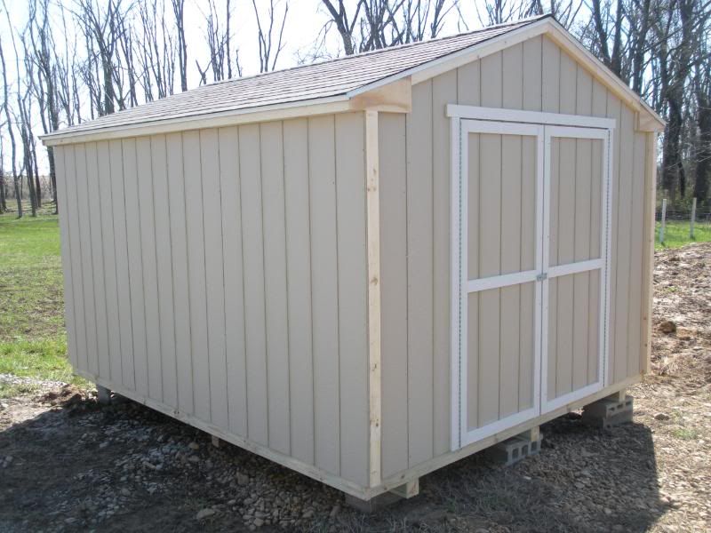

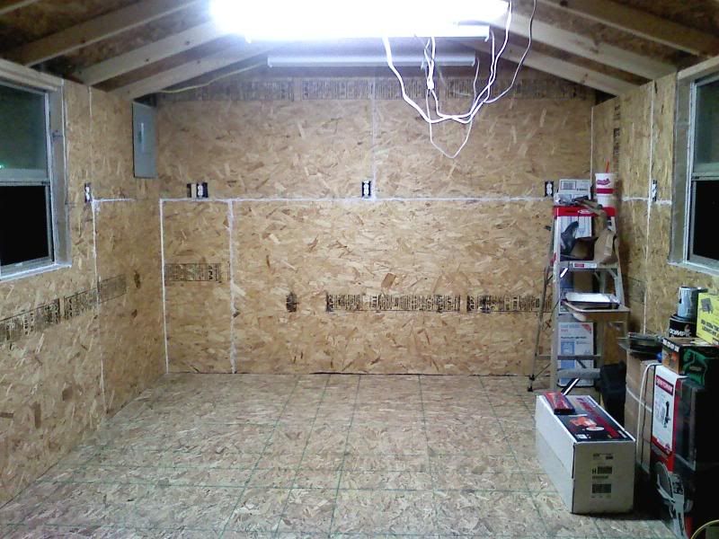

This is mine. 10x12 delivered and installed from Lowe's.
I cut and installed 2 storm windows for ventilation. Doubled the thickness of the floor with an extra layer of 3/4 OSB. Studded the walls on 24" centers and covered with 7/16" OSB. (4) 2 bulb 4' shoplights make it like daylight in there! I think I'm going to take one out or put it in a seperate area, it's way too bright hahaha.
BTW, doesn't look like that at the moment :( Had to fill it full of stuff from my mom's after she died. Going to get it cleaned out and benches built here soon so I can get to work. I would have liked bigger, but it was all I could afford at the time and will suffice for a while. I can always add on to it down the road.
We painted the inside of my new addition bright white-walls and ceiling, and added 4, 3 tube 4 ft. fluorescent fixtures (8 X 24 addition). It's bright! You need all the light you can get for attention to detail.
Painting the OSB also seals the formaldehyde fumes in.

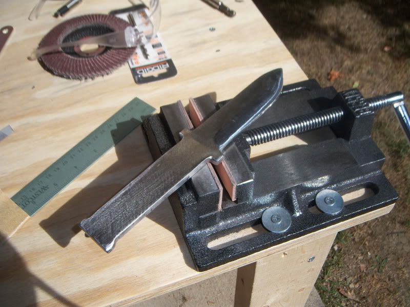

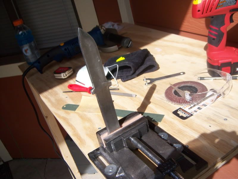

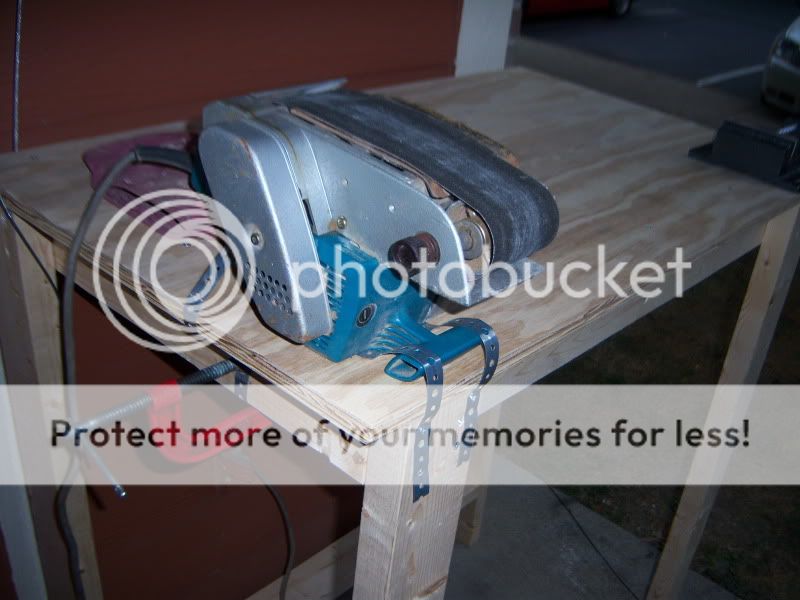

Hahaha, I was gonna say, you guys are spoiled! I like seeing SOMEONE is churning out quality work in a small area. I'm working on a front porch work bench, in an apartment complex, for the time being. Just started messing around with an angle grinder, files, and a floor sander at first. Moved up to a powerful little 1x42 grinder now, though. Old pics but you get the idea, haha.
Gotta start somewhere? hahaha
