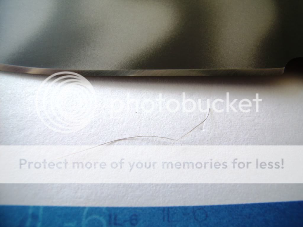

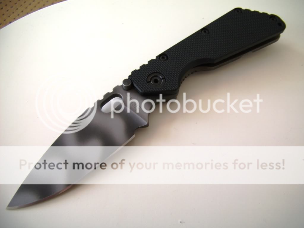

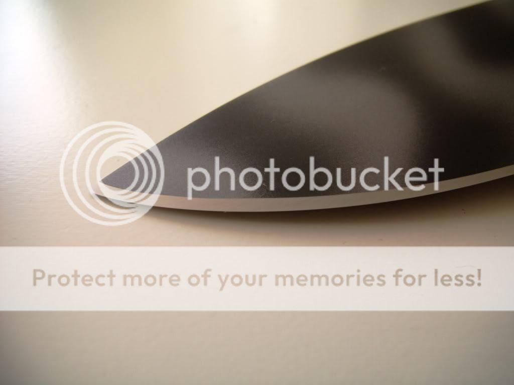

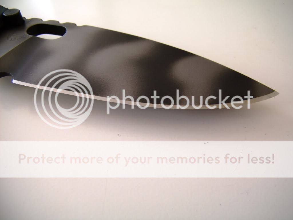

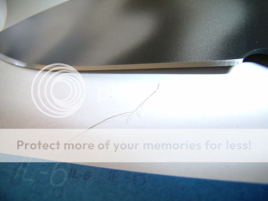

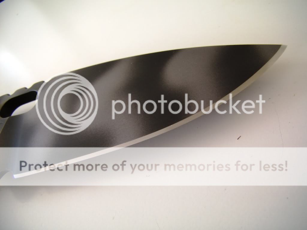

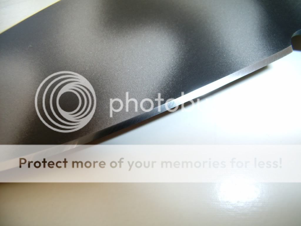

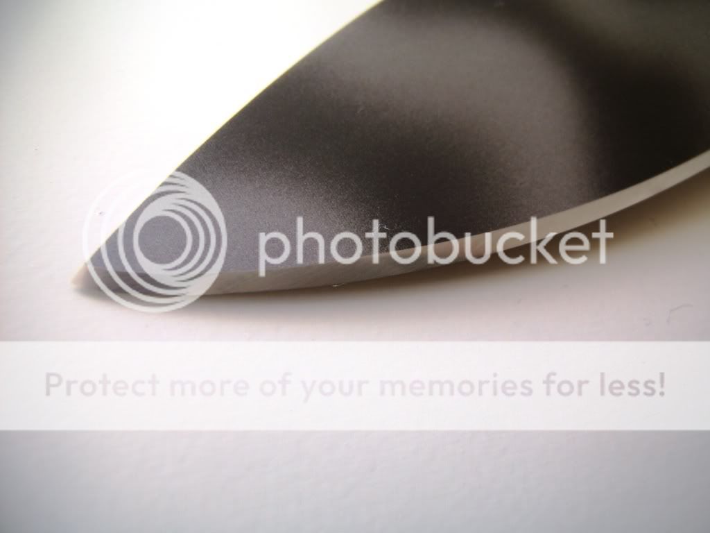

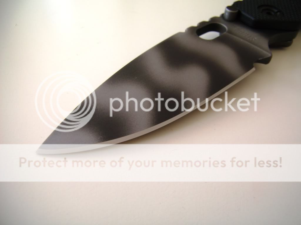

Yesterday evening i sharpened my Strider SMF for the first time on the Wicked Edge.
Straight from the Strider shop the S30V blade had a 45-50-ish edge that was also rather irregularly formed.
I've resharpened it now to an exact 40 degrees inclusive, using the diamondstones in gritsizes 100, 200, 400, and 600, after which i proceeded with SiC wet & dry paper in gritsizes 800, 1000, 1200, 1500, and 2000.
After this i kinda polished the edge using 2 pieces of cardboard impregnated with some no-name polish taped to the diamond stones, also using the Wicked Edge.
The fine scratches you see in the picture aren't visible with the naked eye, only with a jewelers loupe.
In real life the edge looks next to mirror polished.
The whittled hair i plucked from my leg, :D

Those are some amazing pictures.
I hope I can get that good someday.
I am not too worried yet since I have only had my WE less than 24 hours.
PS: How did you get the prefect edge around the curve?
I have only been 'practicing' on some of my cheaper knifes.
Do you reclamp for that portion or is it just being careful?
If possible i try to clamp each knife as close to the center of the blade as i can, and then it's just a matter of going through each step long enough.
I don't reclamp the blades.
Try to get the best from each grit and don't change grits too soon.
I use a jewellers loupe to check the progression.( i ain't crazy am i ? :D)
Take special care to stop the movement forward as soon as the point of the blade is on the center of the stone, then take the stone off of the blade.
This will make sure the point stays crisp.
Going though all the grits on each knife will take time, especially when you use taped-on SiC paper like i do.
The Wicked Edge system is nowhere near as fast as the Paper Wheels which i use also.
But when you're not in a hurry and want to reprofile & sharpen valuable blades which need to stay in a condition as if they weren't touched at all, the results of the Wicked Edge speak for themselves.
