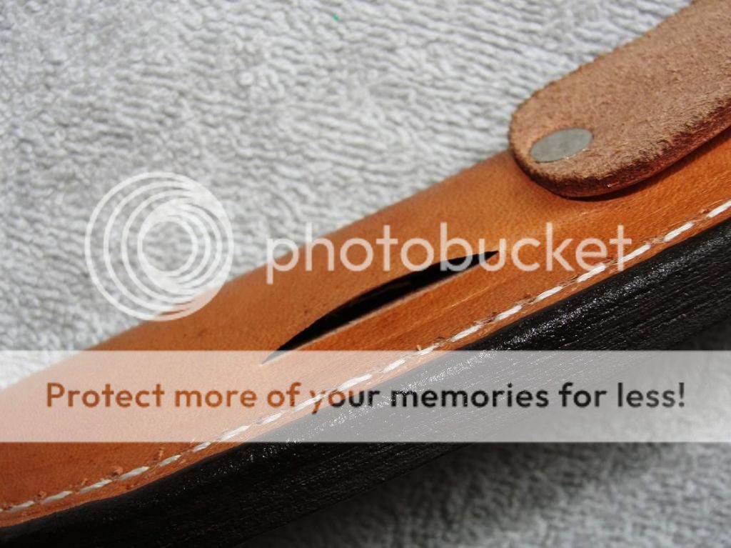

A replacement sheath is pretty cheap if I want one,....maybe $18-20, but I may just make a high ride sheath anyway for better concealment.

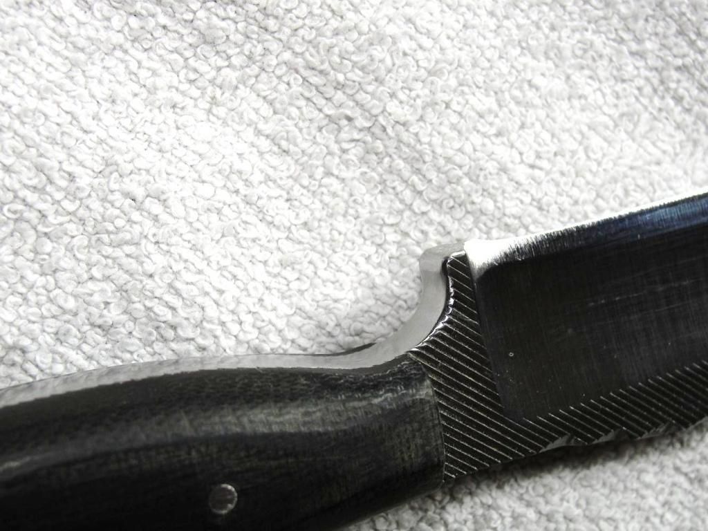

One other area this knife could use some improvement on, considering it's slicing abilities, is a more pronounced hilt or finger guard. I realize starting with a file as your medium does limit you in getting a built in hilt depth, but felt this could be improved upon also.
Here is the way the handle looked when I received it. Notice how easy it might be to slip up onto the blade, especially under wet conditions:
The plan was to reshape to a more 90% angle the "hilt" area, and also deepen the index finger access. Considering the 1/4" stock thickness, removing what I did means nothing in strength,.... but make me feel a bit safer using this.

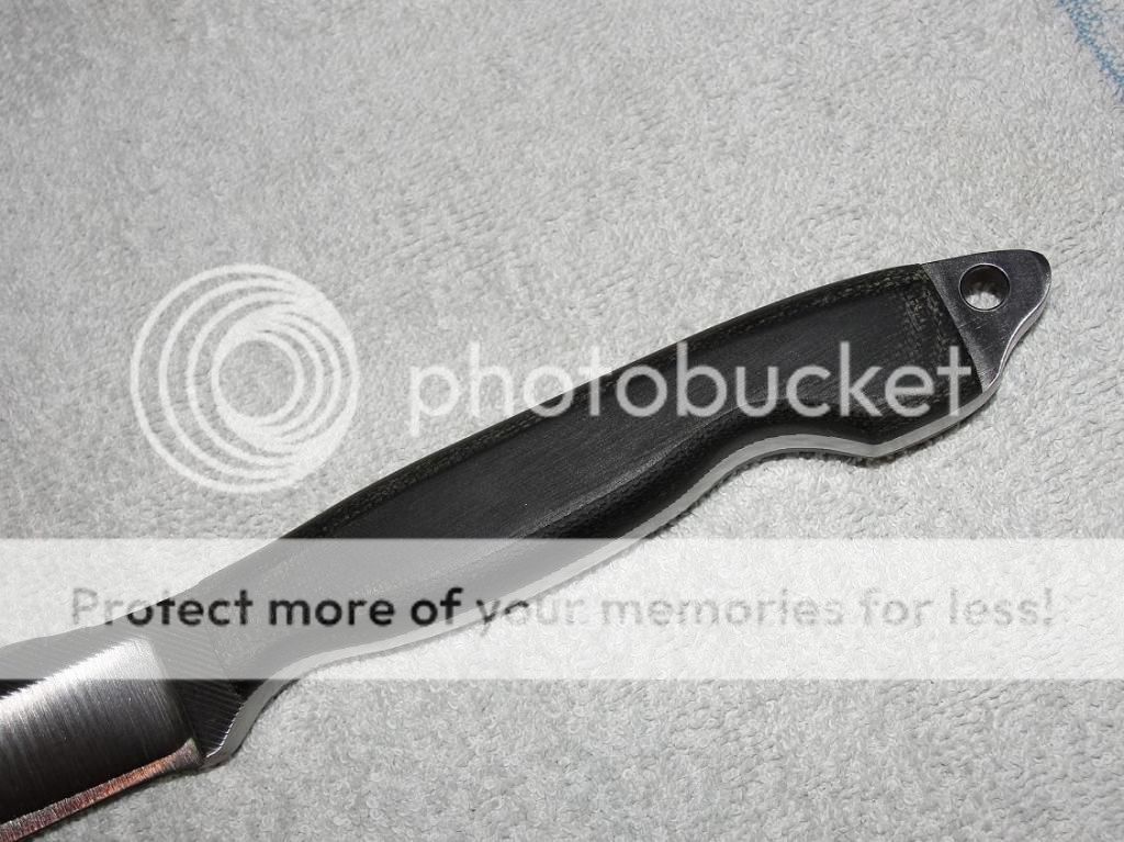

The new position on the thong hole, besides looking less "aggressive" as part of a skull crusher, (er, I mean glass breaking tool
, is also more esthetically pleasing to the eye and hand.
One added benefit is a lot of the handle-heavy feel with this knife is now gone. It balances a lot closer to the hilt, and if I wanted to taper a bit more of the back of handle to butt position to remove more weight, could probably get it balanced right at the hilt. It's plenty fine as is now, however.

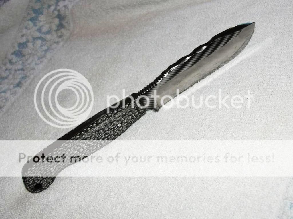

Now, I will say that i DID "Pin" this knife, but must state for the record I only got ONE functional pin in! The thong hole cut out without a problem, working in smaller drill sizes on up to finished size. The scale pin next to the thong hole also went in OK......
.......HOWEVER, using a sharp drill I cut the 2 remaining holes into the micarta, and stopped when I hit steel. When I went back to the middle hole to grill all the way thru,...NOTHING, NADA,.... LIKE GLASS!
I went thru my stock of drill bits and tried about 20 (I have hundreds as I buy them at a used tool shed locally), and no matter how well I sharpened the drills they all wouldn't even begin to go thru the steel at those points! :grumpy: (but they cut fine into the end piece of the skull crusher I cut off!) Possibly a carbide drill bit would have worked, but I didn't have one on hand in 3/32". (if they're even made that small?)
I can only surmise that either Anza Knives routinely anneals their files differently along the varying parts of the handle, or mine was an exception and the annealing process incomplete. Also, I suppose it's possible the blades are selectively re-hardened after shaping, with the skull crusher area made a bit softer for added "toughness"? In any case, the Rockwell hardness at the mid and front pin locations WAS equal or above drill bit hardness.
For cosmetic reasons, I drilled thru the micarta on the other side to match, and epoxied in non-functioning partial length pins to match the "look" of the single functioning pin near the thong hole. They were a bit fussy getting seated also, because the trapped air in the sealed hole kept wanting to push the pin OUT as it was pressed in place. Eventually the air pressure equalized and the pins stayed put, but I wrapped several times with electrical tape to be sure they stayed put.
If anyone else has noticed a hardness difference on Anza's depending on area of the handle , please let us know. I would have thought the overall annealing Anza does would have evened the hardness in the handle area,...but not in this case.
