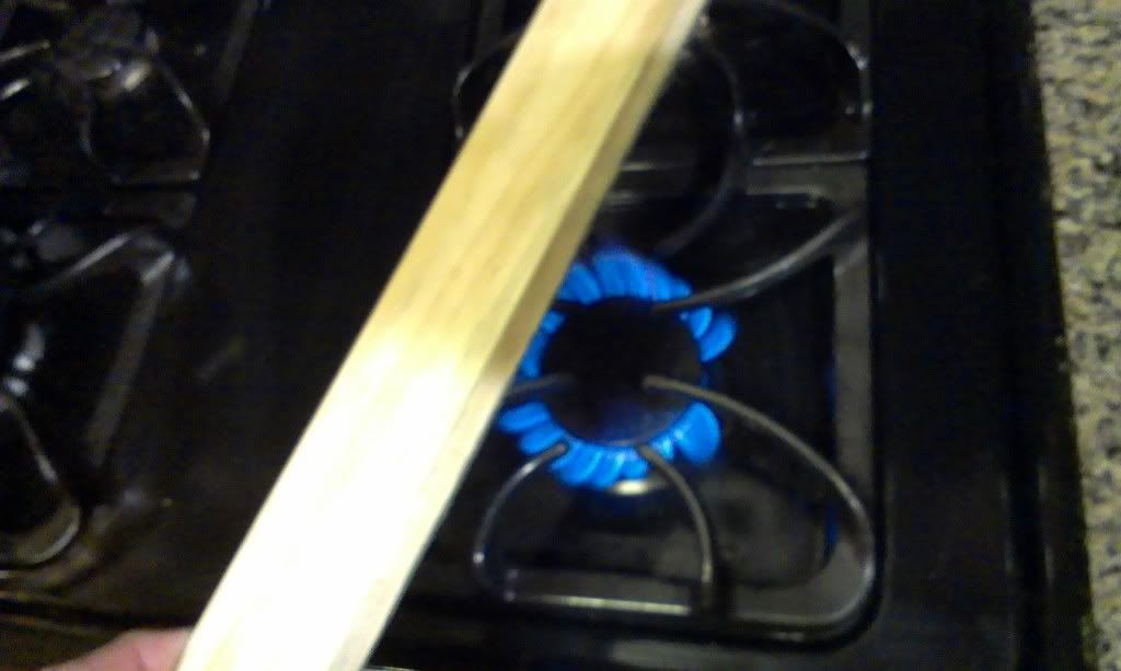

Hey guys I noticed that my strop would no longer shine the edge of a penny in certain places, so I decided to snap a few pics of my method for applying compound. It's the best method that I've found assuming you are using the right kind of compound.

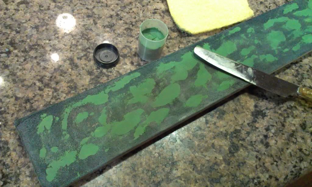

Here I put a decent amount over as much of the area of the strop as I feel like.

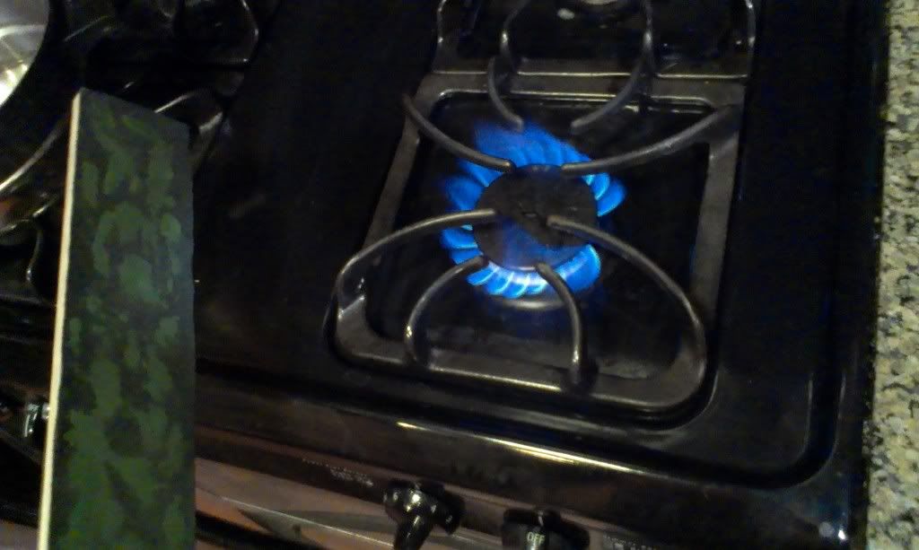

Set your flame to medium on your stove.
Don't get too close! You don't want to burn the nap of the leather. Wax based compound will melt very quickly... approx 2 seconds/4" from the flame.

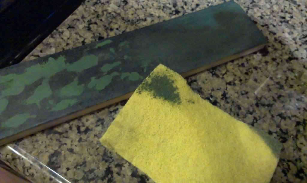

For a large strop like this I do it in 3-4 sections. Use a Scotch Bright pad to work the softened compound evenly about the strop.

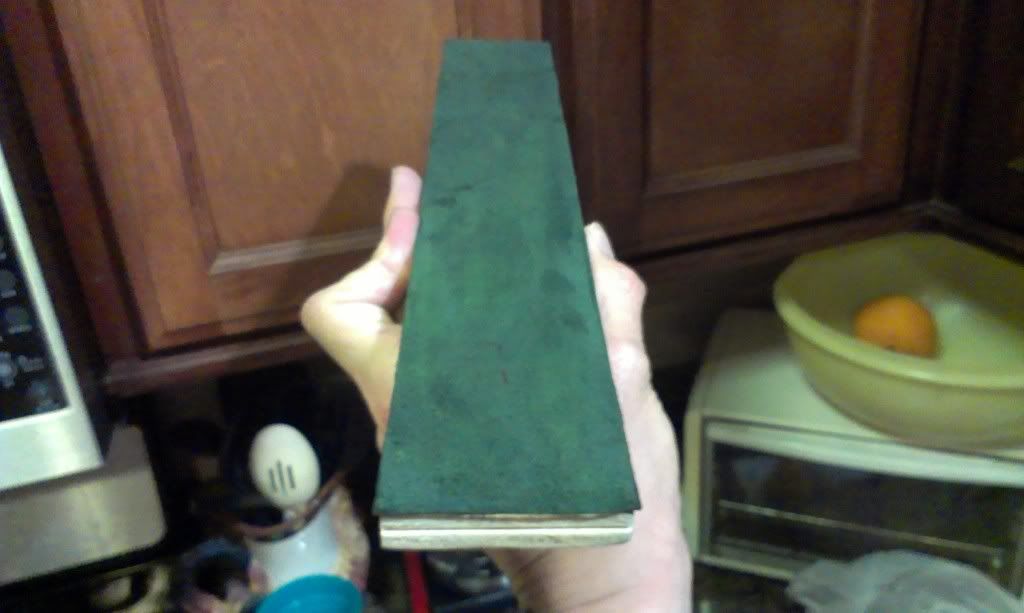

The whole job takes 5 minutes or less, and it works!

Hard to tell in the pic but this leather is very thin with a short velvety nap. For my purposes it's worked better than anything else I've ever tried.
