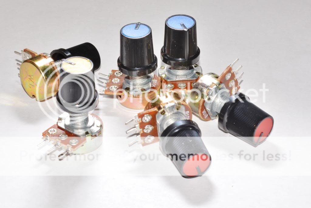

I tried to find this through the search and apologies if this is simple to some of you, but I'm having difficulty finding the right pot.
I ordered a teco fm50 and a 3 phase motor to replace my 3 speed single phase setup on my kmg.
I'm building my own enclosure based on what others have done on here to dust proof it.
I found some pots online and thought I was all set, but as I explained my setup to the ebay seller, he replied this pot would not work.
BOURNS 3500S-2-103 10K OHM 10-TURN 2W WIRE WOUND POTENTIOMETER NOS
From what i've read, i need a 10k linear taper, pot.
Can anyone recommend a model number?

I respond to your PM an told you that just about any 10k pot would work. Here's a link to some on eBay and radio shack
http://www.ebay.com/itm/6x-B10K-10K...ol-knob-USA-/251885909590?hash=item3aa591f656
http://www.radioshack.com/10k-ohm-linear-taper-potentiometer/2711715.html
A 10 turn pot, would probably be a bit too fine an adjustment for your purposes. I would try a 1 turn first.
The Manual for the FM50 shows a 3 pin pot as well.

A ten turn Pot would be roughly 6Hz per complete turn, do you need that kind of control on your speed?

1-turn or 10-turn is really just a matter of preference.
If you are used to one, the other feels wrong.
If you are not used to one or the other already, 10-turn is not a problem at all and I'd actually recommend it. In some ways, it's actually better than a single-turn: mainly because you can't usually turn it faster than the ramprate you've set for accel/decel and you therefore don't get overshoot on the adjustment. A 10-turn with turns-counting dial can also be nice if if you have built your VFD into a windowless box and can't read the speed off the display easily: the dial gives very good repeatability on settings.
Once you've used a single-turn though, a 10-turn is just annoying.
I have found that it seems to be much easier to find good 10-turn pots than good single-turn pots for sensible money on ebay, at least over here.
When I have the budget or can get them free, I use AutomationDirect ECX-2300-5K or ECX-2300-10K, single-turn 22mm industrial panel-mount potentiometers. They are very good indeed. They match Telemecanique CB2 22mm industrial switches and they have screw terminals.

Otherwise, I've tended to use Bourns 3540 10-turn precision wirewound in linear taper and whatever value I can get that looks like it will work. I've had 10kOhm and 2.2kOhm that I can remember, bought on ebay. A bit more hassle to fit than the AD ones and they have solder terminals.

I tend to stay away from the cheap pots with Carbon tracks. I've had one or 2 which have gone "jumpy" in the past at the setting where they see most wear on the track. It's usually a real PITA to change a soldered pot so I try to avoid having to do it.
