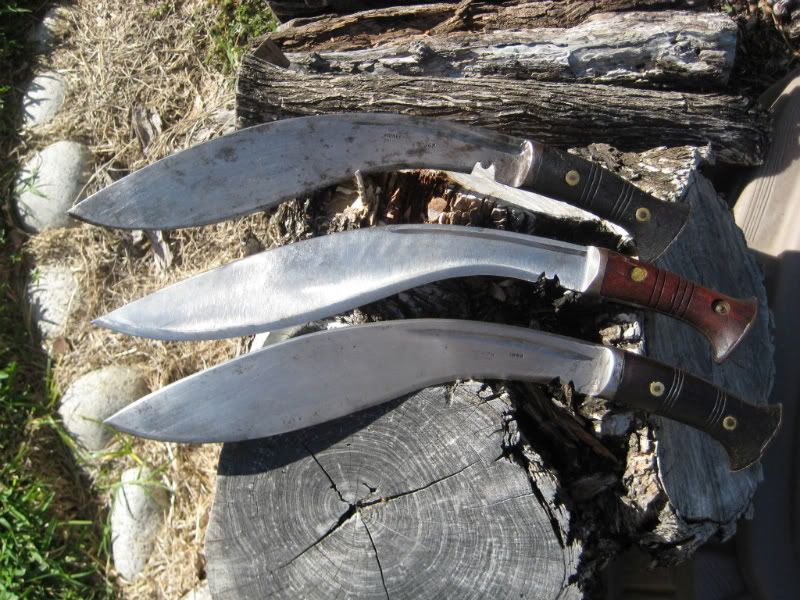

And here is the historic M43 (middle, standard issue Mk. II on top and bottom) of which Bill speaks (and longs for a modern re-creation of:).
