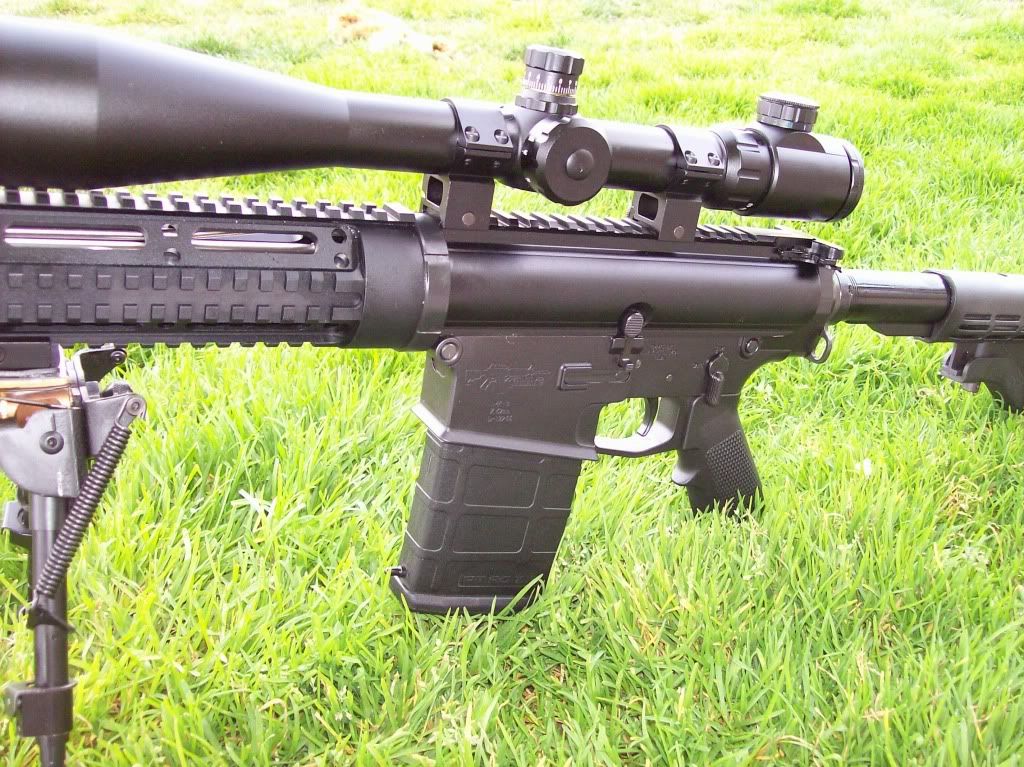

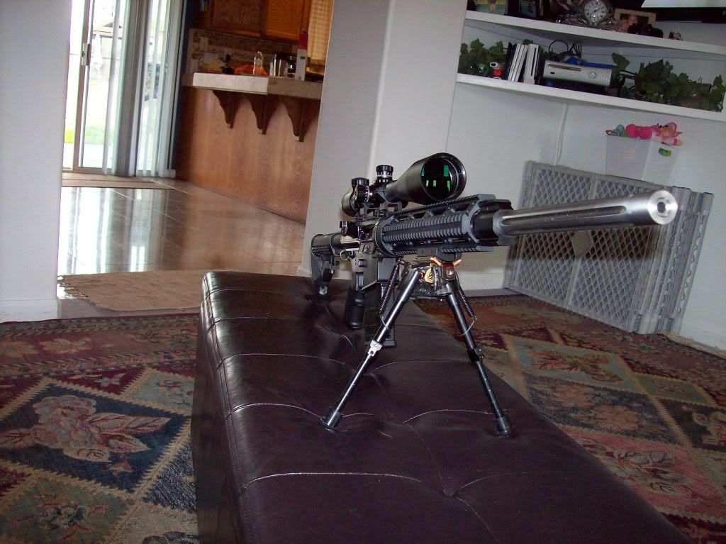

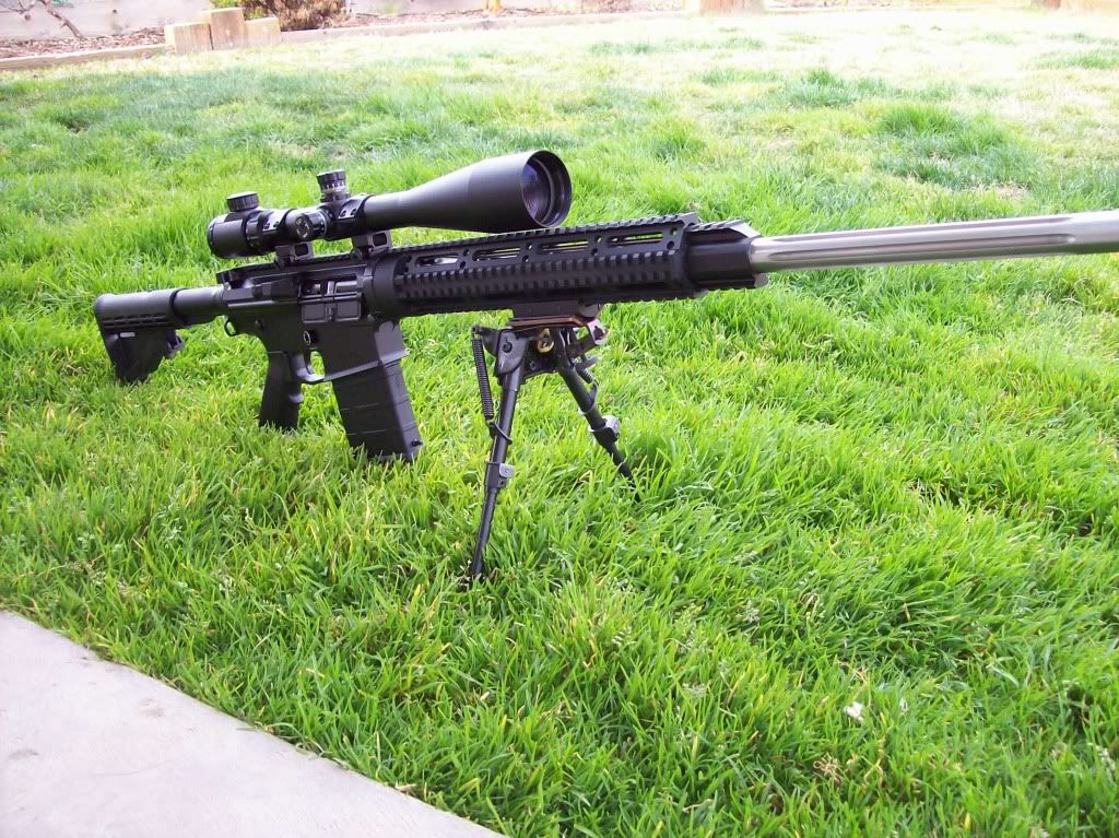

when building the 308 you need to make sure you get either dpms compatible or armelite compatible. i built mine dpms compatible i used a cmmg lower (mk-3) and all dpms upper parts. the 308 is easyer to build in stead of pounding the roll pins in there threaded so just add lock tight. some parts are interchangeable i have a ar15 buttstock with the proper spring and buffer for 308, im waiting to buy a magpul prs buttstock
