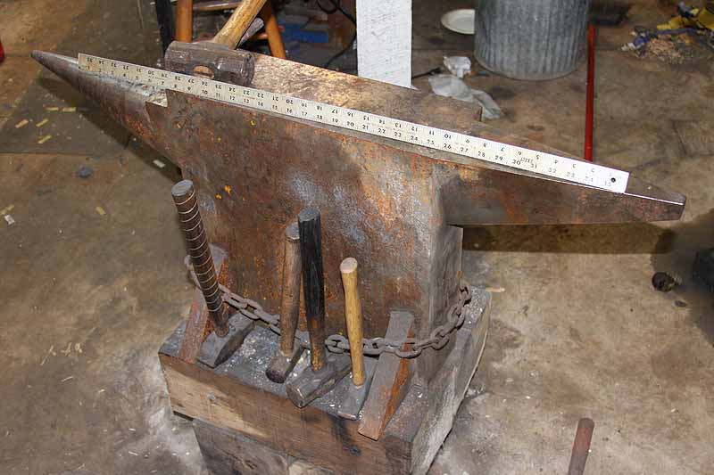

I bought a near-century old 148 pound Hay Budden off of ebay after watching for quite a while and finding a "buy-it-now" anvil at a good price. It was from a tool re-seller who picked it up in an estate sale, and I jumped on it. The auctions can get higher than I want to pay at times. It's pricey to ship, but still came out at a decent price. Expect to pay around $2-4 a pound for a good used anvil. New anvils can run $7-8 or more a pound. My anvil came out to $2.61 a pound shipped.
Look for at least some areas of clean edge without too much chipping, though that can be worked around with top tool. Avoid an anvil to too much sway, though some sway is expected in quality older wrought iron anvil. An anvil of around 100+ pounds is great for steady blade smithing, though you may be able to get by with a 75 pounder for hobby work if you mount it well.

I recently bought almost the same anvil on ebay (144# Hay Budden). When I got mine it was the first time that I had ever noticed the square hole in the throat of an anvil and I see that yours has the same. Maybe it was just too inconspicuous of a location to notice. Anyone ever heard what the reason is for it?
BTW: Mine was a little over $3 delivered.

I believe those are handling holes used during manufacture.
