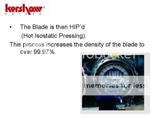

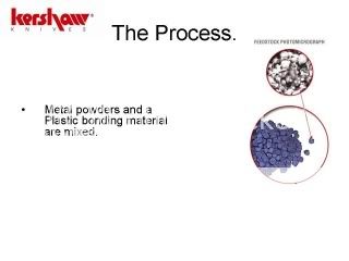

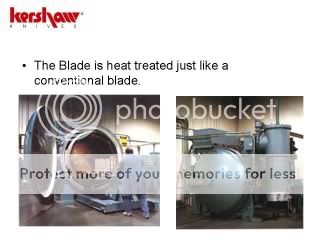

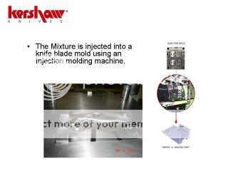

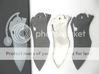

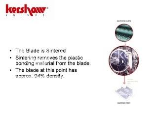

Back on topic! I have some info from the 2007 Kershaw catalog:
Complex Blade Geometry and New “Double
Pumper” Opening Technology
The Offset’s rugged and complex blade
geometry is provided through state-of-theart
Metal Injection Molding (MIM) and hot
isostatic pressing. The result is a precision
blade with two bevel geometries, hollow and
flat, for incredible cutting power. This
process produces a premium 440C-PM
stainless-steel blade with complex, true 3-D
geometry. The Offset also features the latest
SpeedSafe configuration. It’s our “Double
Pumper” design and it features two torsion
bars to ensure easy assisted-opening for
folding knives with larger blades—such as the
Offset. The Offset comes with a 3D machined
G-10 handle.
More info on the MIM process:
