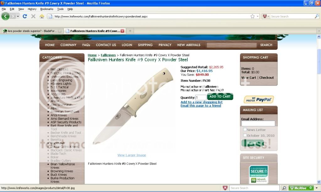

Are powder steels superior?
Apparently :eek::eek:
