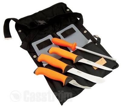

I find them very easy to sharpen. How do others find these to sharpen, this shape of blade and others similar I find hard to sharpen as I can't get the concave part to contact the stone.
Middle knife.

Recurves are tricky. I don't freehand sharpen, but I know that if you twist the blade into the corner of the stone, you can contact the edge within the recurve. Hope this helps!

Get a lanky diamond rod for actual sharpening/damage repair and a ceramic rod for quicker touch-ups.
The round shape lends well to getting into the recurve shape.
Worth keeping in mind is that the small contact area means less pressure needed or suggested.
