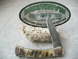

My opinions are a little different than I have read here. The damascus blades you see from Grand Leavitt on the bay are top quality and will directly fit with no modifications needed. If there was an issue with fit, he would correct it. He makes blades for me and Leroy among many others. No problems with his blades!
Eric
Thanks Eric. I Love that Ramhorn Damascus drop point in your sig pic! Hearing this info from you eases my worries alot. I still want to give this a try. If it's just a matter of center punching the pivot pin out and re-installing the blade, I would be fine with it. I just want a nothing fancy 110 with damascus for a heavy duty user. I have been searching for tutorials , But no luck yet. Thanks for all the opinions and insight everyone. I'm also going to try calling the custom shop and check on a stainless damascus 110. Maybe with Walnut if it's avalable.
