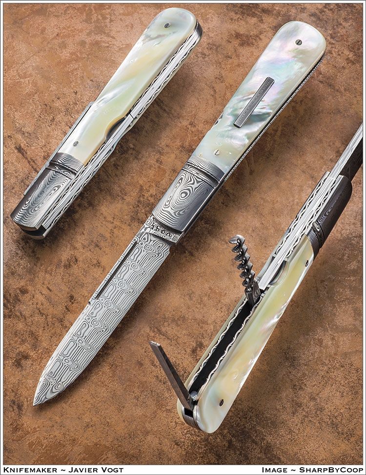

It's been a while since the last time... I accept the fact that I'm a lazy bastard about showing my work!!! :D
This is a folder Coop already showed, but here are the specs and a couple videos
Hope you like it!
Measures: Blade length:100 mm / 4”
Closed: 123 mm / 5”
Blade:Damasteel, ladder pattern.
Bolsters, lock, corkscrew, lid and spring:Damasteel, vinland pattern.
Liners: Fileworked and anodized 6al4v titanium. Jeweled inside.
Scales:White mother of pearl. Damasteel shield. Timed screws.

Great job my friend!!
it is good to see you here :thumbup:
Forget the image. ;)
I LOVE the 'POP' at :33" on vid #2. PERFECT!!!
A wonderful knife.
Good thread.
Coop
this might be one of the prettiest knives I've ever seen. Slipjoints are cool, and I like them, but never like this!
Love ito. The combo of the lockingredients main, and hidden cork screw is just so neat!
Thank you all!
Hey Lorien, I'm glad youlike slipjoints... but this is a back lock!!! LOL
Thanks again!
should I have said, 'traditional folder'? Probably, it would make me look slightly less of a dumbass :)
kind of ironic, my error, given that one of the coolest features of this knife has everything to do with its locking mechanism :rolleyes:
one of the best knives i have ever seen!! I love it!!!!!!!
I scratch my head wondering what's the trick used for the pivot/bolster.
