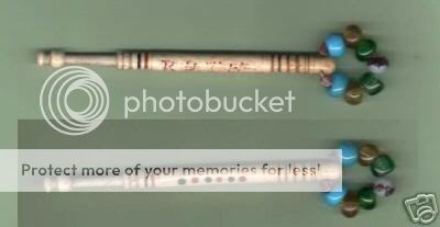

This is what I'm shooting for, a slight brown/amber tint. You can see why I figured tannins would work. Is there a dye formulation that's specific to (or best for) bone ? Leather or fabric dye ? Thinned ink or wood stain maybe ? I will make sure to get some extra to play with at any rate.
