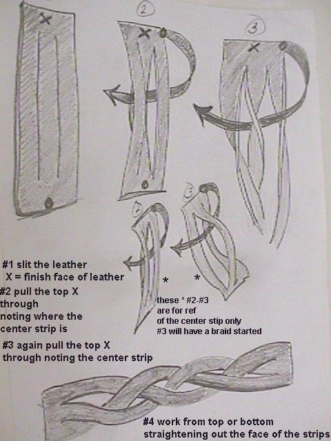

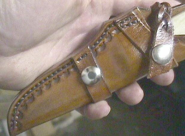

as promised, better late than never guys ,, Braided keeper strap
Jun 25, 2001
8,474
about time yea :)
how I braid the keeper strap on my Model#A sheath in the picture below.
Cool, just saw this post and after looking at your sheath it was bugging me "how'd he do that!?" Thanks for sharing
Anything to drive us simple guys bonkers huh Dan? :D I had a girlfriend once who was quite a horsewoman and she did this with a lot of her leatherwork, and did a few lanyards and stuff for me too. But now I guess I can learn to do it for myself... Thanks for the great drawing!
:) I can't believe I drew that ;) I don't draw well. after about four or five times it's what I got..anyone having trouble Braiding it?
