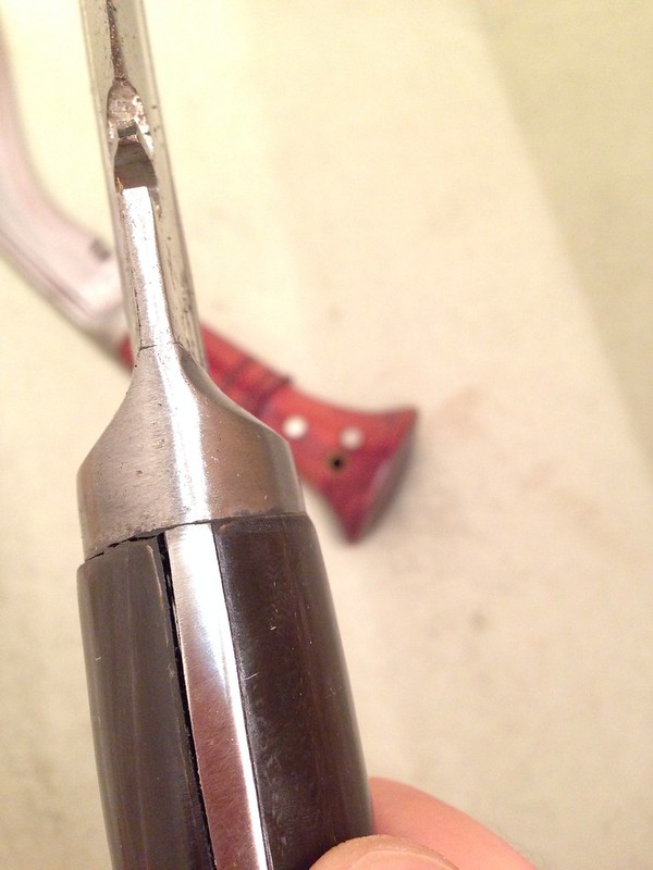

I'm 110% happy and I don't mind fixing things. Actually I like fixing stuff. So here is my current challenge.
One of the horn slabs is bending upwards towards the bolster/guard. At that spot there is 1mm space between the horn and the full tang. I can look all the way through. My plan is to cover the gap from one side with tape and then fill the gap with g-flex epoxy.
My question is should I press the horn down while the epoxy dries? Could that crack the horn since it wants to bend up and the epoxy will hold it down? Basically should I use epoxy as a filler or as a glue?
After epoxying could soaking in mineral oil effect the bond in a bad way? Don't want to use oil before the epoxy since it wouldn't bond we'll.
Also I can't really roughen the surfaces since the gap is only 1mm. Should I at least flush the gap with alcohol to remove any preexisting oil or grease or can alc harm the horn?

Just my personal opinion here so take it accordingly. I would not try to pull the horn back down, I don't think it would happen anyhow, epoxy just isn't strong enough to do that. I'd just fill the gap. Even though you can't rough it up effectively the epoxy should still create a mechanical lock, it's not just gonna slide out unless the gap is perfectly parallel all the way thru.
To me strength isn't the issue, just cosmetics so just about anything that you can match semi closely color wise would work. Something even a bit flexible would be good. Either silver to match the tang and blend or dark to match the horn.
I would worry more about alcohol interacting with any exposed laha inside the gap. Unless you have a way to test that, I wouldn't try it.
Generally i would fill a gap with a slow-setting thick epoxy and peel off the tape when the epoxy is set enough to stay in place, but before it completely sets and grabs hold of the tape. If the horn is sticking up too much you can sand or file it down later, after the epoxy is fully cured. You can also sand off the tape if the epoxy does grab hold of it, but less work if you peel off the tape in time.
I wouldn't use oil beforehand, for the reason you state. Even afterward, it might be better to rub on some Hooflex (the paste kind, rather than liquid, is less messy), rather than mineral oil. However, once the epoxy is cured, either way should be ok.

I have and would still just fill it.IMO the horn has been on a long and UP and DOWN temperature extreme journey. Although if you really want soak it in hot water until the horn gets a little flexy, then clamp it and let it dry and you might only have a .10mm space instead of a 1mm. YMMV

Hello Jens-I fill gaps with slow set JB weld epoxy. I would not try to clamp or press the horn into place, but rather force as much epoxy into the gap as possible and allow to set then carefully sand and if necessary, fill again until flush. JB weld is virtually impervious to oils, etc.
Awesome guys. Thank you for your help. I am tempted to soak it in warm water until it's flexible but am worried that some might stay in there and cause rust later on.
So probably will just fill it and add some black ink to the epoxy.
Wouldn't even file it since excess width in the front doesn't impact the Kukris function at all.
Removing the tape before the epoxy is fully hardened will save me some time. Thank you!

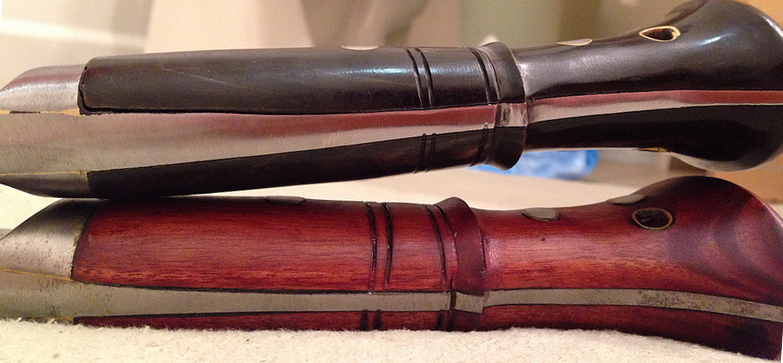

I noticed the new ASTKs front pin isn't as much in front as on the wooden handle. That might be the reason it could warp up. Still better than a crack in my opinion.
Here are a few pics of my 2 ASTK and the gap.
Also notice the difference in the tang. Interestingly the smaller ASTK tang starts much larger and then tapers down more.
Man... Thats a beast! I'd glue it and hose clamp it and if it dont work then id fill it. Mainly because you cant do the reverse order. Just my opinion tho. Eventually the stress will be relieved as the oils penetrates deep into the horn.
That gap is on a much longer area than I thought. Being the thin part of the horn it just might pull back in. Epoxy and a clamp might do it or even epoxy, clamp and put in another pin. Might hold.
I'm not on board with the soaking it in the water idea, seems like it would take a long time for that horn to get flexible enough.
Agreed! The steel would rust before anything else would happen. Id leave the clamps on for a week or so if you can stand it while everything sets up and relaxes. Only problem with that is it would be hard to look at your baby in recovery that long:grumpy:
I agree with Bawanna-if you're comfortable putting another pin in it there's room, and if you peen it (gently) it'll hold it down, especially with the epoxy. The epoxy syringes with the mixing tube/nozzle are excellent for getting it into cracks and small spaces.
