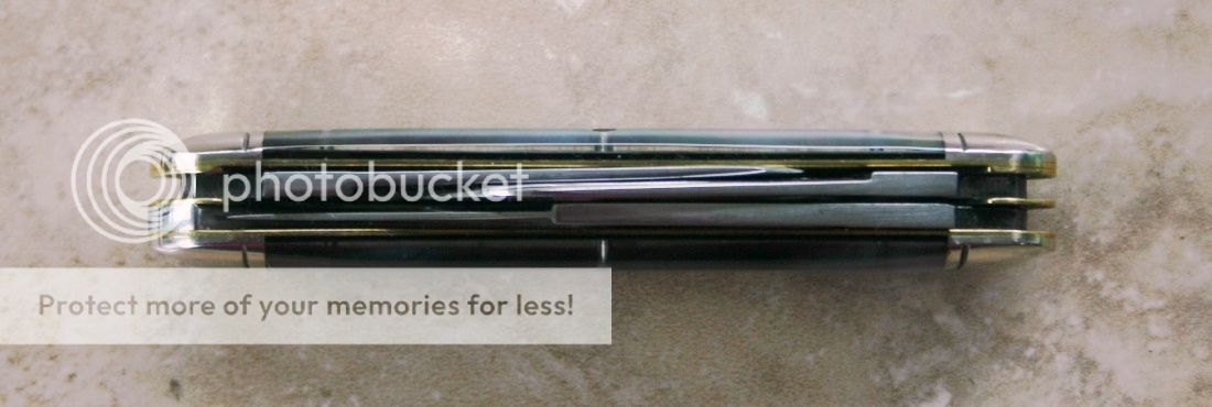

This idea is hard to describe - maybe the attached photo helps. these are two recent production Case stockman pattern knives - top is a 6318 and the bottom is a TB6339.
Note that the 6318 has thinner blade stock than the 39, but the 18 also has a thicker center liner and yet there is a very noticeable bend o the sheepfoot blade due to crinking.
The 39 pattern, with thicker blade stock, has a thinner center liner yet there is no noticeable bend in the sheepfoot blade. However it does appear that the sheepfoot and spay blades are slightly offset ground.
It would seem that if I am right about this (and how else to explain the differences in the two knives?) then the use of asymmetrical grinding would seem to be the most elegant and simplest method to solve the blade fall problem the knife can have thick blade stock while maintaining an overall narrower blade cavity and therefore slimmer in the pocket.
I have collected and studied traditional pocket knives for over 40 years, and all of the older stockman patterns that I have seen and owned (pre 1970) have had the thicker blade stock, thinner center liner, yet with perfect blade fall and while the blades may have been crinked, there was never any noticeable bend in any blade. This applies to older Case, Remington, New York Knife, Winchester, really all of the quality brands.
Im just throwing this out here to see if others are more knowledgeable than I am about asymmetrical grinding and why it is not more widely used. If Im correct, I wonder why Case for example would use it on the 39 pattern but not on the 18.
And perhaps people can report in on their GEC and Canal street stock knives as to the level of visible blade crinks and the use of side liners and asymmetrical grinds.
