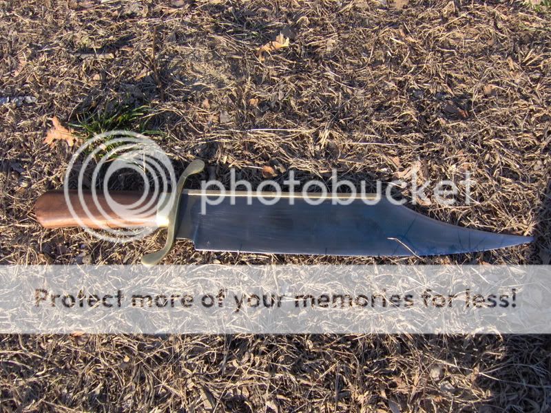

I purchased the Atlanta Cutlery Primitive Bowie, and I am very happy with it for what it is. I was watching The Alamo again the other night, and I noticed that the Bowie knife used in the movie had a dull gray blade color rather than the high polish that mine has. I was wondering if there is a way to dull down the polish on my blade to make it look more "primitive." I thought about steel wool, crocus cloth, valve grinding compound or sandpaper. I don't think the blade is stainless steel, so dulling it down shouldn't be too difficult. I don't want to disassemble the knife. Any suggestions? Thanks, DougT.

The bowie you bought from AC is made by Windlass. It is high carbon steel and will take a razor edge. To give it a patina, use a good cold blue. Rinse it off as soon as it is as dark as you want it. Dry it and use a Miracle cloth on it. It will go from blue to gray. WD 40 and 0000 steel wool works for this as well. I did this on a dagger from Windlass. I also have a Primitive Bowie. It is a copy of the Musso Bowie which some believe to be an original knife of Jim Bowie. It isn't junk. It's a very good reproduction of an early big bowie knife.

I did exactly that and it came out exactly how I wanted! I will post up pics in a while. Thanks Victor!

I'm very pleased with the patina I got. I really think it came out great.
and heres my Gen 2 Iron Mistress by the way :D
Nice, Colonel Bowie, very nice. I got one of those Gerneration 2 Iron Mistress Bowies, too. I wanted their Musso Bowie, but was too late. The Windlass version is actually closer in size to the real Musso anyway.
