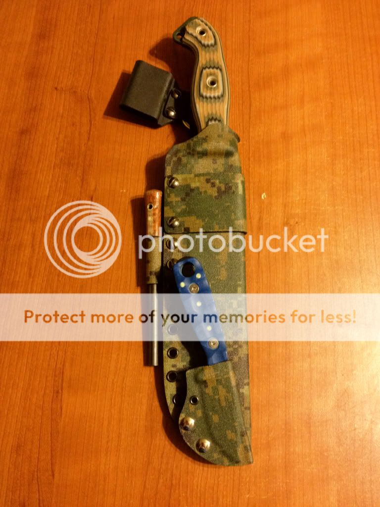

I bought a kydex sheath for a large knife of the foldover taco variety. It came with a piece that wraps around and on that are holes for mounting.

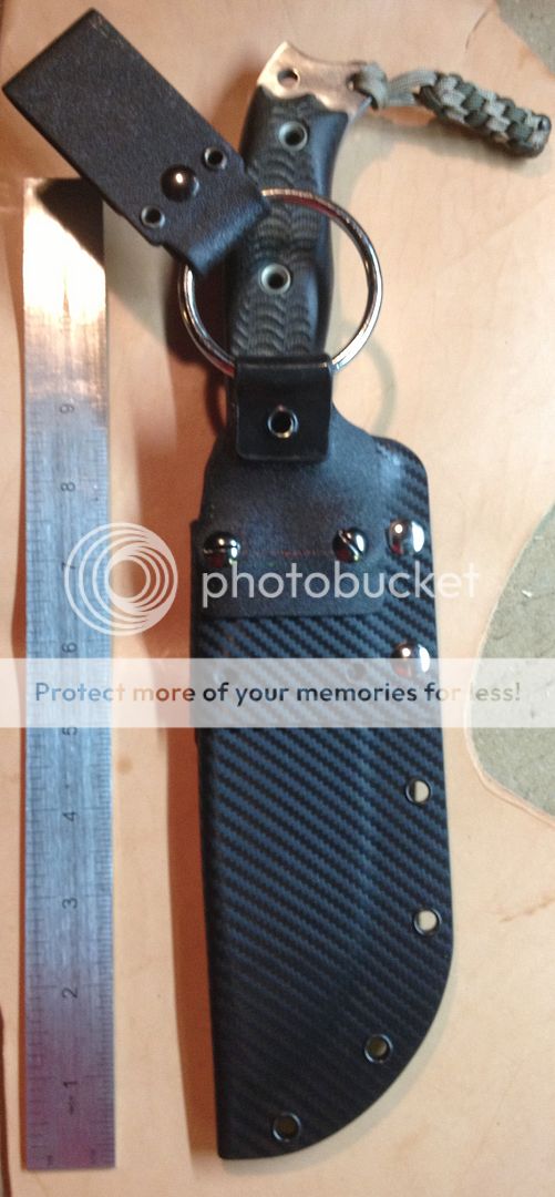

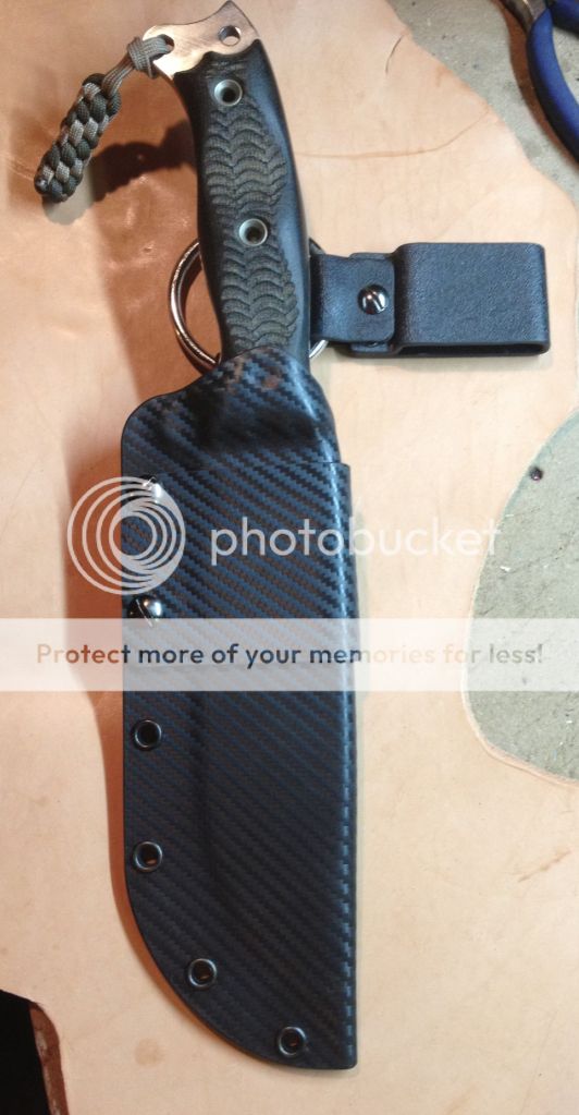

When I make taco sheaths I wrap a kydex band around the sheat to mount my tec locs too.
The drop loop comes off and the tec loc mounts in there instead using all four holes to securely hold the tecloc
Yeah that's basically the same as what mine has. I like the dangler incorporation, I might have to try that sometime.
dtrap,
Are those home made or are you a knife/sheath maker?
I dont make knives but I do make custom sheaths and holsters. I have been pushing plastic for around 5 years now. I do a ton of pistol holsters but my passion is knife sheaths. I also do some custom handle work as well. I did the handles on the izula 2 in the picture. They are g10 with glow inserts.
