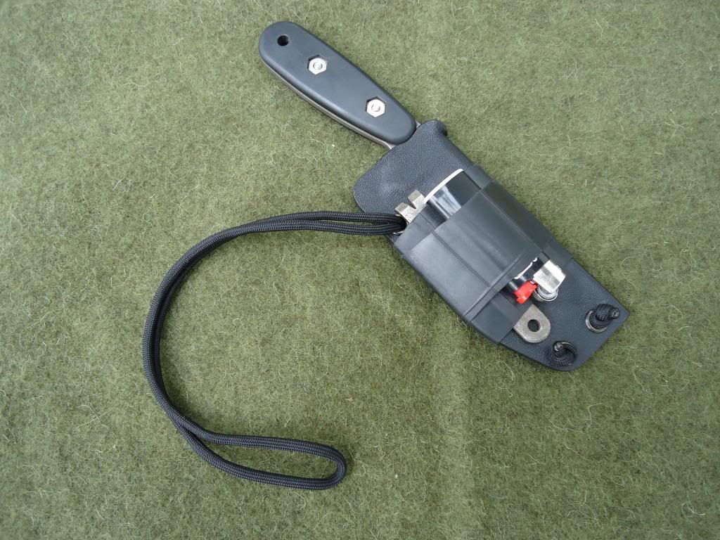

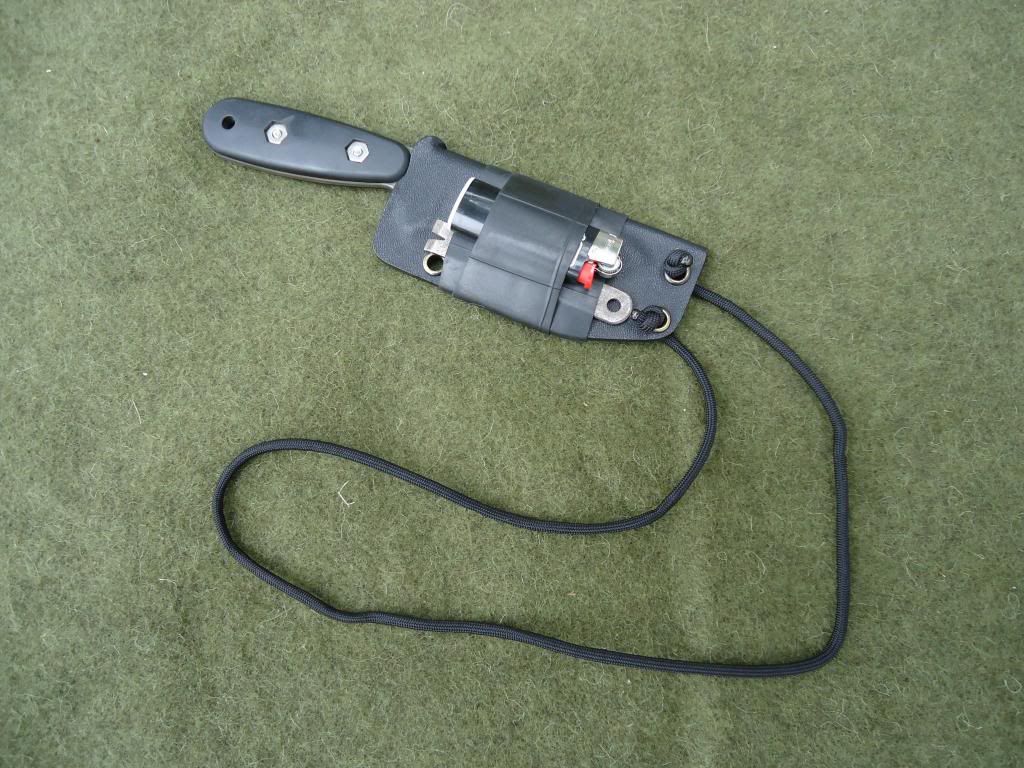

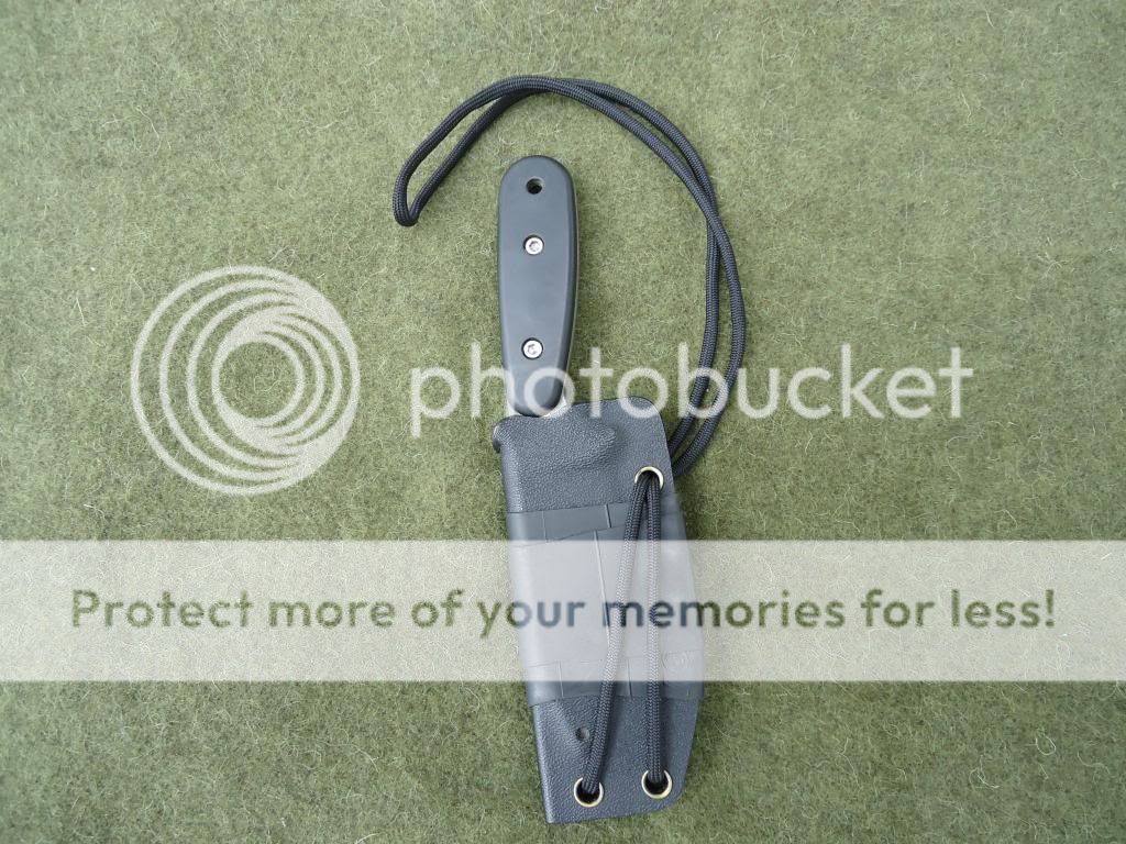

This method allows a 14/11 sheath to be quickly converted between neck carry and tethered pocket carry.
Pass the ends through the bottom eyelets and tie some type of stopper knot at the ends.
To change to pocket carry, fold together the middle of the paracord and pass it through the top eyelet.

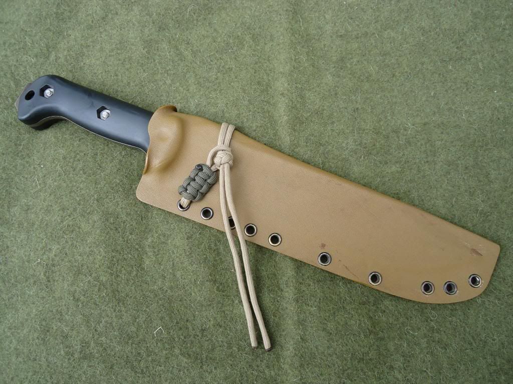

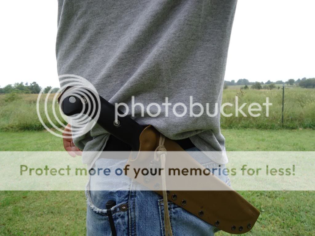

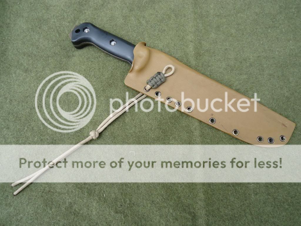

The second method attaches a fold-over style BK-9 sheath to your belt in the crossdraw position.
Pass a doubled length of paracord through the top eyelet. Tie the ends with a lanyard knot leaving tails which will aid in pulling the cord through your belt.
Make a loop sized to accept the knot. I used a short run of cobra stitch for this.
Run the knot under your belt and fasten it through the loop. This holds the BK-9 in a perfect crossdraw angle.

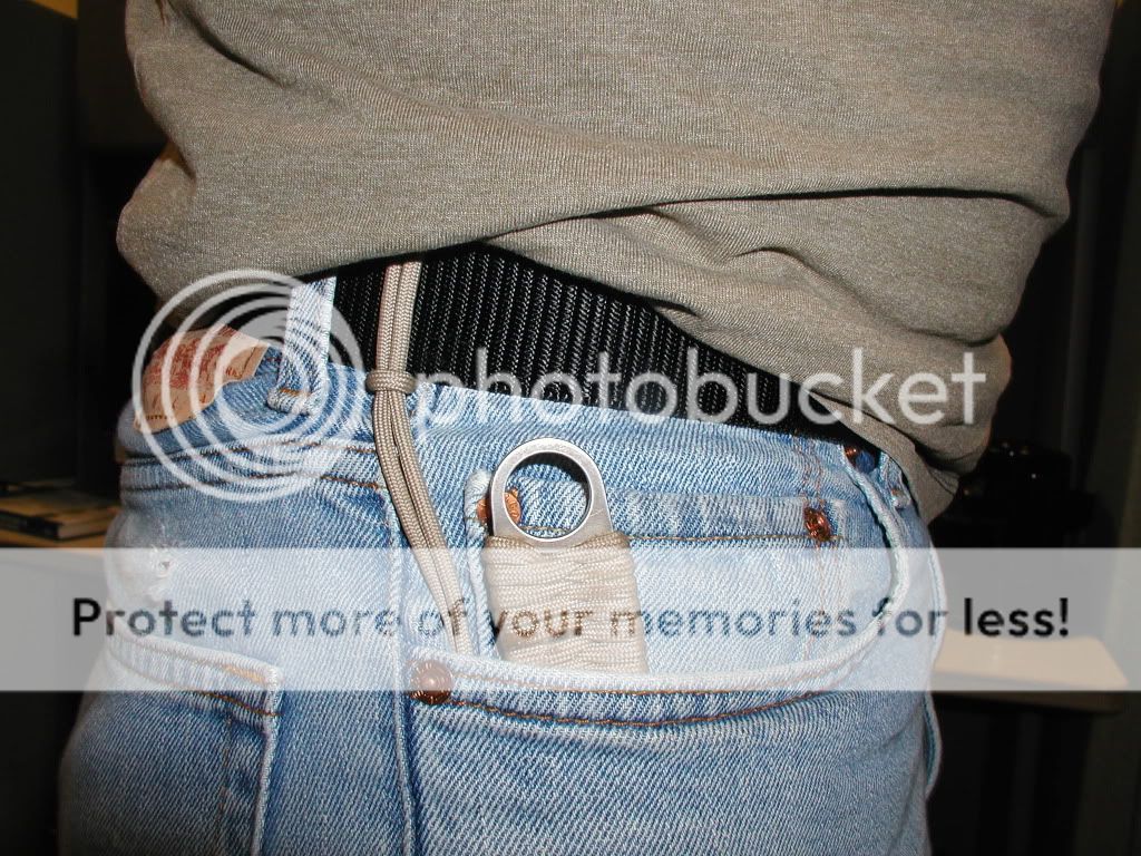

Moose seemed to like it.
Derek also tried it with a DPX Heft 4.
Moose feeakin' loved it. Moved when I moved and adapted to a sitting position rather well
The one I am using is the lanyard that kept on the sheath any ways, so, the attachmnet method does double duty.

So way back when Jordan came up with these ideas at a gathering, and it took off. Now at that time my BK9 had been absconded with (*cough*Pointy*cough*) but it was in a good home and I hadn't really had much interest in carrying it anyways, so I never had a chance to apply this idea to a big knife. After recently completing my sheath for my new BK9, I have to say, it has rode the belt here in the office mighty comfortably. Not any issues at all with any of the office furniture which I have sat in. Again, fantastic ideas Jordan!
Oh yea... This works real well. I'm packing my BK10 around this way as well. It works for cross draw as well as in a pseudo scout carry position.

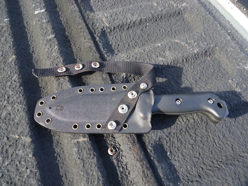

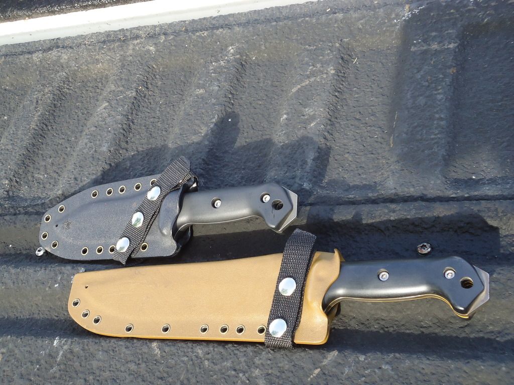

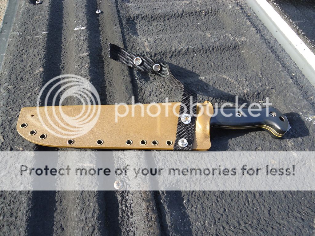

The next evolution of this concept has arrived.
Scrap nylon strapping plus some snaps.
Works the same as the parachute cord, but I've been carrying in the scout position, and this is a little easier to fasten behind the back.
