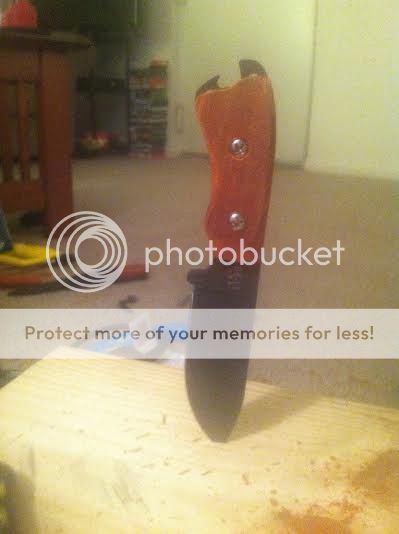

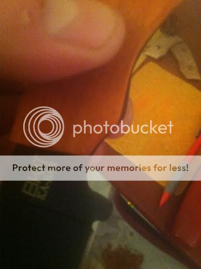

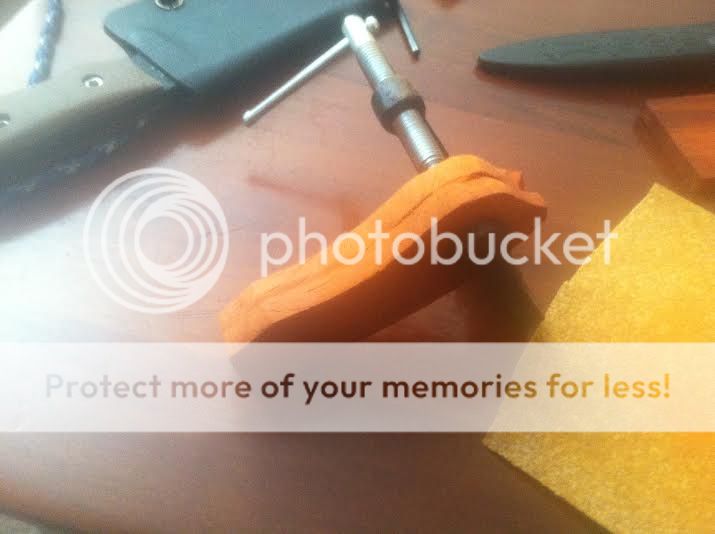

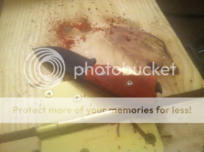

I did most of one side. I'm going to pick up a rat tail file and normal file at work and try to file out the rear a little bit for the bottle opener. Then I'll do the other side, and then I'll sand both a little bit more. I took a little bit too much off of this side on the bottom, but it's not very noticeable. Sorry about the picture quality.
To get to where I am now I used a BK11, a mora classic, and 60 grit sandpaper.
It looks like your onto a good start.

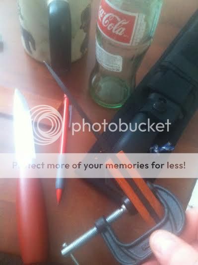

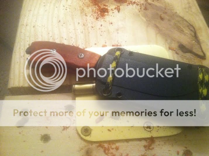

Did more work on these today. I did the other side and then evened them up a bit, made the liners (which I forgot to take pictures of) out of kydex and glued them on, then drilled the holes and countersunk them. Now that they're mounted on the knife I'll be able to shape them and round off the corners and stuff. But they're 90% of the way there, wasn't sure I could pull it off. They aren't perfect but they're mine and it's given me the confidence to try again.
I'm not sure what I'll put on them, maybe mineral oil? Linseed oil? Beeswax? What sort of finish should go on here?
Thanks!
They should look a good bit nicer once I've gotten them all sanded evenly and everything. They feel fantastic, though, being 1/4" on each side with not much taper. Really fills my hand.
