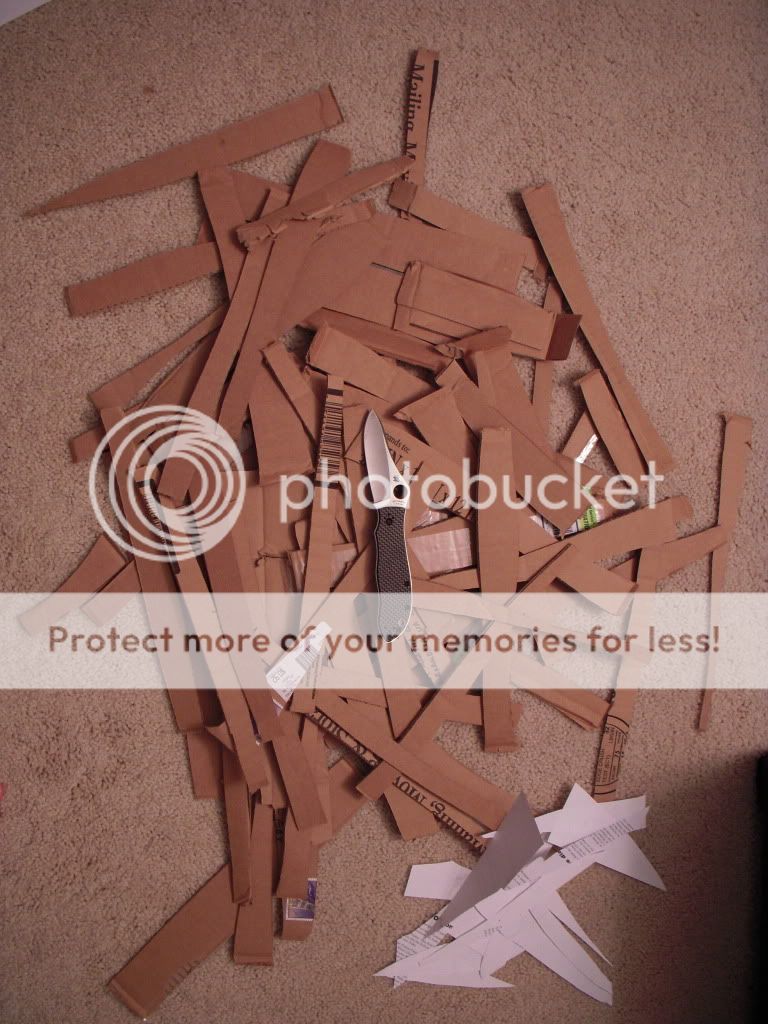

I did some cutting tests today with my American lawman and gayle Bradley. The lawman is edge pro'd to 36 degrees inclusive, and the GB is EP'd at 42 inclusive.
Now here's the kicker - when cutting the exact same cardboard the exact same way the edge on the gayle Bradley rolls and deforms while the American lawman's edge doesn't change much at all. The edge on the gayle Bradley looked terrible and after ~30 cuts it was noticeably duller than the lawman.
What gives? I thought M4 was supposed to have great edge retention, so why did the lawman come out better?

You have an GB with a bad heat treat. Rare, I'm sure, but not an impossibility. I would contact Spyderco tomorrow. My GB at 30 degrees inclusive can certainly take more than a mere 30 cuts.
whoa! Sounds strange. My GB has fantastic edge holding properties. Is yours from the "later" run? Mine was from the first batch (the one that quickly sold out, right after they were intro'd). Details please....
having both the gb m4 and cs aus 8 i have to think it must be a heat treat issue as well. my GB will outlast a aus8 blade many times over in such a test.

I imagine that you're seeing not one but two anomalies: probably a very well treated AUS8 blade against an (accidentally) poorly heat treated M4 blade. That's the only way I can imagine a discrepancy that large.

I tried this out on my Gayle Bradley. It broke this box down into splinters and was still sharp enough to slice paper. Mine's a newer Gayle Bradley too, so it looks like there might just be a few with a bad heat treat.

Something is very wrong. You either got a fake GB or a bad heat treat.

Maybe a wire edge on the M4? :)
Yeah, I'm thinking that too. He did say he sharpened it up on an EP in a previous thread I believe. It very well could be a bad HT, but i've never had a dud from spyderco before.
