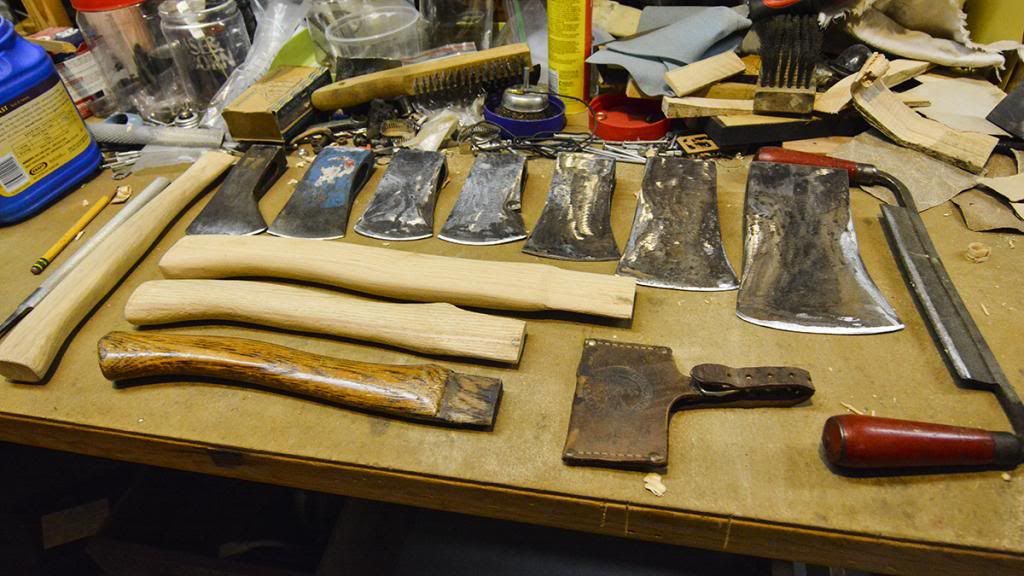

-Some pieces I have been restoring. I watched some of Autine's videos on Vimeo - which impulsively made me do all of this. I posted a "Wanted" add on craigslist and managed to score a lot of 16 ax / hatchet / hewing / hammer hatchet heads for $65.
-I Vinegar soaked the heads, then some grinding down of the rust pitting, mushrooming and chunky edges.
-The brown finished handle goes with the Norlund Voyager Axe w/ Leather Case.

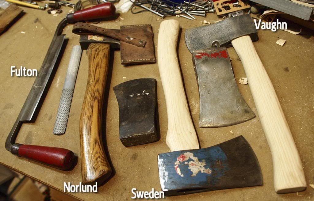

-Most of the heads were unmarked. The only marked ones were Norlund, Sweden (stamped), Vaugh, and B2.

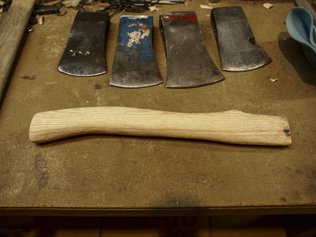

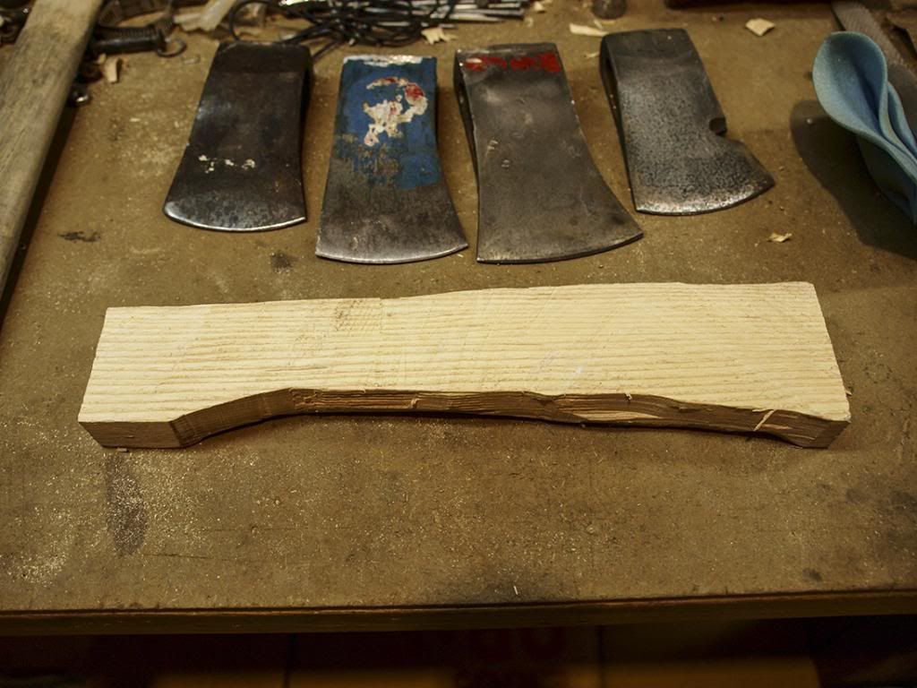

First attempt at making a handle out of a piece of Ash. I started to shape it by smacking at it with a hewing hatchet. I copied the Norlund's handle for shaping.
Here are the names of the marks that had them. I found the draw knife at an antique store for $34

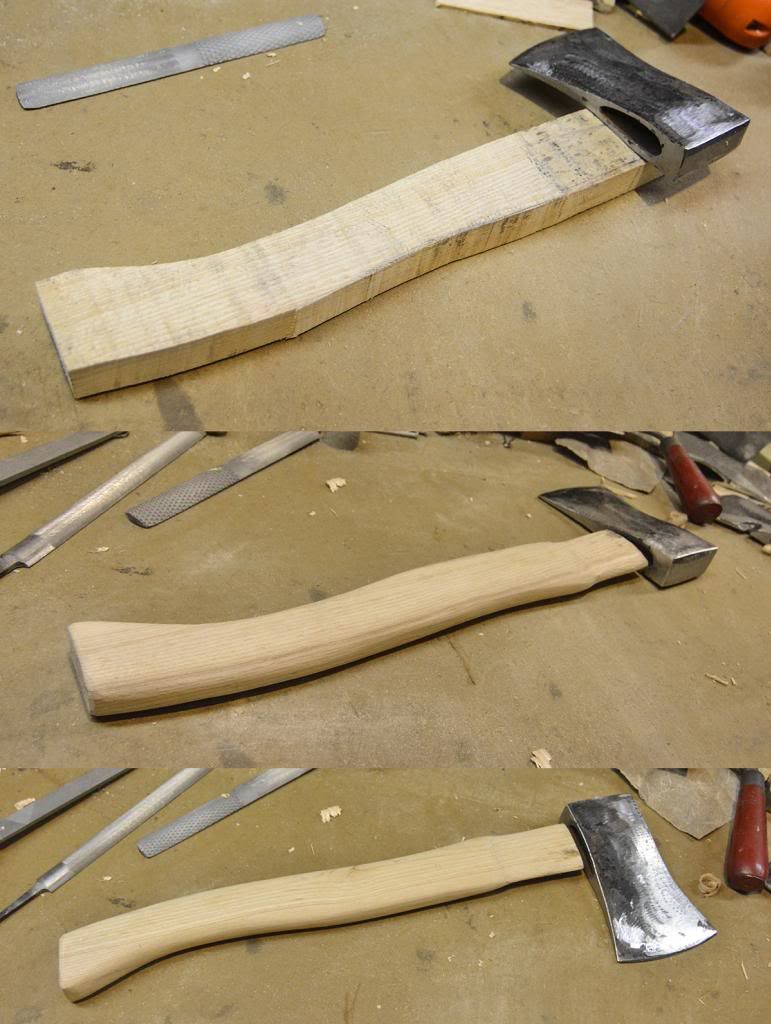

Third attempt - this time I used a jigsaw to start the shaping. A mid sized hatchet
-I am yet to hang anything permanently. I am not sure how I want to finish them yet. I have some old wood stain I want to put on the handles I made.
I was thinking of painting some of the heads with Rustoleum Paint / Primer mix spray can. But I would rather make them black with the heated Linseed oil - which I don't know how to do properly. Shaping the part the axe head attaches to the handle is the toughest part for me. Any suggestions on making it easier would be appreciated.
Thoughts? Suggestions? Histories? Values?
