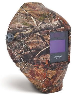

I was recently watching someone do some arc welding. I had on a pair of goggles I thought were for welding. I soon found out that they weren't. The guy tried them and said that they were probably for cutting. I tried out a welding helmet. What a difference.
With the goggles, I could see what was being done just fine, but not enough protection. With the helmet, I couldn't see practically anything until the arc was struck.
With an auto darkening helmet, how does it work? Are they just light enough to see everything and where you are going to be welding, then when the arc is struck, do they darken quick enough to protect your eyes properly?
Are the auto darkening helmets from harbor freight decent or are they like most other things from there, crap?
Thanks
The auto darkening hemet allows you to see were you are about to weld. and then when you strike an arc they darken imediatly.and yes they do protect your eyes properly. If you are going to do a lot of welding i would not get a cheap one, they don't last very long, but a good one like a Miller or a Hobart etc can run you a couple hundred dollars. Also I don't know how much time elapsed from when you were wearing the cutting goggles til the time you tried the helmet. But if your eyes are not to messed up from looking at an arc you can see throught the auto darkening helmet enough to see around You. Hope this helps

Thats right. There is light enough to see what youre doing, and the second the arc is struck, they darken. It happens so fast, that you dont register the blinding light of the arc. We're talking a tenth of a second. There is no danger of damaging your eyes.
I used one for a long time, and never had a problem with it. But if youre welding next to somebody else, it can get annoying, cause your helmet will darken when it registers the other arc.
A top of the line helmet, will provide you with options to adjust all the variables. Ive attached a pic of the inside of my SpeedGlas helmet.

I can, I bought one for work, lasted a year, I weld almost everyday. The Harbor Freight helmet did good, but I had underlying concerns, my eyes!! Every time I welded, I wondered if the cheaper helmet was somehow damaging my eyes. Even though I never noticed anything bad, no headaches, no eye aches, etc. When the helmet took a $#!* after a year, I decided to get a real helmet, a Miller Performance Series Welding helmet.
To sum up. If your doing occasional welding the H/F auto darking helmet would be fine IMO. But you you are going to be doing a lot of welding, spend the money and get one by Miller, Hobart, Lincoln, people who have been making them for awhile.

Get a variable shade model-adjustable darkness/protection.
9-13 is common

If it is not for an everyday 8 hr welding job that HF should do you fine. Adjusts from 9-13 too. We have one at work for when we do frame repairs and need little things welded and it works great.
I think they are brilliant. They do need to be tuned to the right settings but they are so much easier than flipping it down.
As a side note, one may wonder how this thing is accomplished, a welding helmet that darkens by itself? The answer is that these helmets have electronics is them with a photosensor that detects the arc. The viewing lense is similar to an LCD display; it can be darkened by applying an electrical charge to it. Some of these helmets need a battery that has to be replaced. But the good ones actually use the bright light from the arc and a solar panel to keep a rechargeable battery charged; clever, eh?
