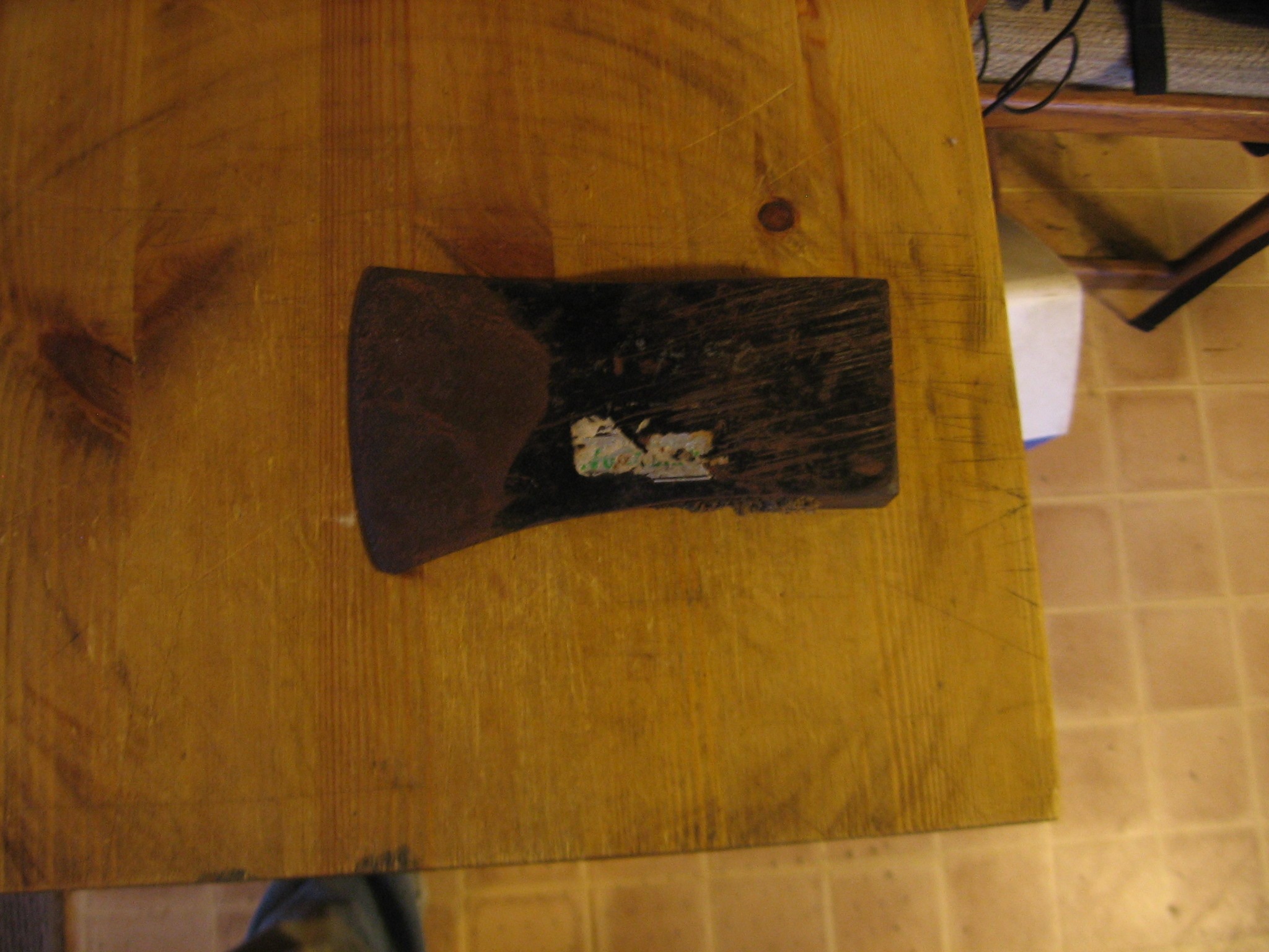

That solves a riddle Ive had for a long time. I have a black hatchet with ridges in the eye, and have never figured it out. Unfortunately though, the steel is so soft I cant even get the rust off without damaging the metal. Thanks Squarepeg for the info!

You may be jumping to conclusions. Does your hatchet also have a small stamp with letters and or numbers? If so I would say TrueTemper, if not it could still be a TrueTemper. That soft steel does not sound like a True Temper though or any of the manufactures that I know of that made ridged eyes. Maybe it found its way into a fire at one time?
I know for sure that Collins and Vaughn also made axes with ridges in the eyes. And it would not surprise me to learn of others.

No stamps whatsoever. If it weren't for the partial label I couldn't have identified it beyond the eye ridges.

This one has good steel.
