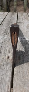

Funny coincidence: A few days ago I found in a bucket of edged tools in my shed a single-bevel half-hatchet. I have owned it for a while but had never noticed the single bevel. With just a few keystrokes, Google showed me a Plumb flooring hatchet. Mine is an OVB, but I'm suspicious it was made by Plumb.
JPEG_20200402_132440_4058377627101923582.jpg JPEG_20200402_132629_880196239269233752.jpg JPEG_20200402_132519_545878690826782472.jpg
What I couldn't find online was how a flooring hatchet was used. Now, thanks to Ernest, I have a little better idea. T-A
