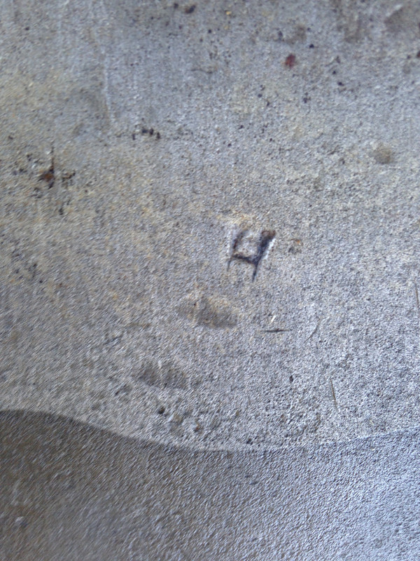

I think this is a Warren head.
I can faintly see ...REN... But not good enough to get a photo.

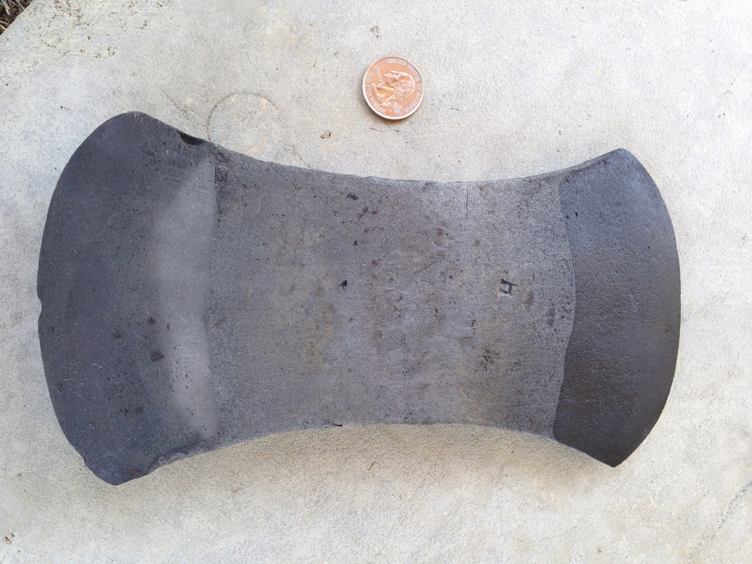

It's also stamped 4 3/4. And appears to have an "H" stamp also. I can't find any info on laminate axe heads. When did they stop doing that process and did Warren use it on some of their heads. This first photo shows the steel after a two day vinegar bath.

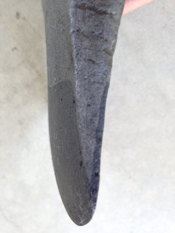

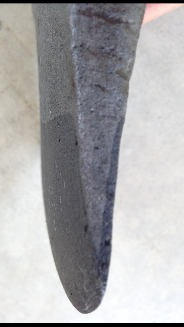

Here you can see the two different metals.

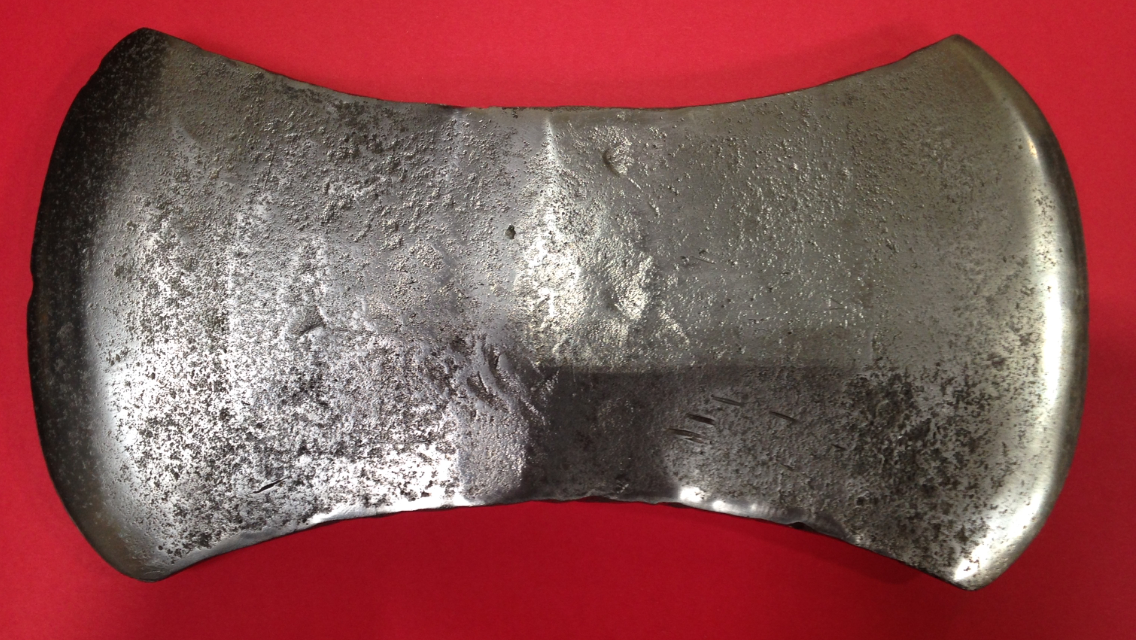

Putting a little shine on it.

Well that's not nice ... the one photo that makes me think the axe head is laminate. The system won't let me share the photo.
It thinks it's "inappropriate or spam like "
I'll try one more time.
[/URL]
%5Burl=https://postimg.cc/image/afxmg2qe3/][/URL]
That looks like the "overcoat" method, which Warren used, as described in this earlier post (with link to a good article):
Another company using the overcoat method was Warren Axe & Tool (from 1921 article).
books
a: stock for the axe head
b,c: after punching for the eye, single and double bit
d: bar stock for the overcoat bit
e: overcoat after shaping
f,g: axe heads after "hand forging" the bits using trip hammers
