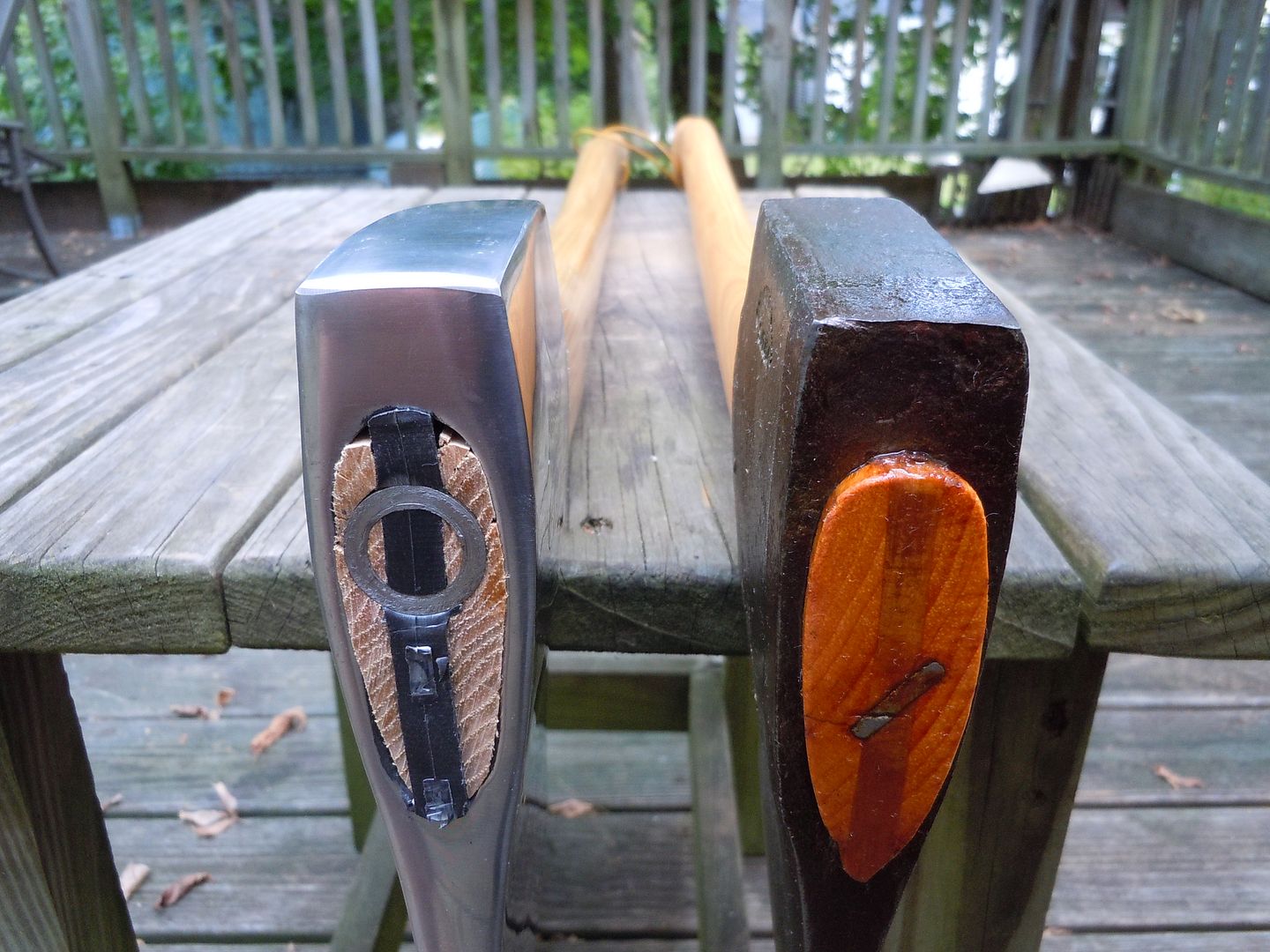

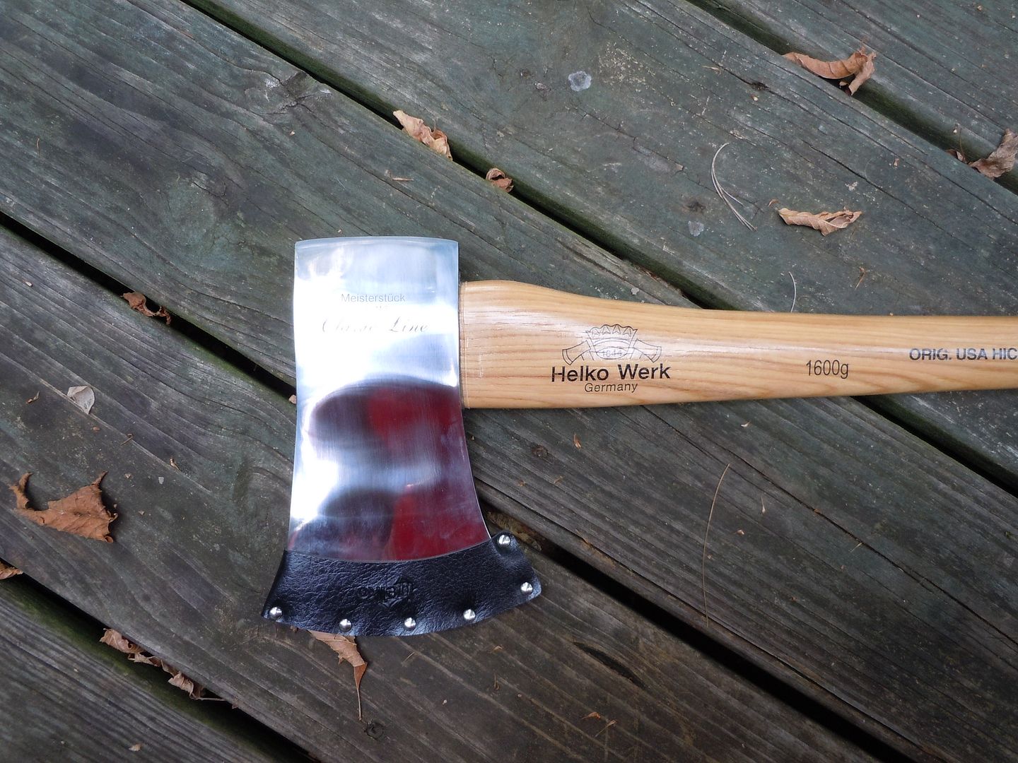

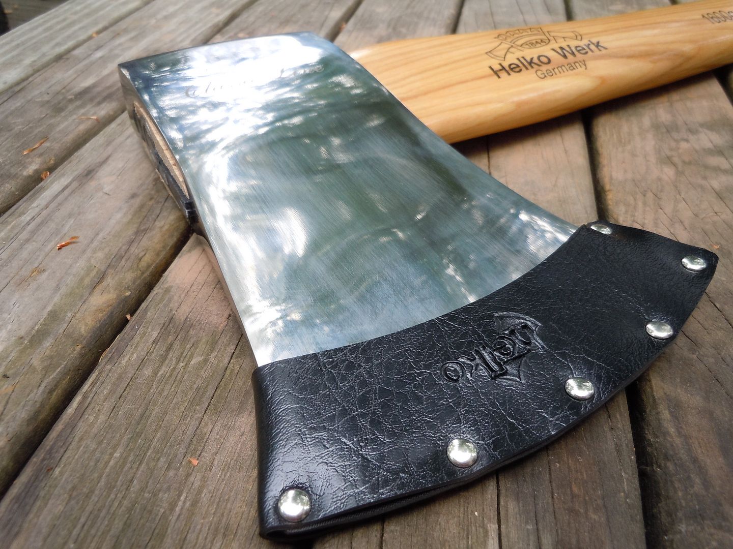

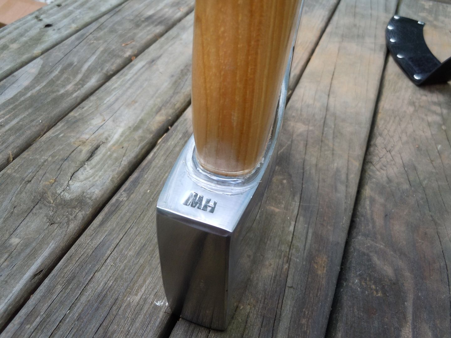

Skog -

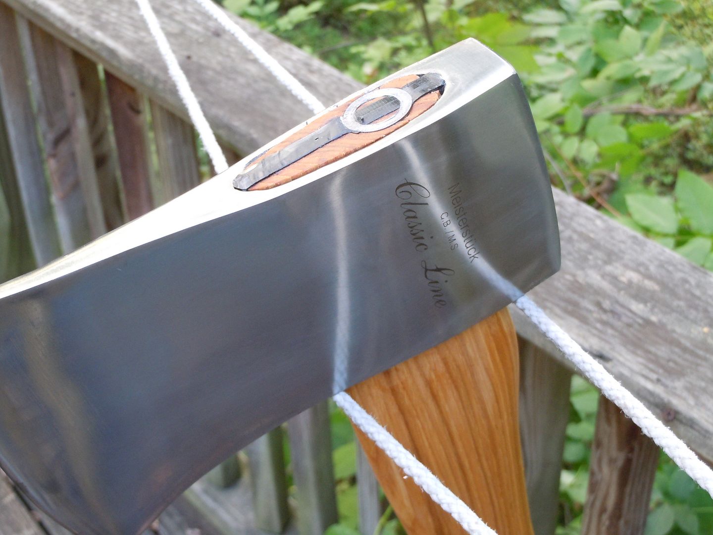

That beast looks real nice.

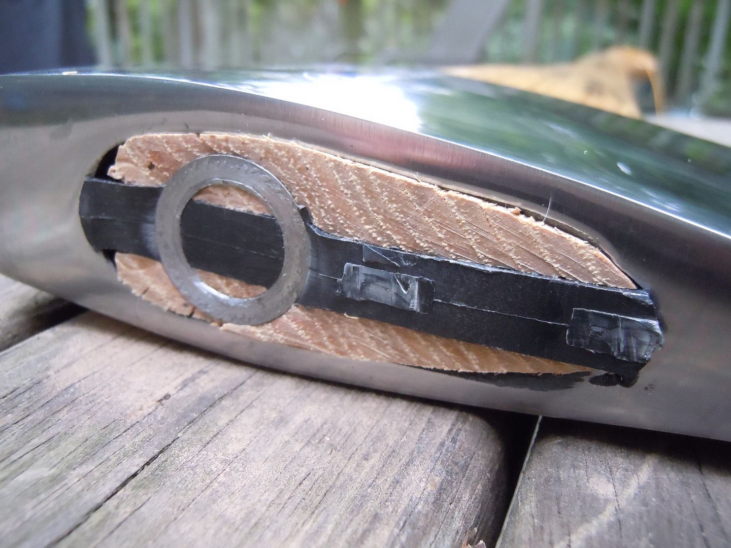

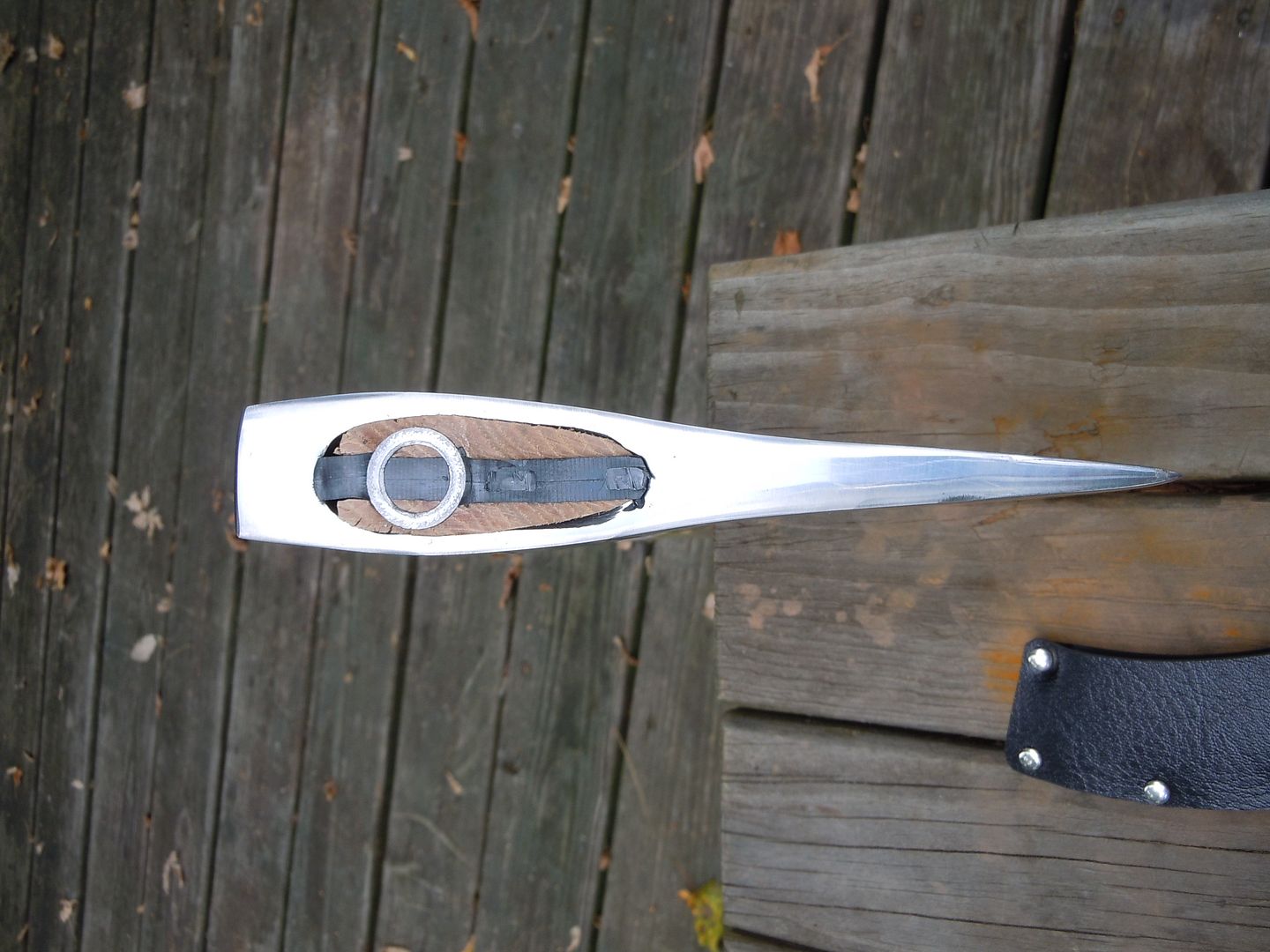

It looks well made, though I am unsure or perhaps not 100% sold on the wedge. You say it doesn't seem to bother you, which is re-assuring, though I wonder what your thoughts on how you think it will do once you get to action? Think it might be an issue at all? How would you think that wedge style (plastic) compares to what I see you do, which is the old school wood wedge, no metal wedge? What are your thoughts on the round metal wedges? Just wondering.
Seems like a real nice piece.
Thanks for the info and pics.

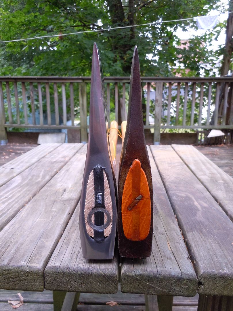

If you look close they must have used a ton or two ton press on that plastic wedge. So tight it separated grain. Then they drove a oversized round wedge. Seems like it isn't going anywhere. I imagine it will not come close or migrate at all. Wont know for sure until it sees actual hard use.
I like being traditional with wood wedge and no steel wedge, and that's because I like the old fashioned look. I figure if you get your wood wedge in correctly and nice and tight, not much more a steel wedge is going to do for you. Round wedge perhaps seems more logical as it gives you an even press all around.
Of course I make no claim of expertise of any kind in my opinion hahaha
What's your take on it?
I am with you, and have stated before on here, that, like you said, if you do it right with the wooden wedge, you probably shouldn't need a metal wedge. That being said, I am no expert at hanging an axe, and sometimes have had to use a metal wedge. So I guess it is what it is. The plastic wedge seems a little alien to me. Though when I checked out the website, it talked about the handle process, and much like you said, I would also doubt it is going anywhere. I guess if I was going to use it on a regular basis and the plastic wedge meant I didnt have to worry about the handle, then so be it. I figure perhaps it makes the process a little more automated and streamlined, as far as overall manufacturering? Thats why they went that route?
Like you said I think it was a manufacturing decision. The strong plastic wedge left little room for error on broken wedges, and allowed a very strong bond. No warranty claims down the road for loose heads I suppose.
There is also that bit about the German manufacturing standards. Perhaps a metal wedge pressed by a two ton or something was the only way to meet them. Who knows.
Yeah I thought about that to, and that makes sense. You know how the Germans roll. Lets say you did have to remove the head. You somehow busted up the handle and had to replace. How much of a job are you looking at there do you think with the plastic wedge? Could you still drill it out pretty easy enough, or maybe have some serious time on your hands with the whole operation?
Nothing a good drill couldn't handle I don't think, and maybe a screw driver and hammer lol.
