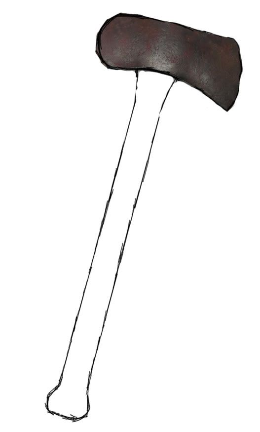

So I had an idea for this damaged axe here, and I want to know what you guys think of it. Yeah, it doesn't really need it, but I like doing this sort of thing. :D
Would it be terribly unbalanced, dangerous or what? It's a Kelly True Temper BTW.
Also, hello axe forum! I have a Sager double bit that should be arriving soon, and I'll post that once I fix it up.
It would be terribly unbalanced. Without the mass of a poll or second bit it will be harder to control. But I think it would still be usable. I'd leave it as is and use the good side.

It would definitely be usable, but I'm also thinking it would be a bit harder to use.

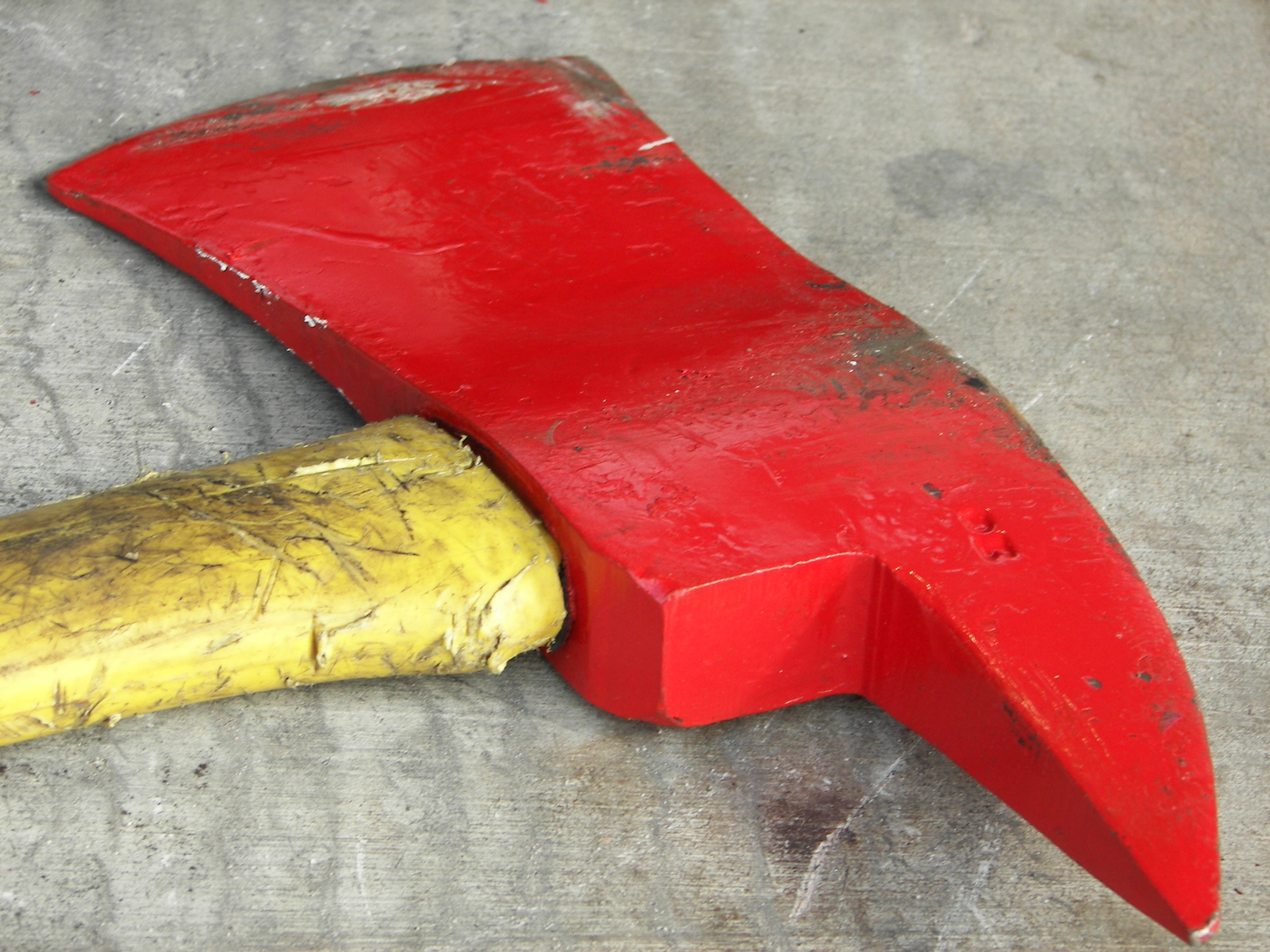

Maybe a firemans style could give you what you want while maintaining balance..

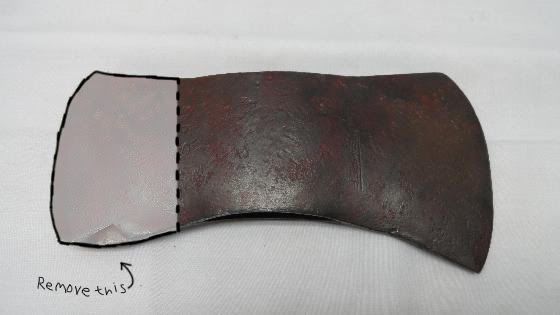

Thanks for the input guys, I think I might do something like below...
Round it off enough to look good and still maintain balance... I like it!
i agree with this proposal, i have several damaged doubles and figured this would be the best route to bringing them back
Hm. I think the differential hardening will prevent my first idea from working... yeah, a pulaski is a good plan.
If you take off enough steel to unbalance it, you might balance it by putting a curved handle on.

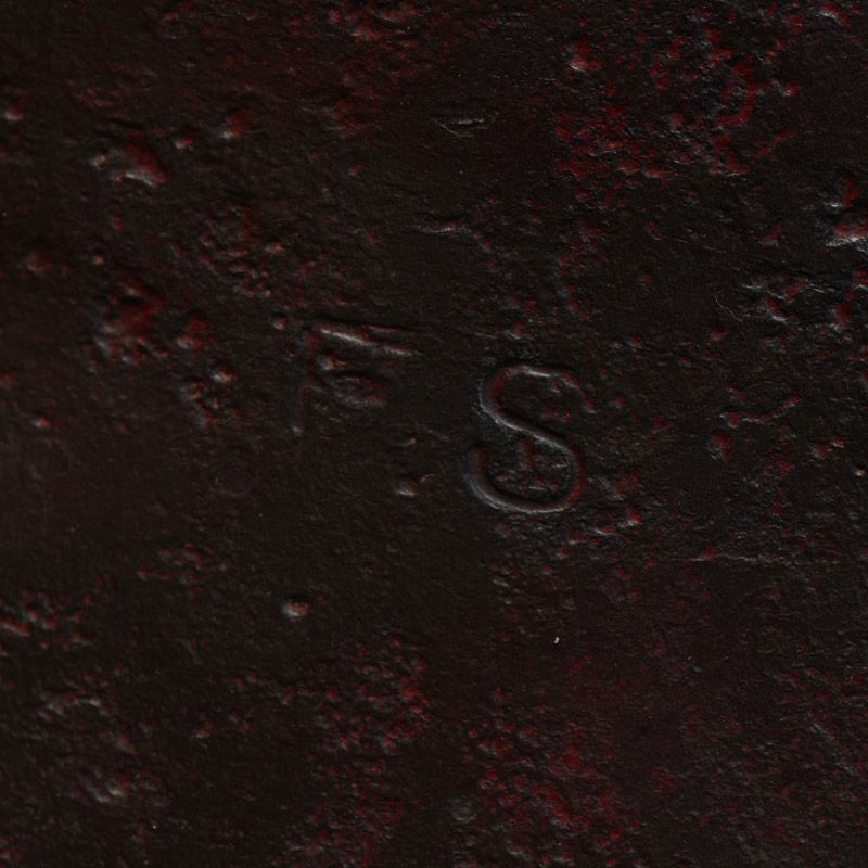

I have one question though, I found a stamp on the axe that says "F.S." Is this normal, or was it added by an organization?

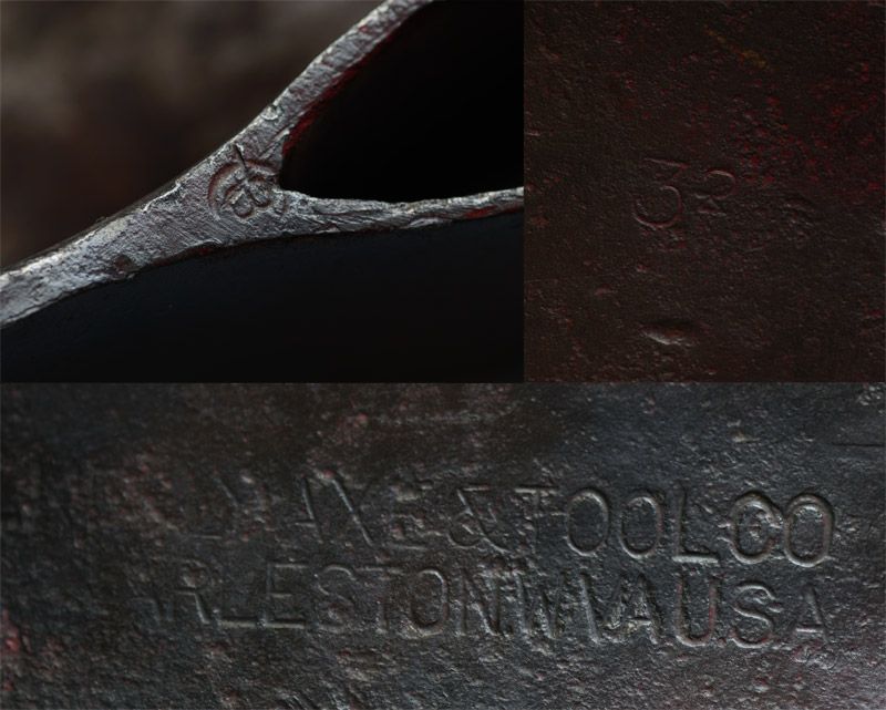

Other marks, was also wondering about the 8 on the bottom...
.... I found a stamp on the axe that says "F.S." Is this normal, or was it added by an organization?
Forest Service. Mostly likely a factory stamp indicating that it was made to Forest Service specs. The 3^2 stamp means 3-1/2 pounds. The '8' probably identifies which line in the factory it was made on or something like that.
