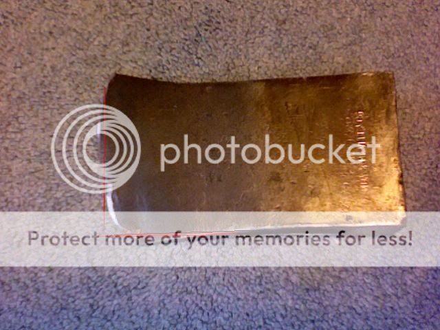

So I found this old Snow and Neally 3/12 standard head. Poll was a bit funny, and it had a good chip in the toe of the bit (see photo, axe head is upside down). Fortunately, the price was way to good to pass up. 5 dollars if I recall. Unfortunately, I have no clue what to do with it now. Do I leave the chip in the blade and work around it? The other problem is that the edge is really screwy, alot further back on the toe than the heel. I'm kind of stumped on what to do with it. Especially with the profile. Anyone have any advice? Thanks.
Given that the toe and heel flare up, you could grind the toe (the side ground farther back) down in the same direction that the eye runs, if that makes sense. Then you could just true the edge up a bit more and she'd be good to go. I love S&N's, good axes.
It looks to me like it's gotten a lot of use and a lot of sharpening. I've seen quite a few old, overly sharpened bits with toes that are shorter than the heels.
Looking at the distance from the bit edge to the eye, it's quite a bit shorter than it would have been when it was new, another sign that it's been sharpened quite a bit. This results in some pretty steep edge angles (if I'm looking at your photo correctly). If so, I'd relegate it to splitting duty if it's of sufficient weight, but it may not make the best chopper. But for 5 bucks, it's hard to pass up.
By the way, that profile is what all the S&N axes and Maine patterns had. It it shaped like a wedge, but it is not a splitting axe. S&N axes also had very short bits from the factory.
I drew this up for you pertaining to what I would do it it. Of course, if it is just TOO overwhelming you could mail it to me ;)

I'll defer to Gpig. I'm only familiar with the more recent S&N. Any ideas on when this head dates from? I'd also be curious to know what the weight is, if it differs from 3 1/2, it could tell you how much use it's seen and how much it's been sharpened down (which maybe not much from what it sounds like).

G pig, thank you for the photo and explanation. I'll start there for repairs, and I'll see what happens. And I'm afraid I don't have a scale lying around, sorry. Also, I don't know much about markings, but I know my year old Snow and Neally kindling axe has a S N on the underside of the poll, etched into the metal.
