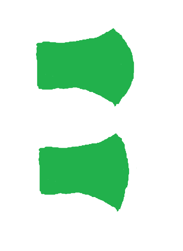

Here's my process to help out any people who might just be starting off with restorations (since there's 2 people in this thread who seem to fit the description). I use a 12" Nicholson Mill bastard for the work. I used to have a US-made one, but that finally started to wear down. The ones they sell at hardware stores are now made in mexico. They still work very well, but will wear down after restoring 3-5 axes if you're doing a lot of reshaping/metal removal.
I use two C-clamps to pin my work down like so and just flip it as needed:

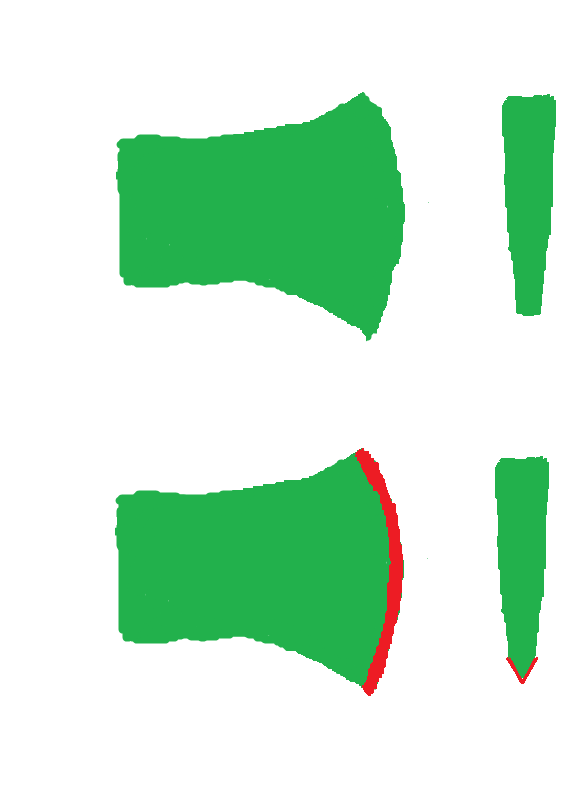

The first step, which I'll skip if the shape is good, is trueing up the edge and taking the nicks out. If a head got a lot of abuse in its future life (usually caused by glancing or missing and the bit ending up in the ground/rocks), it'll be a bit more circular from uneven wear at the toe or heel of the bit. Making the bit straighter will make it more efficient and less prone to glancing:

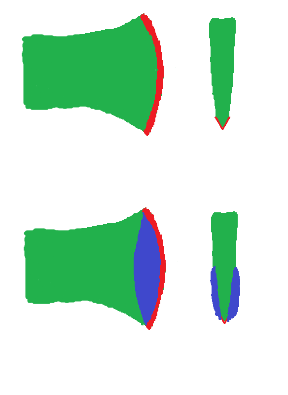

Next I'll put the basic ~20 degree edge back into it, very blunt without much convexing.
Lastly, I take material off the cheeks to thin it out and allow the bit to bite deeper. I usually do something similar to a banana grind to keep the toe and heel more robust.

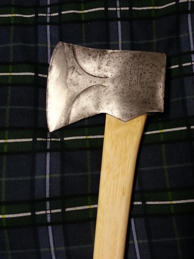

Here's the latest axe I restored, showing the sort of grind I end up with. A jersey pattern True Temper Kelly Perfect that I rehung on a 35" straight haft:
