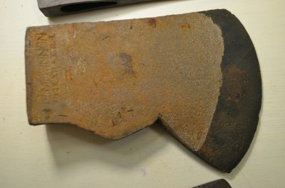

I am restoring 3 axes. I have a McKinnon Rockaway, American Fork and Hoe, and Diamond.
I have searched on Google and yesteryeartools.com for information about McKinnon and diamond without success.
Any info the forum can provide is appreciated. Also is there any information I should know before restoring this old axe? I don't want to damage it?

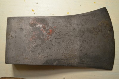

The diamond axe was painted red but I have no info on the maker. Again, any info the forum provide is greatly appreciated.

Here's the photo of your McKinnon Rockaway (on the tumblr page, I right-clicked on the photo and copied the image URL):
Those McKinnon Rockaways are pretty uncommon. Here's some info from a search of this forum:

Those diamond axes are typically from China.
Thanks Steve for the quick response. That is a bummer about the diamond axe. I will sharpen it up and use it. I hope it holds an edge. The McKinnon was a good find it seems. I am excited to restore it. I soaked the axe head in apple cider vinegar for 7 days. The next phase is to file off the mushrooming and then sand from 60 to 400 grit sand paper. The bit doesn't have any nicks out of it other than the damage from the rust so it should sharpen nicely.

McKinnon marked Rockaway, NJ

Diamond apparently Chinese :(
That McKinnon looks pretty good. Nice bit shape. Looks like it might have some rebound rust from the vinegar. I'd scrub it down with a scrubby pad and a little more vinegar, then give it a generous coat of WD-40 or linseed oil.
As for the Chinese Diamond axe, use it to try out a different handle than you normally would, or try a different bit profile. I think these axes are actually quite useful for trying stuff out that you wouldn't try on a 'worthier' axe.

Walters Axe of Hull, Quebec used to make a grade of axes that were called "Black Diamond". The ones I have don't feature a graphic of a diamond on them and generally are stamped Walters Black Diamond or just Black Diamond. Could be you have something like this. Certainly the head looks familiar.
About that Diamond stamp, here's a similar one from another thread. I didn't think about taking a photo of those NOS Chinese mauls I saw with the identical diamond brand.
looks to me like made in China, company is Diamond. So it looks like anyways...
Today at a "vintage tools" store, I saw a box with a bunch of splitting mauls with the Diamond brand, made in China. Not definitive proof regarding your axe, though.
It looks like under the comapny name it does say Made IN China. The last letter do like NA mabey INA
The steel in that Chinese axe might still be better than anything made in American today, including Barco and most Council fare. Axes you aren't overly attached to are very handy-- axes will take a beating and something to take that burden off of a nice or rare axe is valuable in it's own right.
The diamond Axe just has the image of a diamond and what I can make out "amond" is stamped underneath
