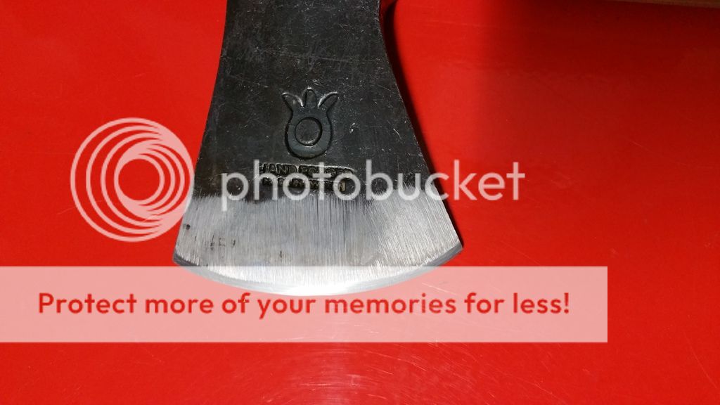

Anyone know of anyone in san diego CA that can help put an edge on an axe. Just bought my first axe. Husqvarna multi purpose/forest axe. Bought a lanksy puck and a combo 600/2000 whetstone. For the last hour or two i have cleaned up the edge and it seems alot better but still just does not seem sharp enough. Going camping this up coming monday and would like ti get it ready by then
You need to make the edge SHARP with a file first, then the puck. Nothing else is really needed unless you just want a shiny edge. Heck, in the great scheme of things a file is really all that is ever needed to work.

I'm in Ramona, but like square_peg said it's sharp enough and also quinton has a valid point. It just depends on what you want to do with it.

Yeah firefighters are busy enough. I went three years before sharpening my bear grylls hatchet and my guess is it arrived dull. You'll be fine
I am beach camping so all the fire is going in the fire pit they provide. Yea they have enough to worry about with this high heat. I have been studing and practicing the ray mears splitting wood and been working on starting a fire with ferro rod.. i want to teach my nephew and brother how to split wood properly and not pull a "alone season 2" accident and to make fire with a ferro rod. You guys are probably right its sharp enough. I have just never really done my own sharpening before and want to get it where it should be so i know for future reference

Those usually come reasonably sharp right out of the box too. That one looks really blunt. Friday afternoon axe apparently.

mine (husky hatchet) arrived here with a good edge geometry out of the box, its hard to judge your edge from the pictures but i think youll be fine.
I've owned about a half dozen of those Husqvarnas. A few came with VERY rough grinds. Most showed almost a 3 grind spot edge. I suggest a good metal file, elbow grease, and a bit of liquid courage (beers) and get after it!

The best kept secret in axe sharpening is to USE A BELT SANDER. YEAH THIS IS THE GREATEST SECRET OF ALL IN SHARPENING AN AXE TO HAIR SHAVING SHARPNESS.
My belt sander is a 1 X 30(inches) belt sander purchased from Harbor Freight Tools. There was a sale on these sanders when I purchased mine for $33.00.. The rough 40 t0 80 grit sanding belt is what I start with. I then go to 180 grain to 300 grain to 600 to 800. Most of the time you can skip the 800 grain. The 600 grain will put a razor sharp edge on your axe. Your axe looks as if the cheeks are thin enough now so don't worry about thinning the cheeks. Finish off the edge with a leather strop and the hair will jump

I wouldn't exactly call that a secret. But there's lots of ways of getting a good keen edge on an axe, and if doing it by hand then a file is the way to go for your initial stock removal, followed by the puck.
I just dont have the strength for this again, can somebody else counter Ripshin Lumberjack's post?
Well, I'll start. First of all is the myth that you can't destroy the heat treatment of the edge if you can still touch the blade with your bare hands. As someone who does beveling work all the time on a belt grinder, I can tell you that it's definitely possible to overheat the edge itself because the section of steel at the edge apex is so gosh-darned thin that it can heat up and cool down way faster than the rest of the bit/blade. A lot of care has to be taken when using power tools to sharpen, even with fresh belts and a light touch.
Way less chance of a big/non-reversible mistake when using a file and stones. Overheat the edge or make a divot or grind the heel/toe too much on accident and there's no going back without significant effort.
