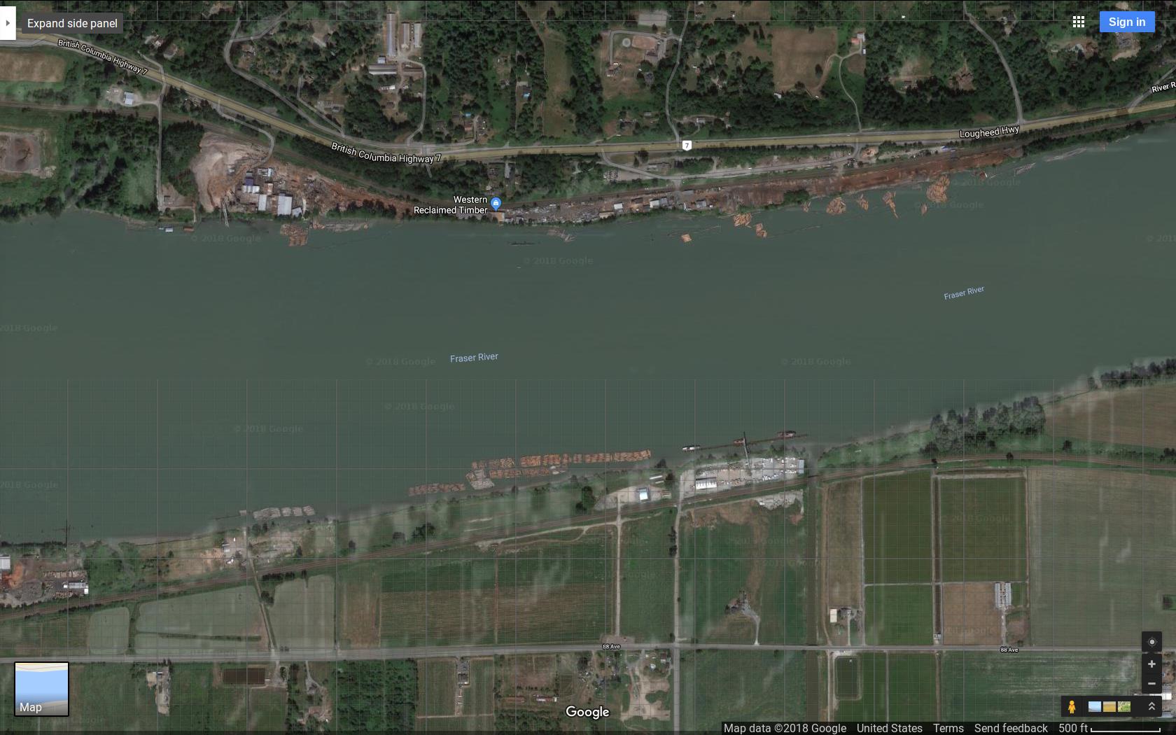

I think log rafts are finally gone from Washington. They haven't been on Lake Washington since the closure of the Barbee Mill, now an EPA superfund site because of chemicals used to treat wood. But I remember seeing logs on Lake WA. Puget Sound doesn't seem to have any log rafts anymore but it still did maybe 15-20 years ago. It wouldn't surprise me if Longview Fibre or Weyerhauser's Longview mills still see an occasional raft on the Columbia.
But the place in the NW where log rafts are still the norm is the Frasier River upstream from Vancouver BC. Here they are still common.
