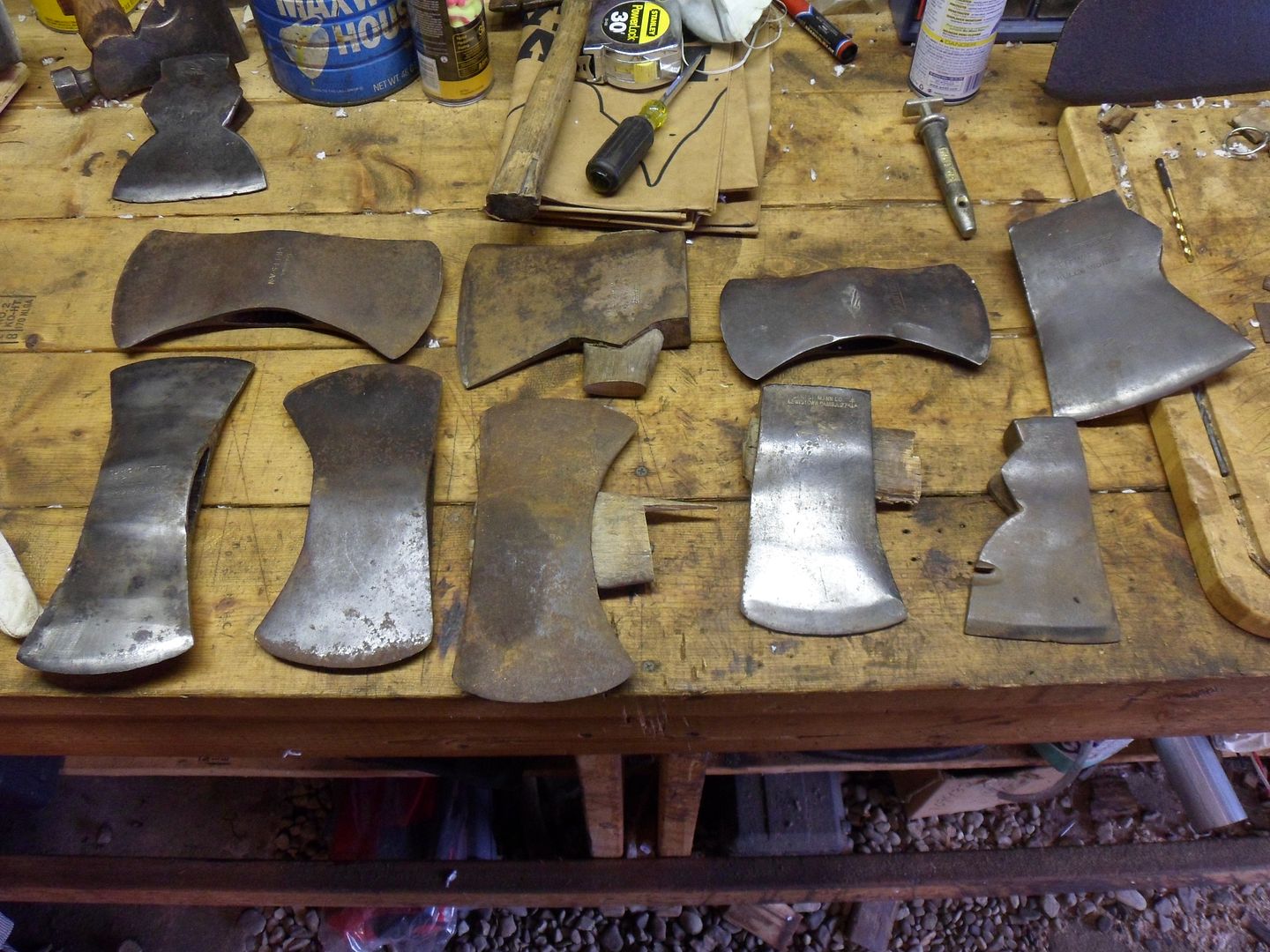

So, I had a bunch of axe heads that I needed to work on as I stated in another thread I started. Of course I am behind with work, life, weather, etc. So it was time to get some work done. This is work on heads only, and basic cleaning/refurb. No handles or sharpening, etc. That will be for next time.

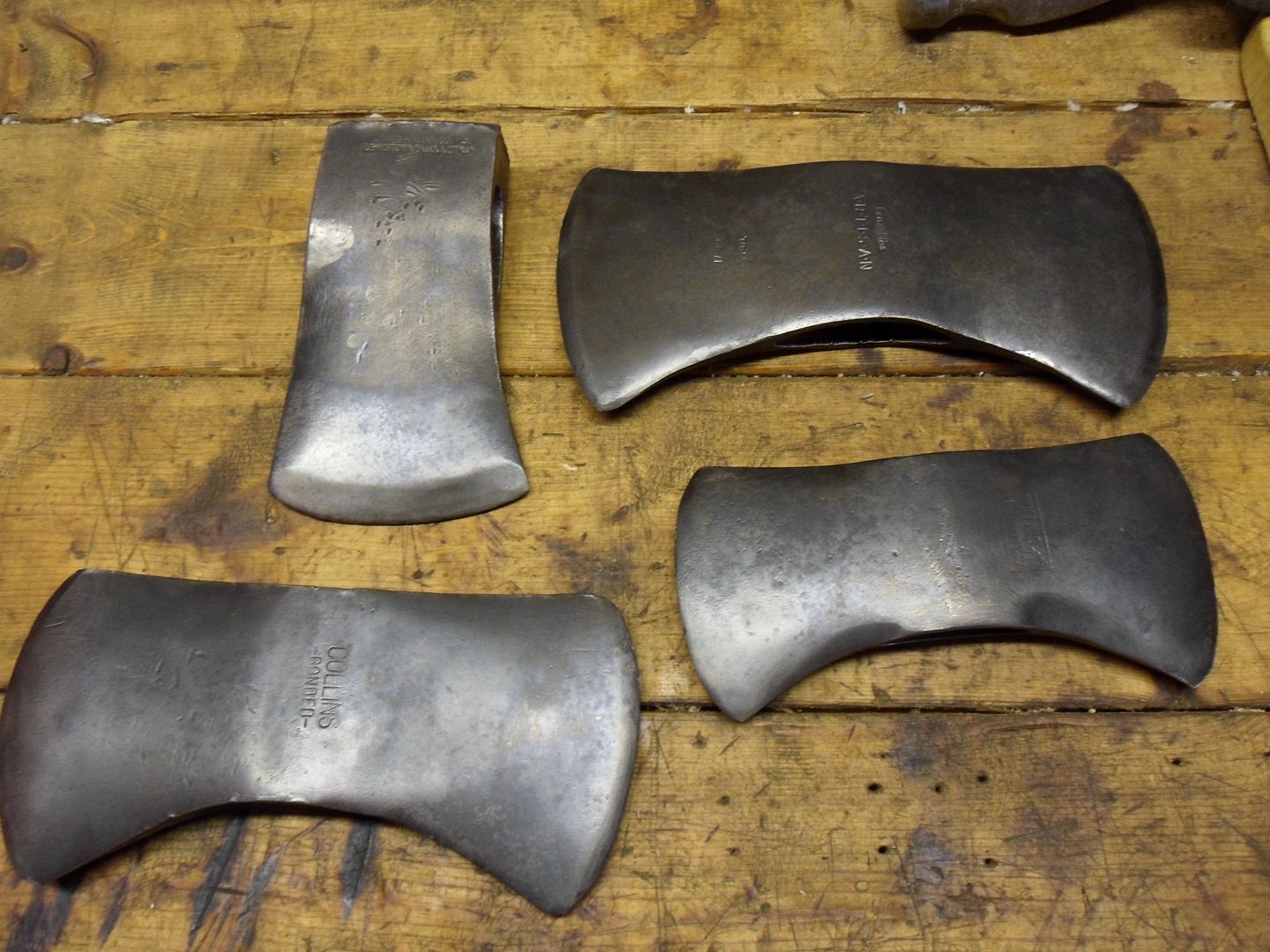

So, here is the lot I chose to do some damage on today :
Its a mix mash of different heads, companies, styles, etc. They need work and the time has come.

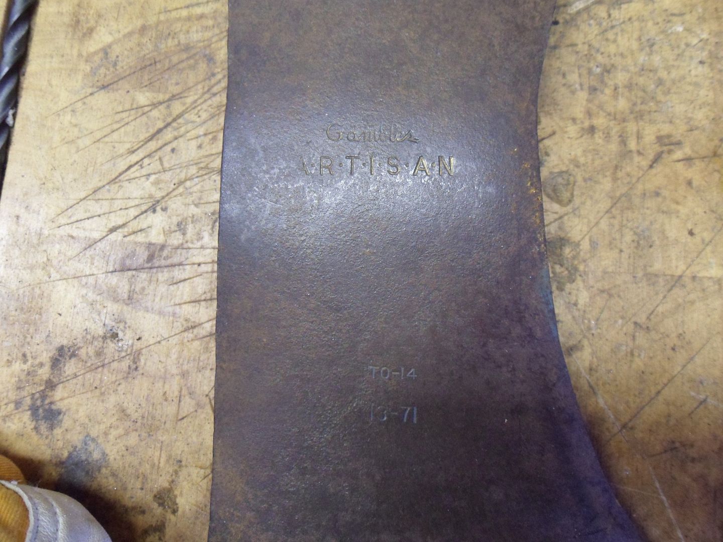

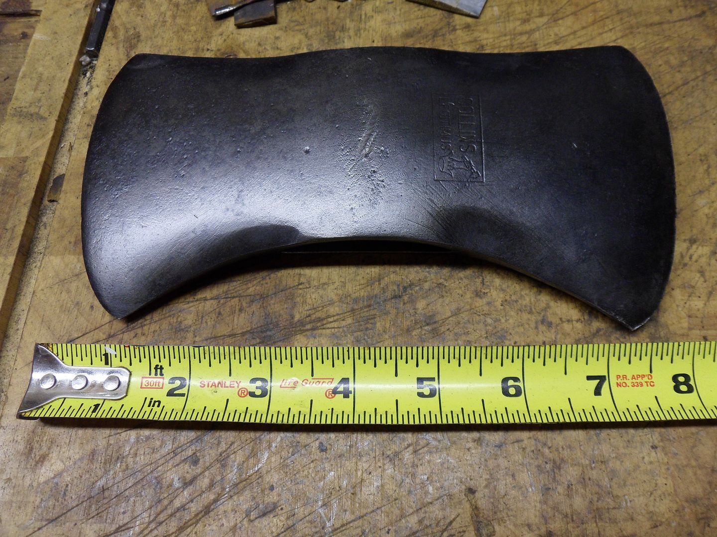

So I started off with this guy - Gambles Artisan
Pretty basic work over - I used an angle grinder with wire cup wheel and then hit it with oil afterward to remove grime/dust/dirt from the process itself.

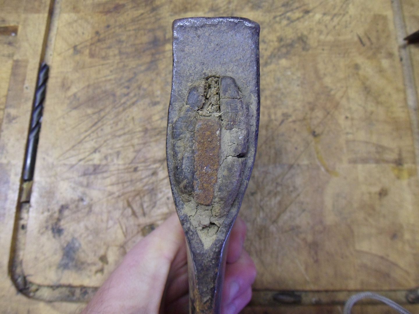

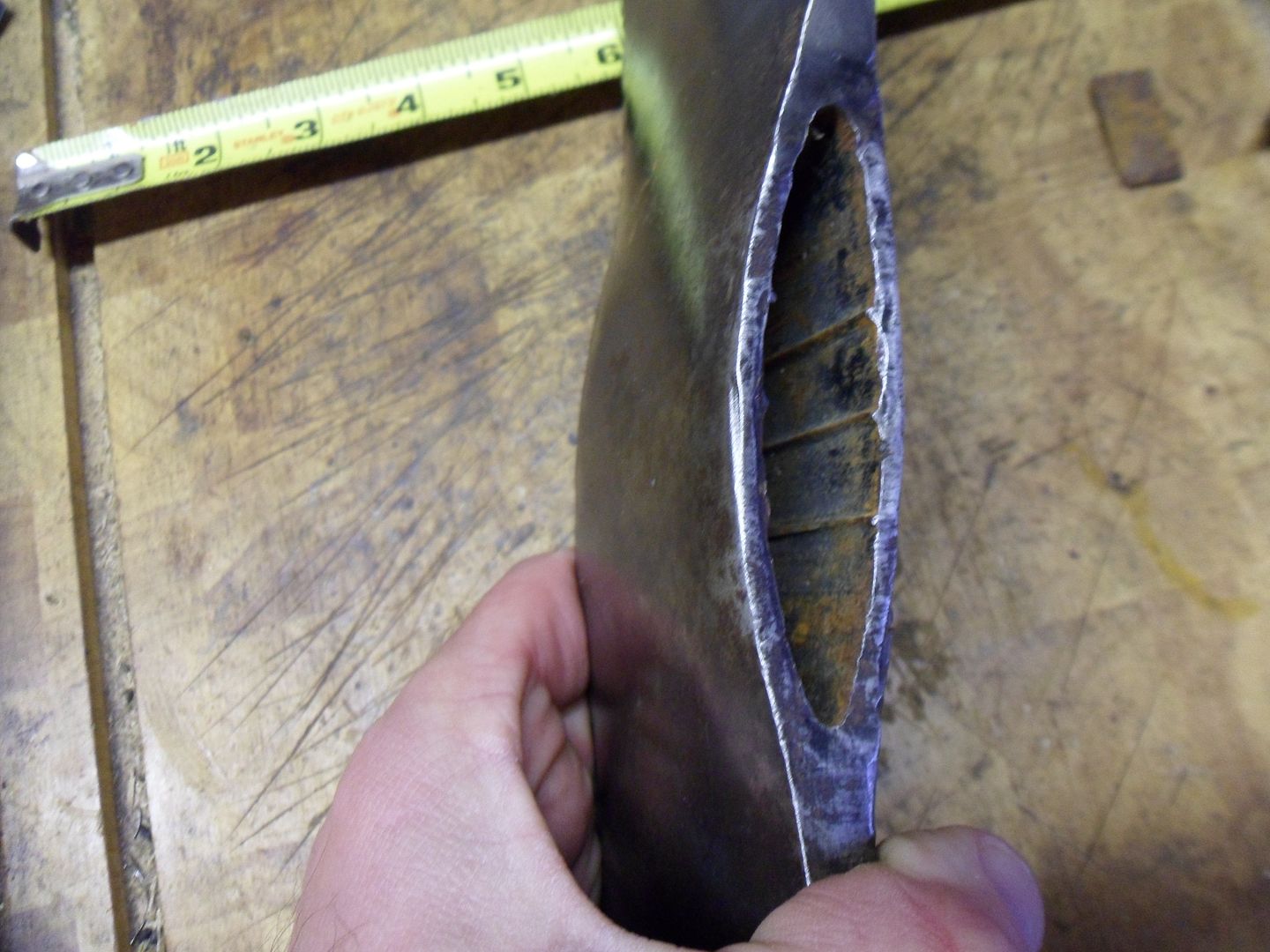

Interesting I thought - ridges in the eye - what could that mean?
So there is the first insight of the day. From what I have read and seen, more than likely this head was made by Kelly - well known for ridges in the eye - such as Flint Edge and other lines. Is it for sure a Kelly product?? Nope. But more than likely.

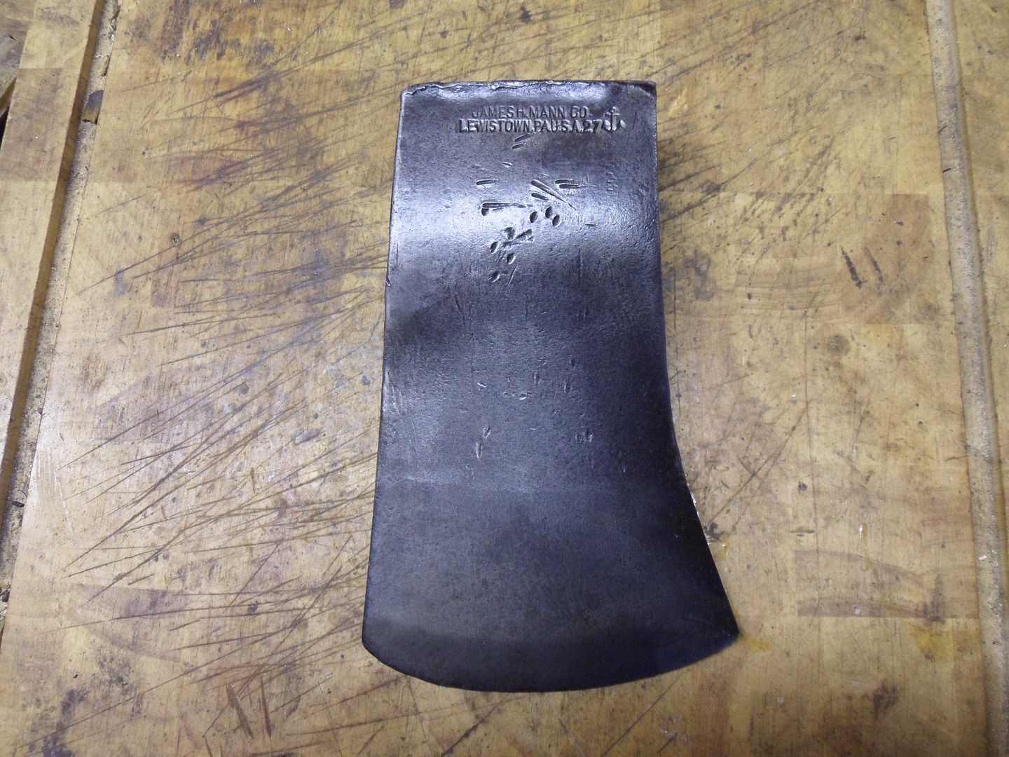

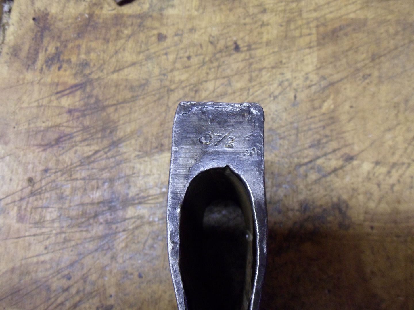

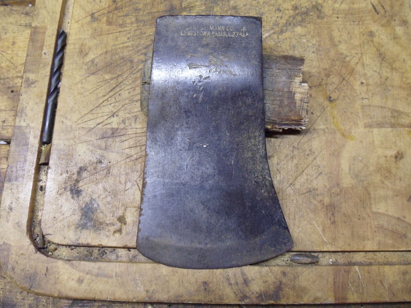

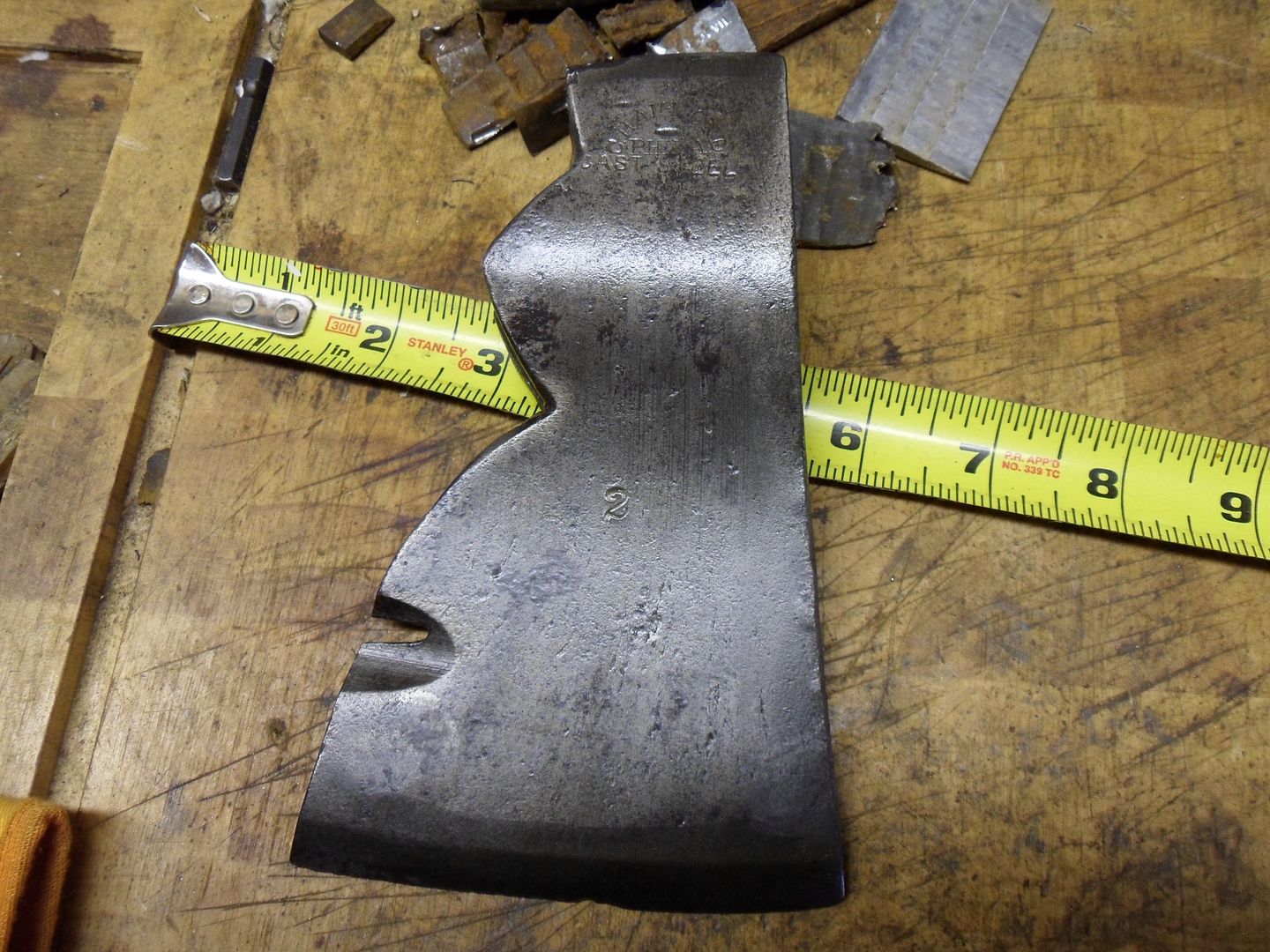

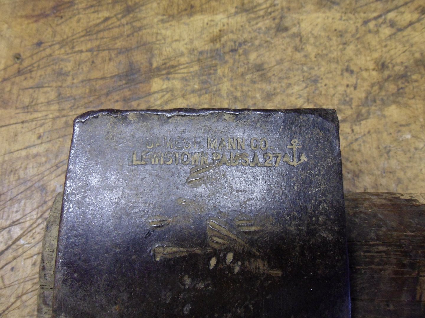

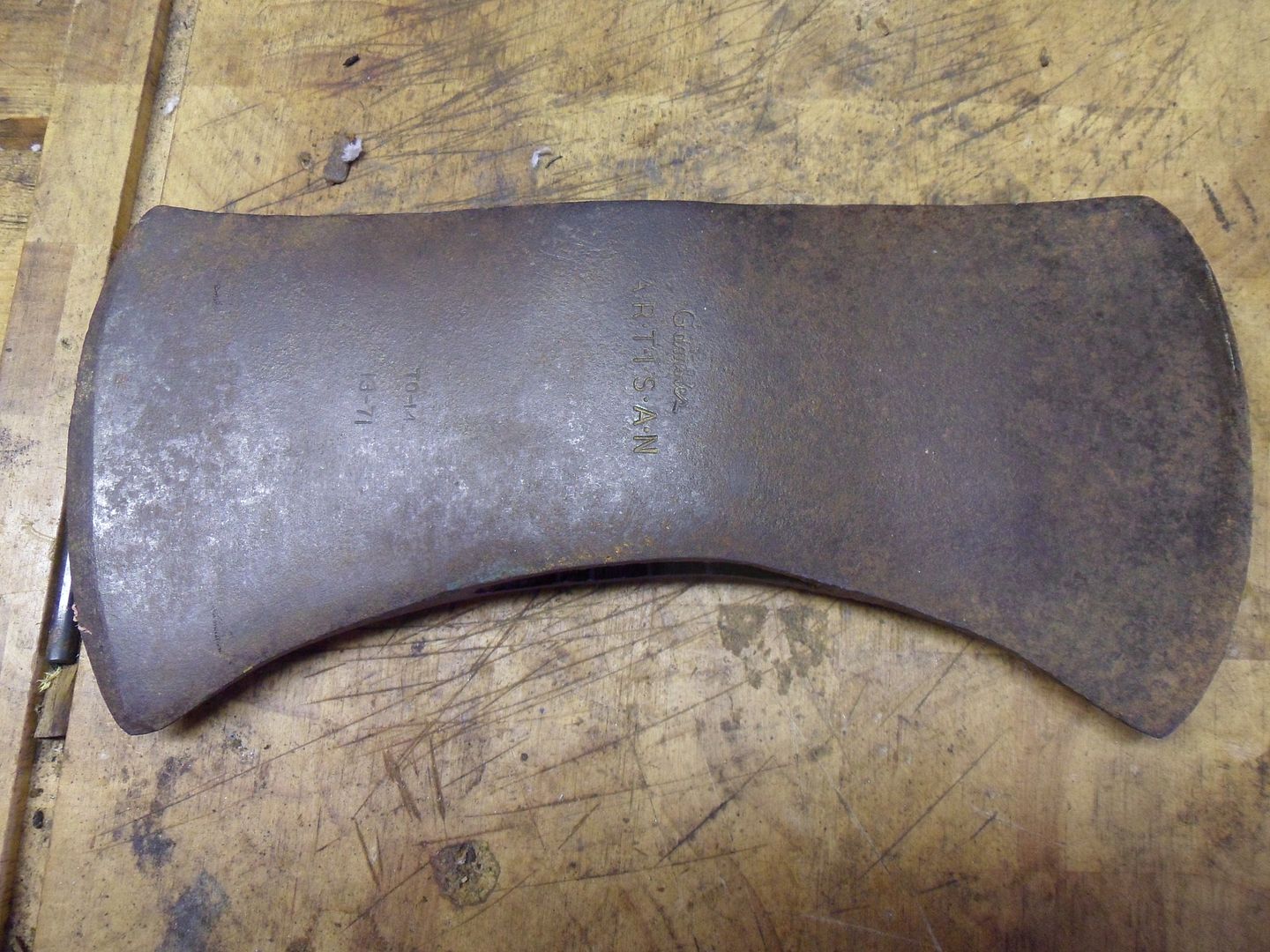

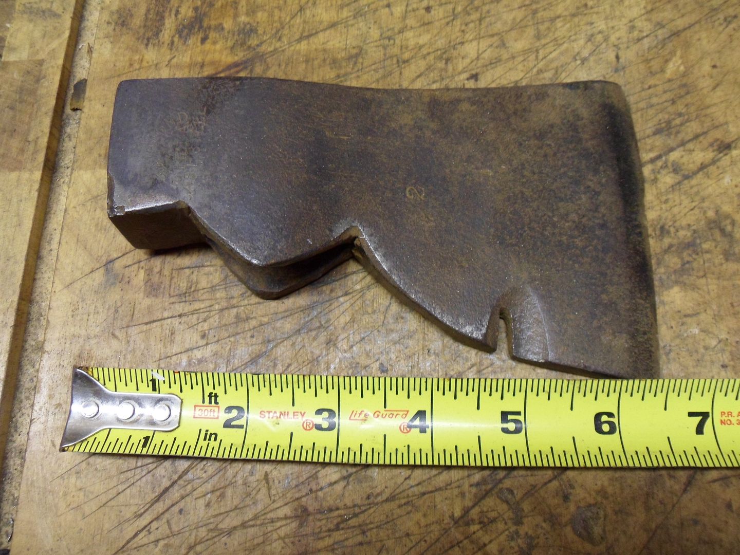

So then moved on to this one - A James H Mann (I have been chompin to get after this one, no idea about the anchor)

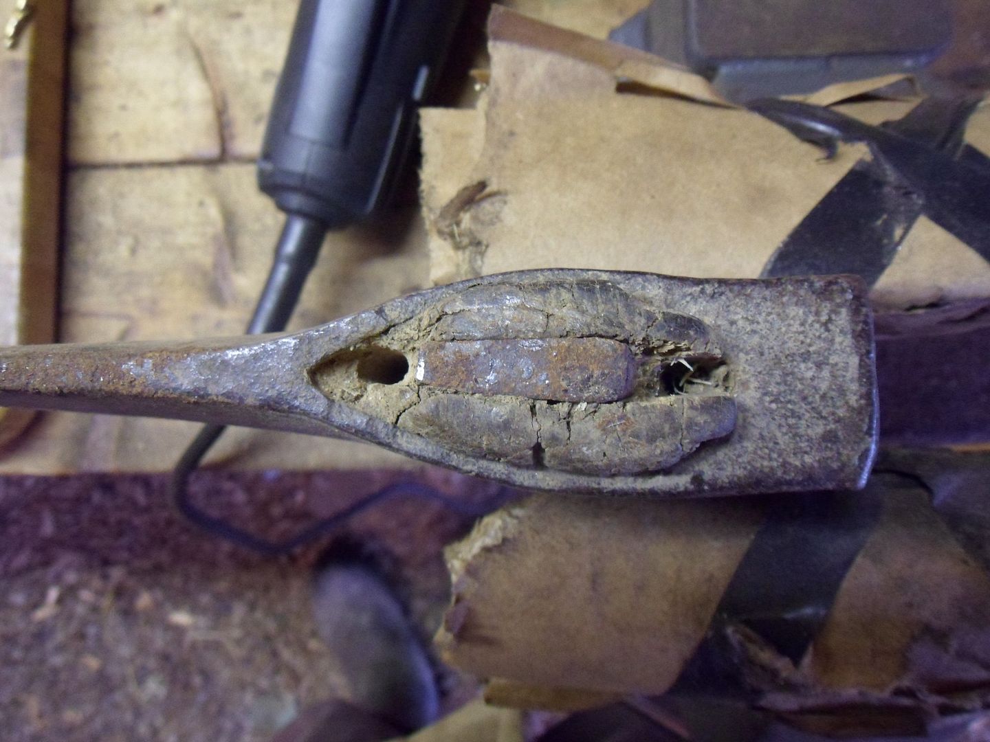

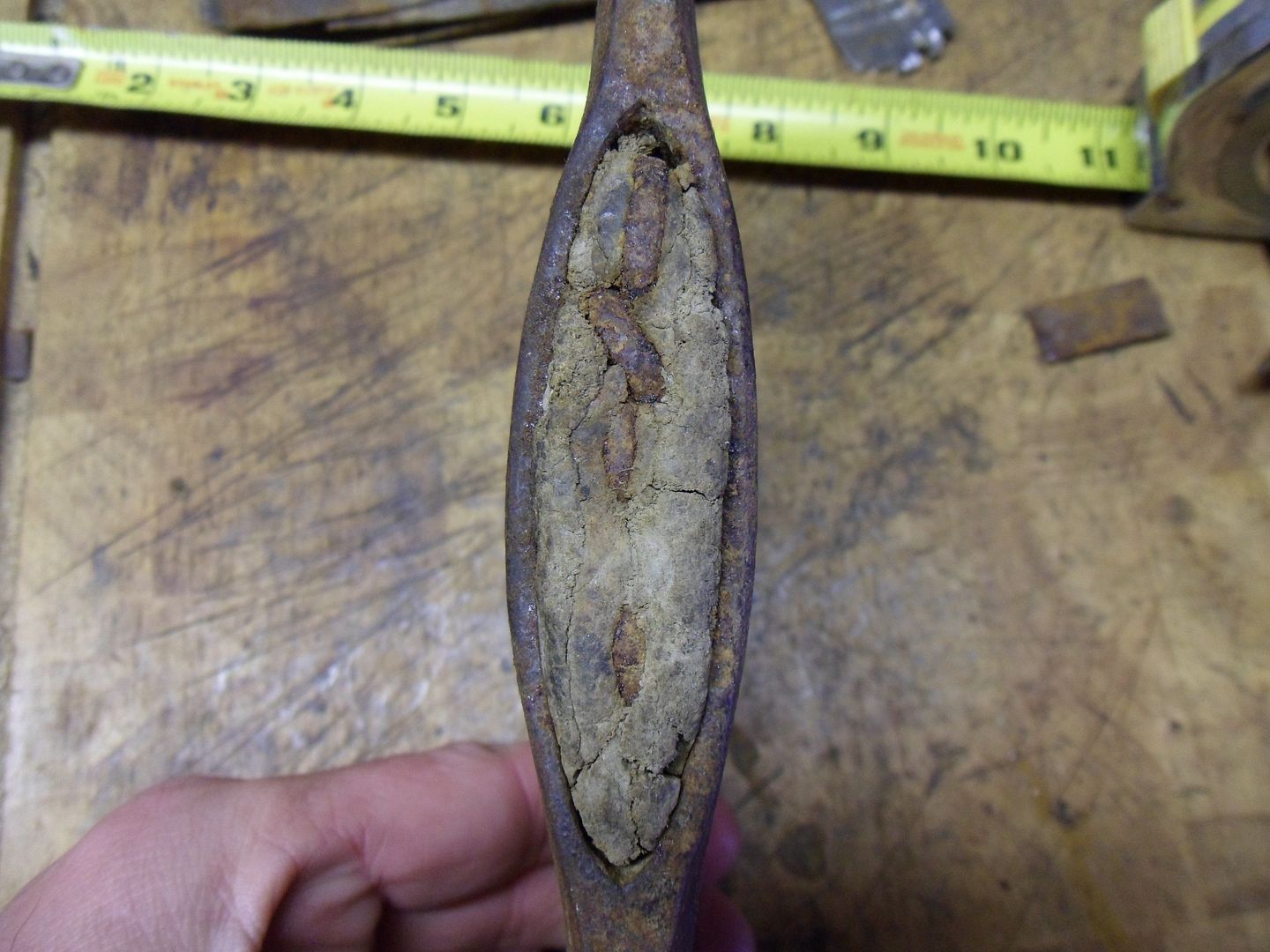

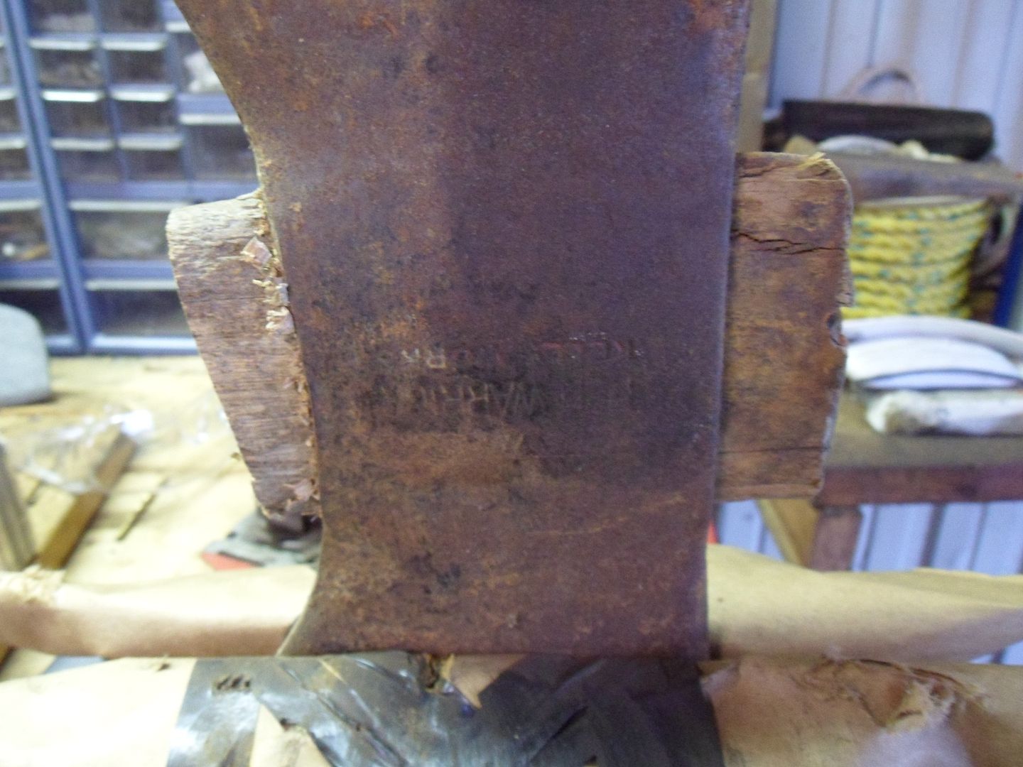

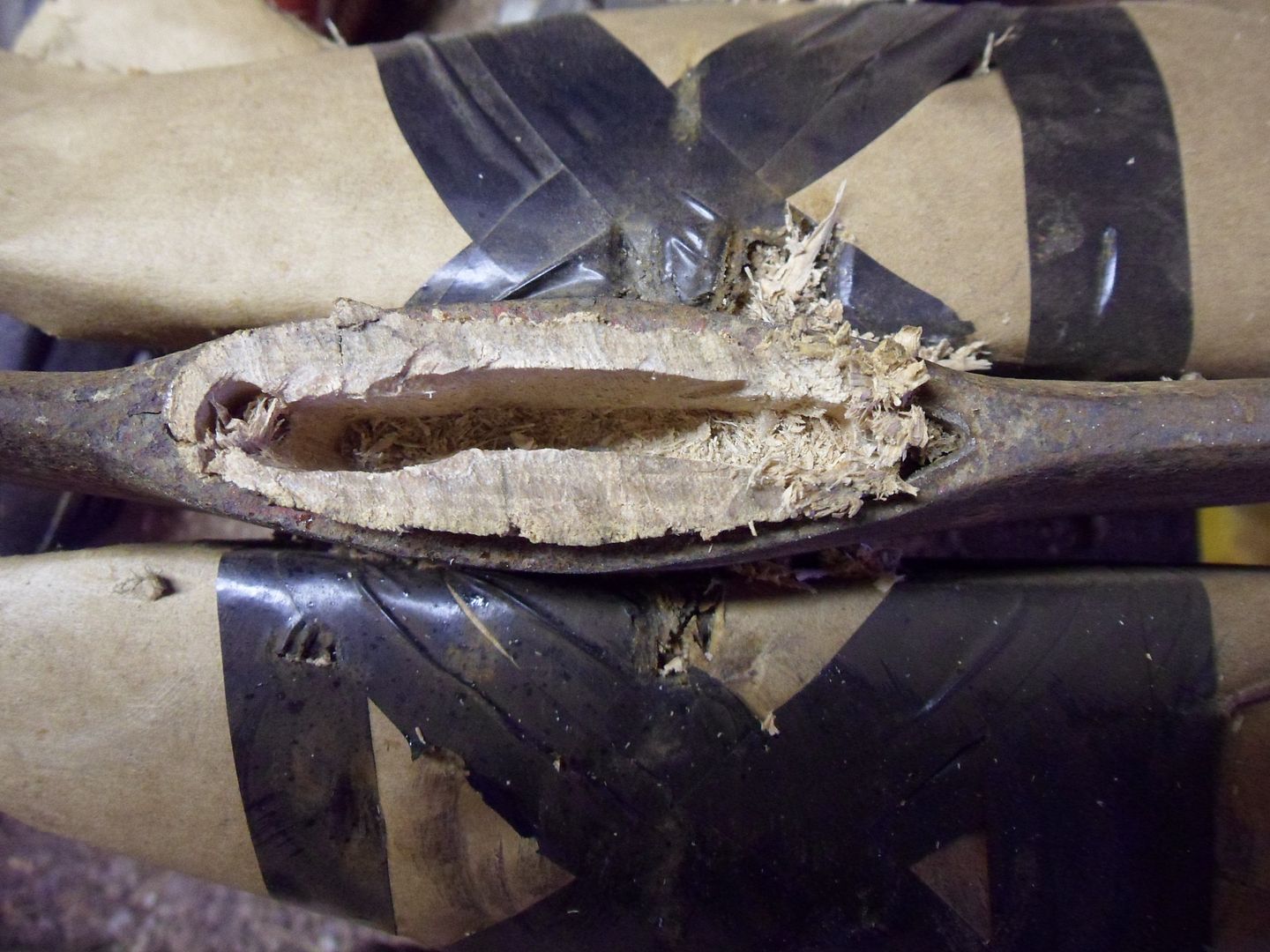

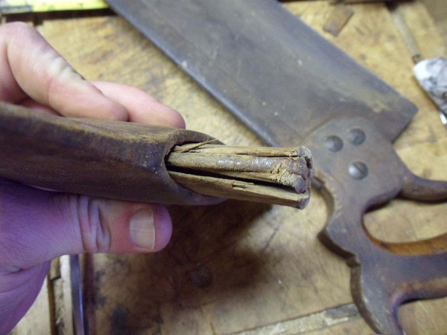

So first off I am looking at the eye saying what in the name of axes happened? Check this guy out -

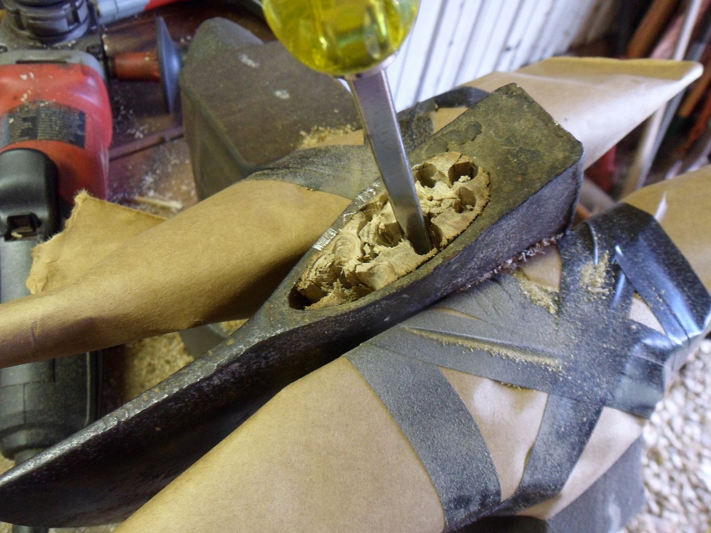

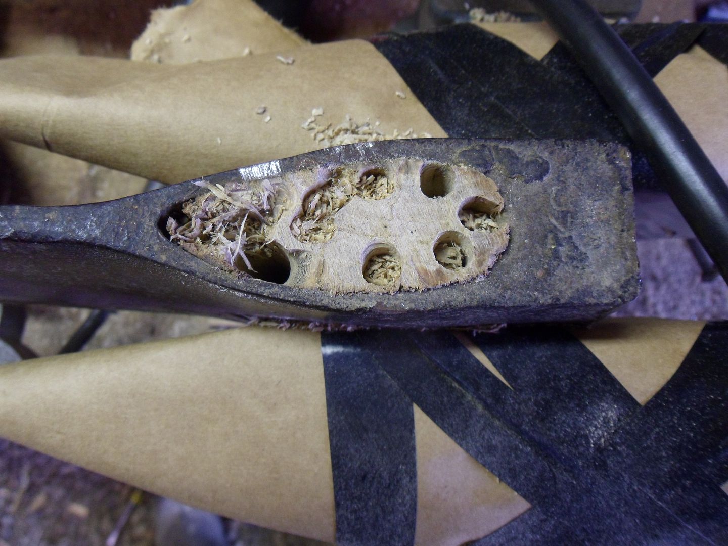

So I tried the basics - tried to knock it side to side with hammer and screw driver - didnt budge. Tried to hammer it totally out from below to the top of the eye hoping I could just pop it out, didn't budge.(sometimes works, sometimes it don't)
So I got the drill and started to do some work/exploring -
Drilled those holes in hopes of loosening the wedge - nope.
Then I went to the bottom of the eye and made a series of drill holes in hopes of making the whole thing weak and punchable -
So the series of holes in the bottom didn't really do anything either. So now I have to go drastic.

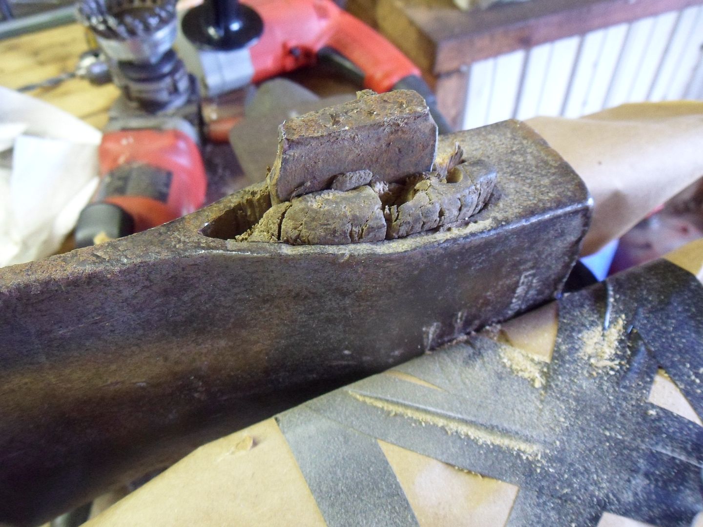

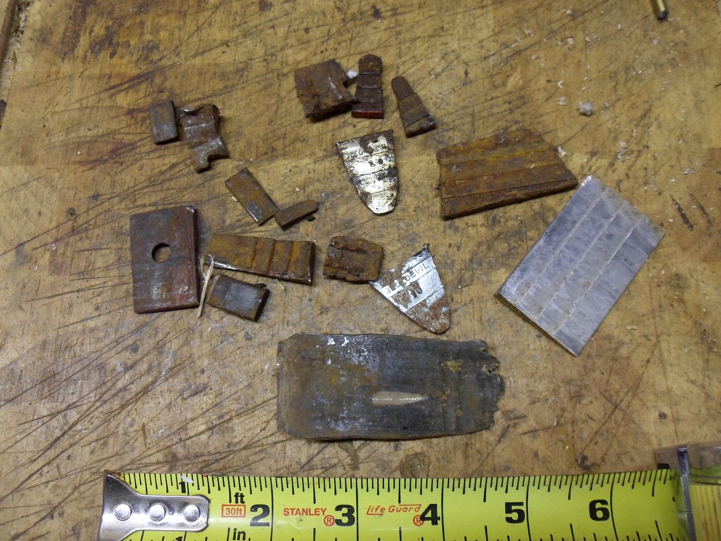

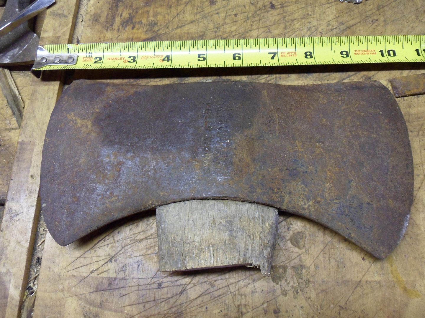

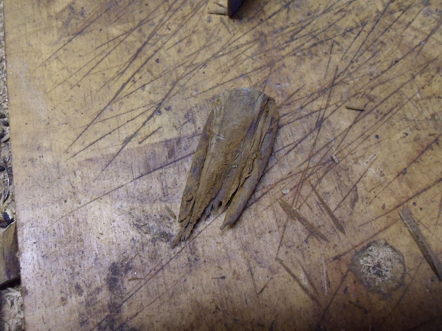

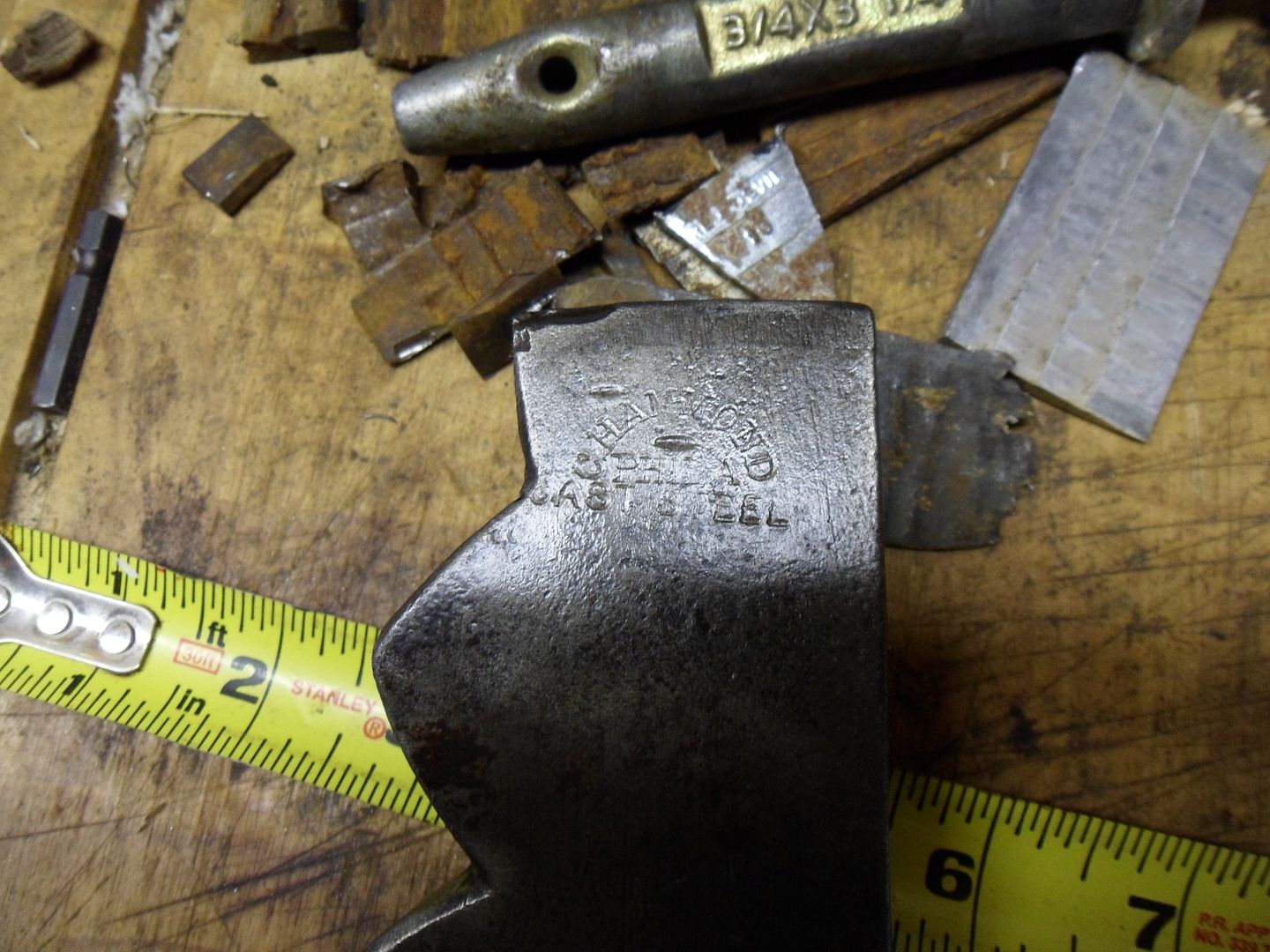

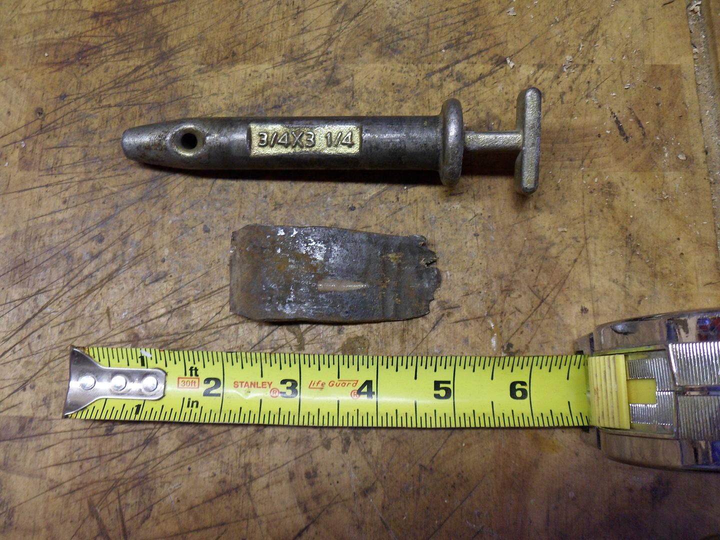

With my drilling I had hit the wedge from below. So I decided to pound it out from below seeing it didn't want to budge right side up at all -
With some hammer blows this is what comes out the other side -
Now, for perspective, this wedge is a BEAST. It is one of the biggest metal wedges I have ever seen in an axe head. Here are some comparison pics -
Here are some other wedges I have pulled out as of late and how it compares -

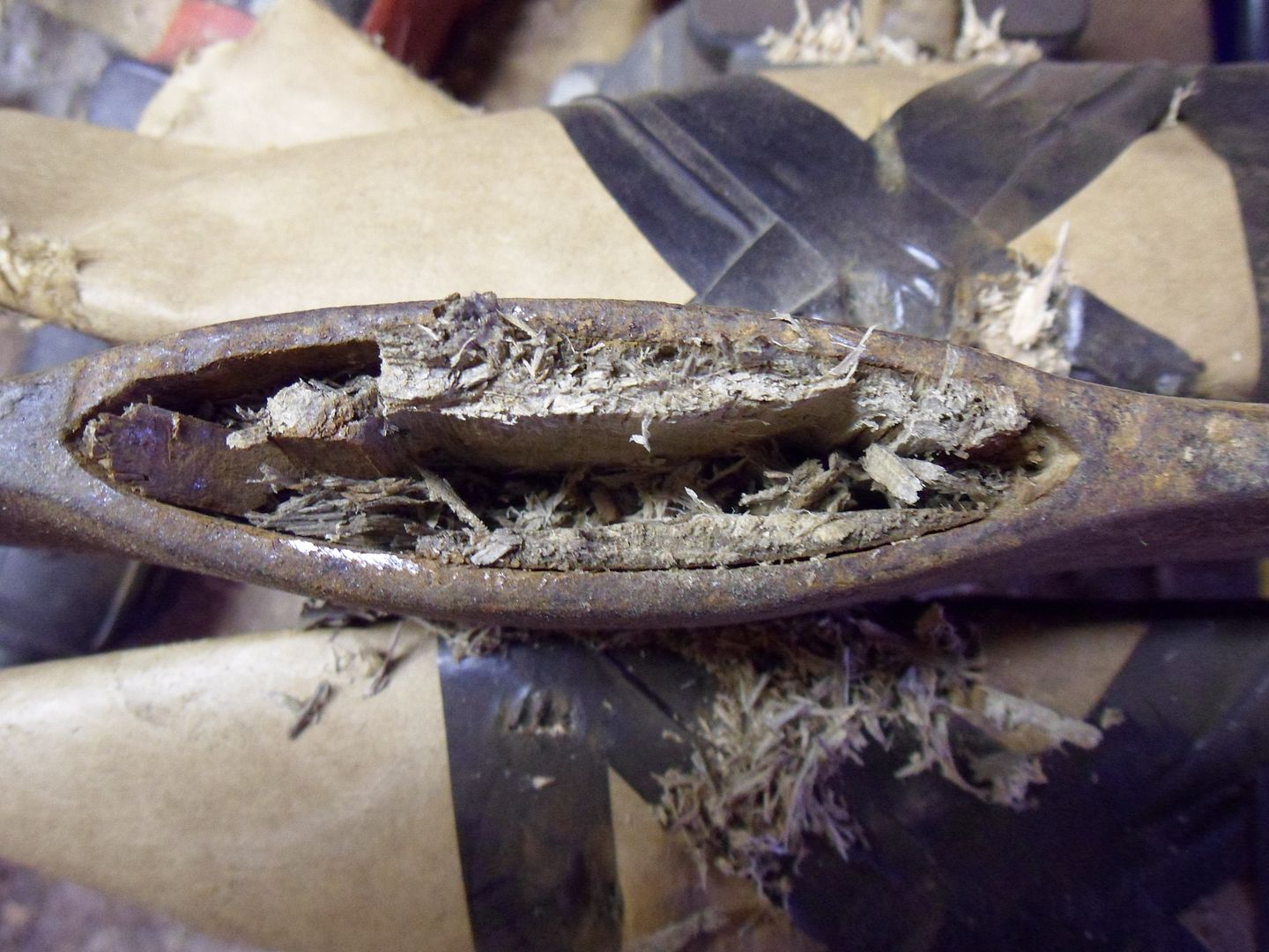

So once I got it out, I easily popped the handle out and got to work.

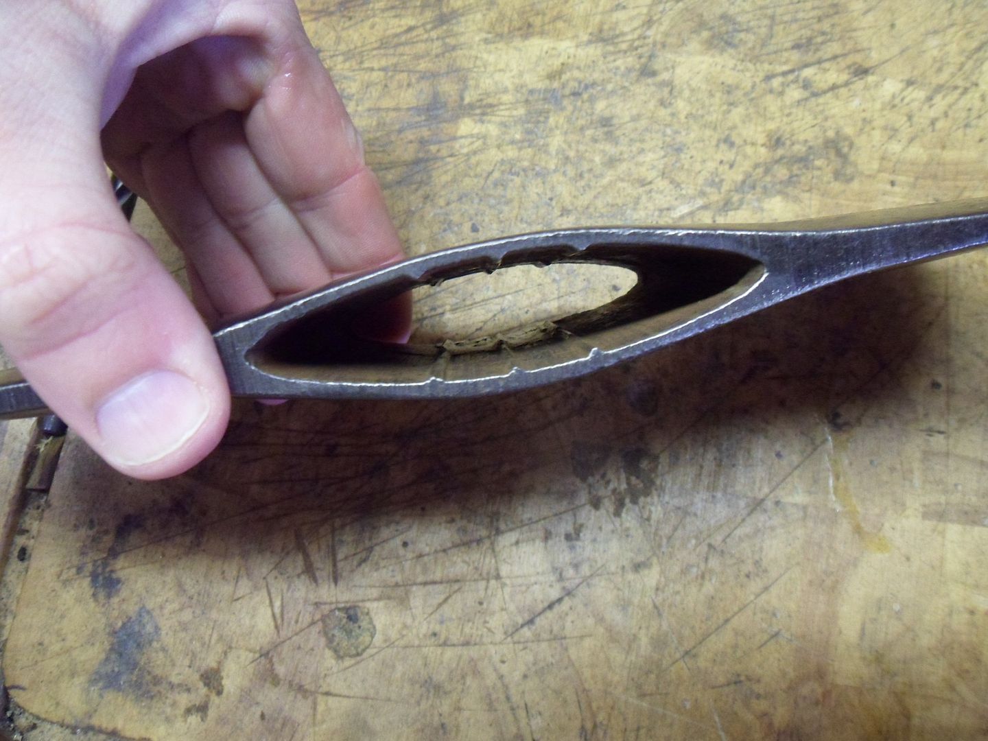

Upon further examination, the condition of the eye didn't help with trying to get the handle out -

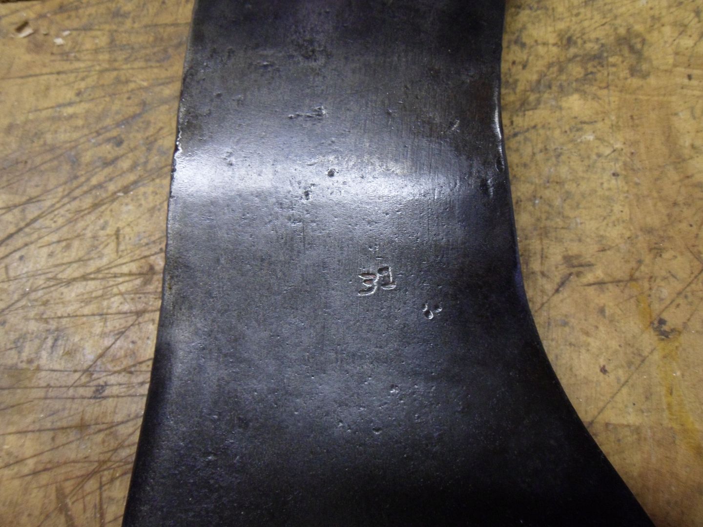

So, the James H Mann head was done. Looking at it, it says 27 on it, which I am not 100% sure how to take that exactly.
Lesson time - James Mann was tied up with AmericanAx company in the later 1800s when it formed, but then left in early 1900s. If the 27 means 1927, this means James H Mann was still making axes up until that time frame, which I was unaware of for sure - and the anchor - I am not sure yet either. So it is a possible curve ball in the history of axes - but I will find out.

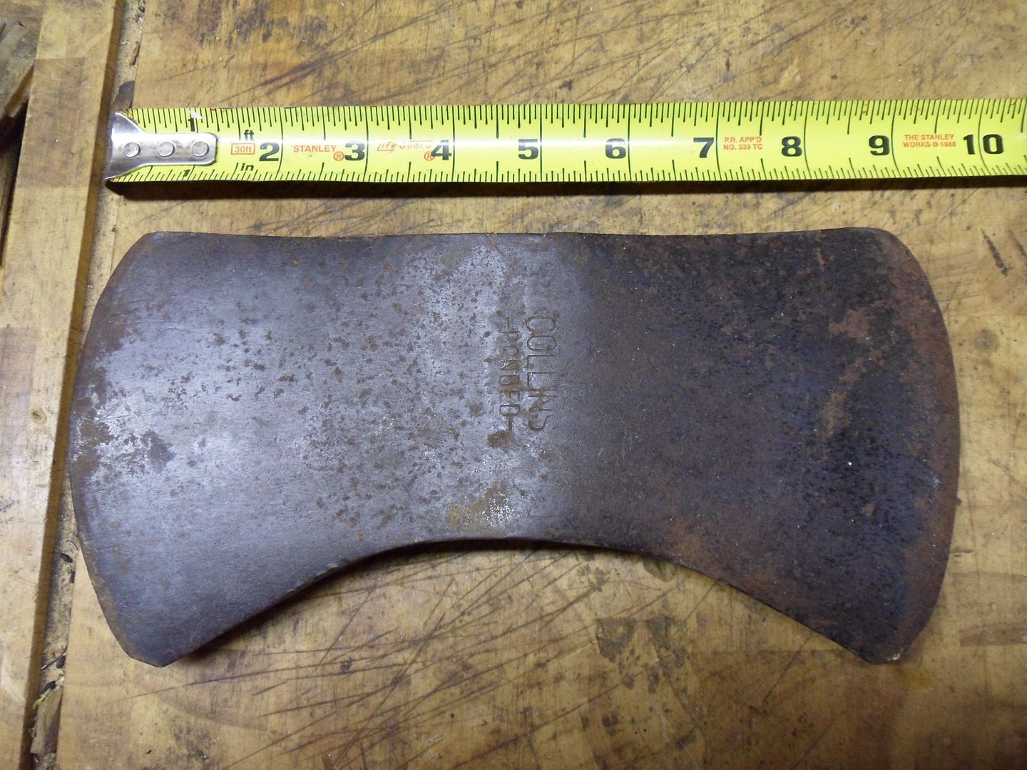

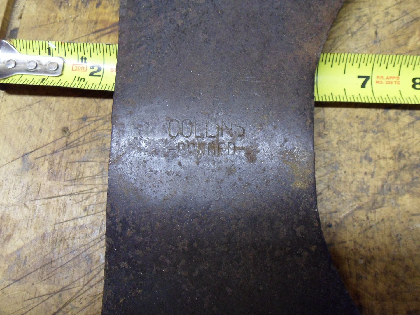

So on to the next - Collins Bonded -
It cleaned up fairly easily and quickly -
Fun Fact - The Collins Bonded line was created to compete with the Plumb Permabond line. It was to be the Cadillac of the industry. If that is/was true is up for debate. Here is an old advertisement - hope you can read it.

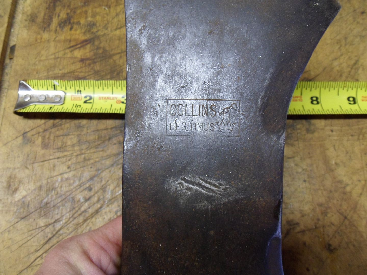

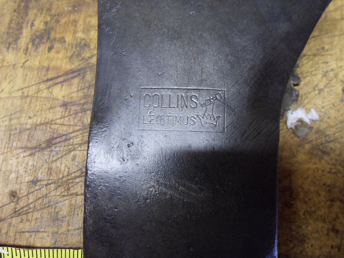

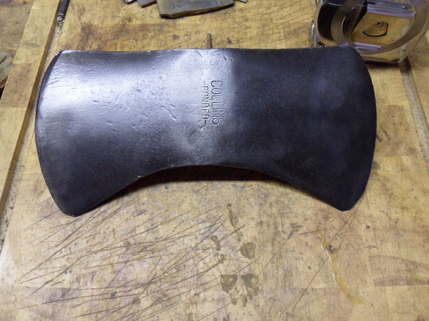

And so then on to this - Collins Legitimus Cruiser
Again this one cleaned up fairly easy and went smooth overall -
Collins Legitimus is/was one of the most recognized and protected trademarks in the axe industry - Collins was very well known for bringing legal claims against any competitor who tried to use that name in anyway without permission.

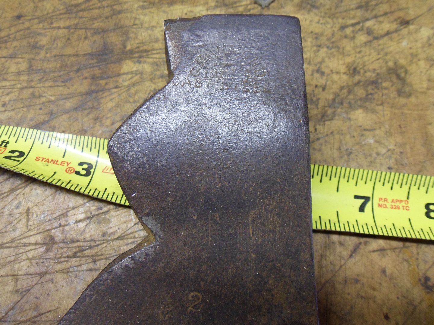

And then on to this C Hammond hatchet - what a beast -
This one cleaned up a little longer, had some more work to do, but it came out pretty well overall -
C Hammond is what got me into axes and hatchets really hard core. The previous owner of the house I bought in 2002 had a few Hammond hatchets, and once I decided to clean them up, and then research them, it was over. No one knows exactly when Hammond went out of business, but they made mostly hatchets overall, and some swords for the Civil War even. There is some debate as to which side Hammond made the swords for, but being based right outside Philadelphia it would be hard to imagine them making them for the South.

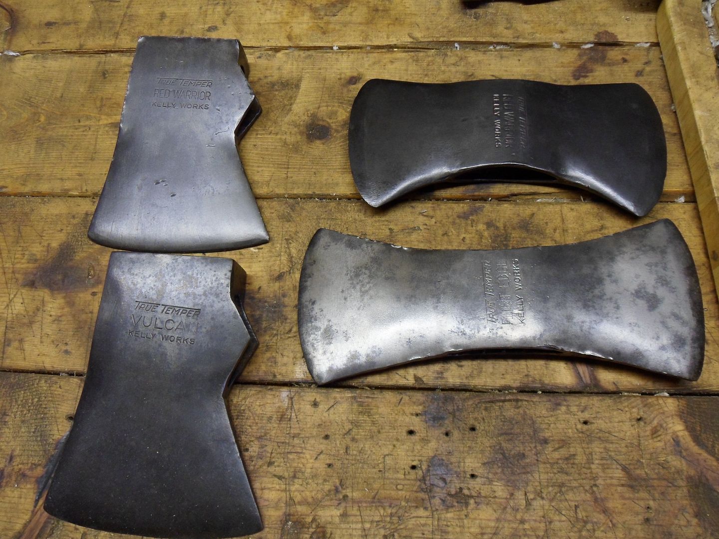

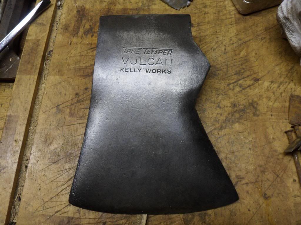

Ok so now on to this beauty waiting to be released -

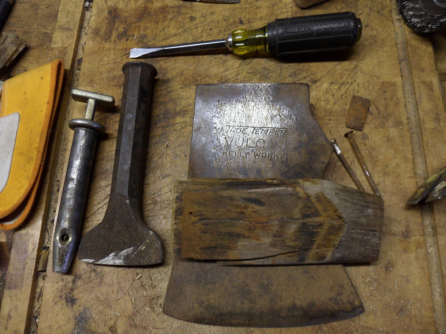

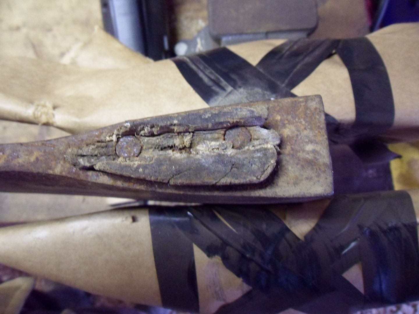

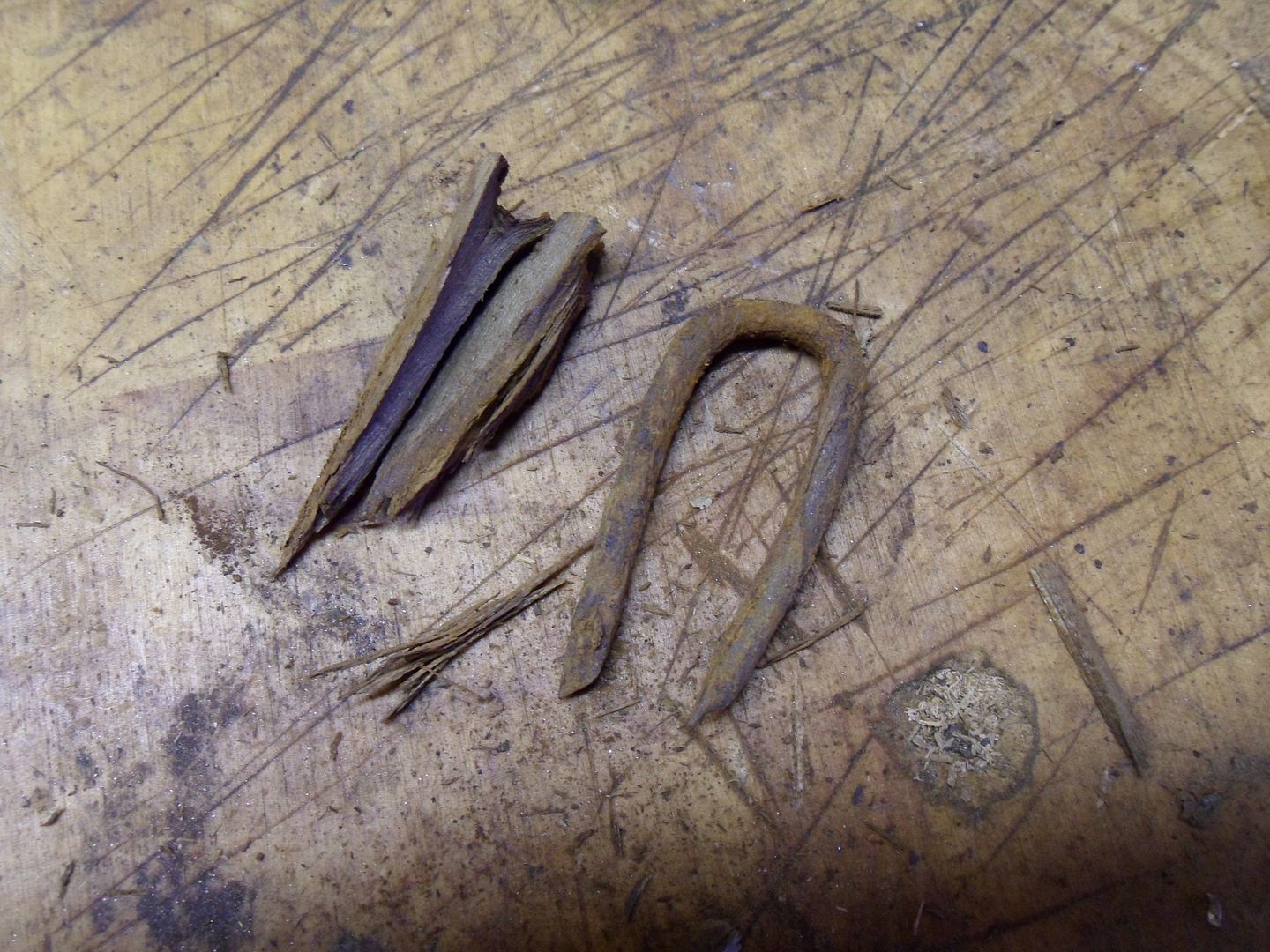

Of course you see that handle still in there, and I was dreading it - as most of these big jerseys don't give up their handles that well overall - here is a look at what I was dealing with -
So a couple of nails in there - doesn't look that bad overall - so I drilled my holes to find out whats going on as usual -
Standard overall - popped the nails out and found a small wedge hidden in the middle - was able to pop it out and then pound the handle out from underneath -
I am very happy with how it cleaned up -
Side Note - Vulcan is actually an old line name that has been around forever - this marking though is pretty common in the early/mid 1900s. Keep an eye out for the Vulcan with the blacksmith on the axe head - pretty rare.

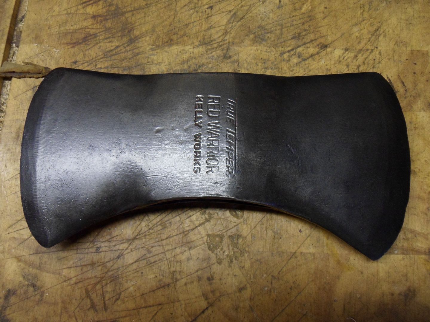

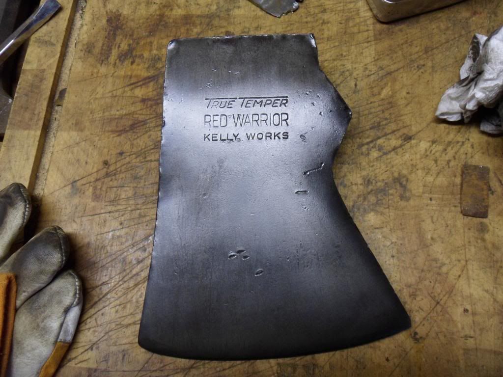

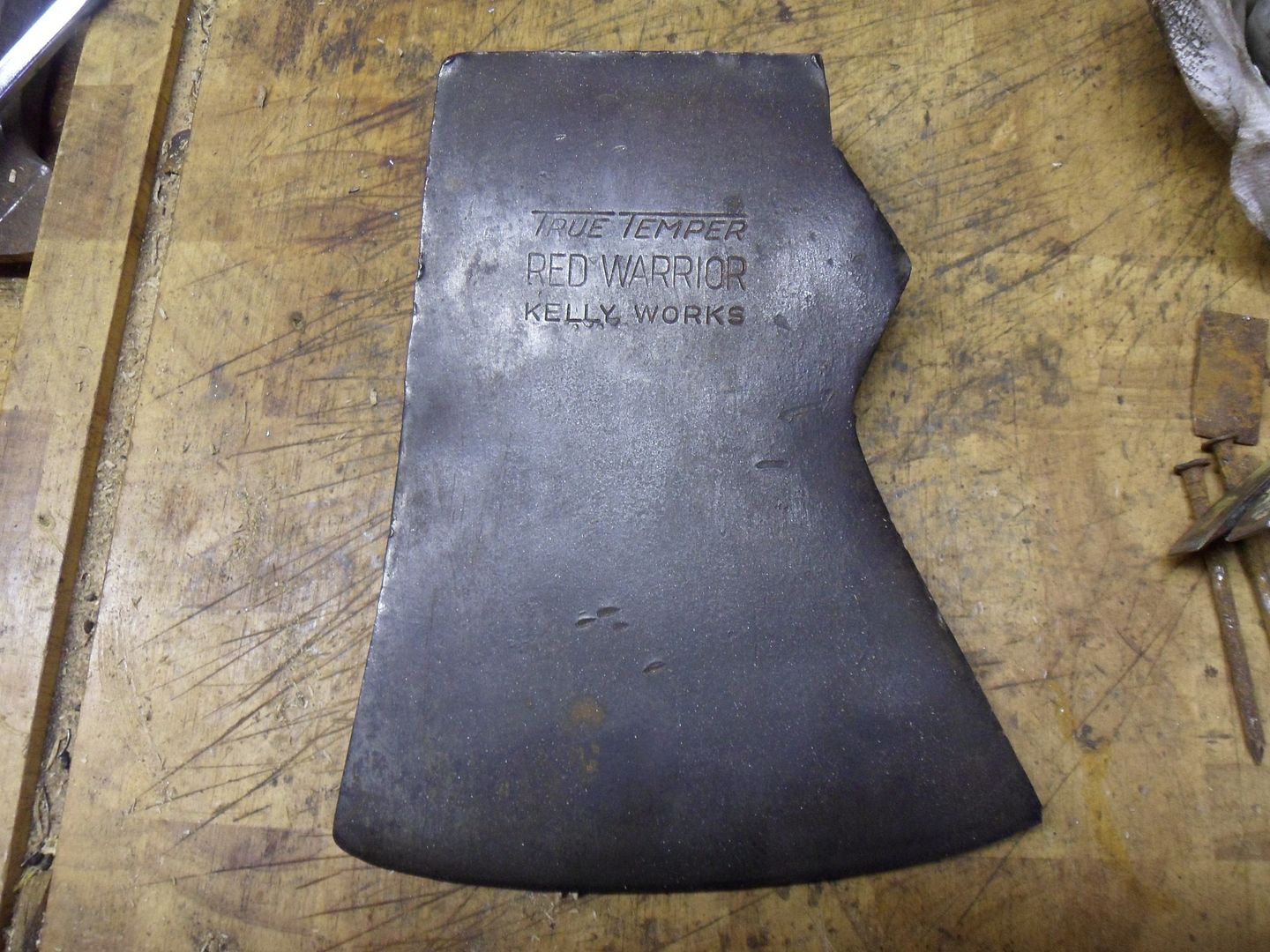

Ok so then on to this guy (look similar?)
It cleaned up well - not quite in as good of condition as the Vulcan but a keeper none the less -
The Red Warrior line was originally part of the Mann family. With the creation of the AmericanAx and Tool Co in the late 1800s - this line was absorbed by them. Then in 1921 when Kelly bought out AmericanAx it had rights to the name. Whew!

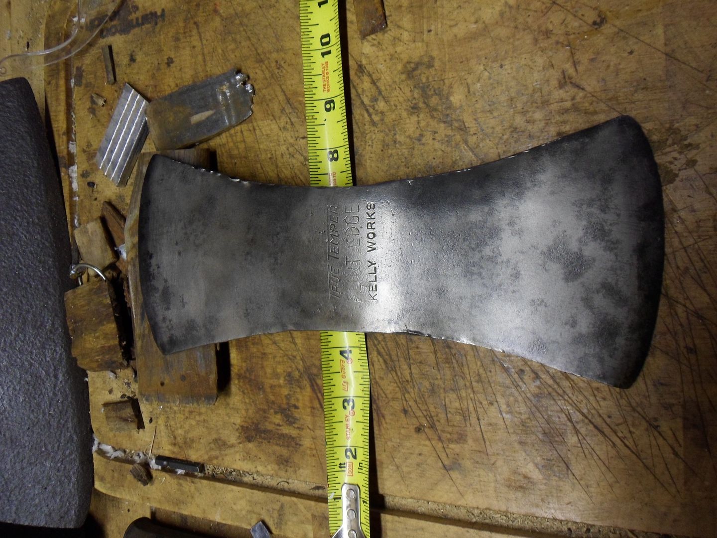

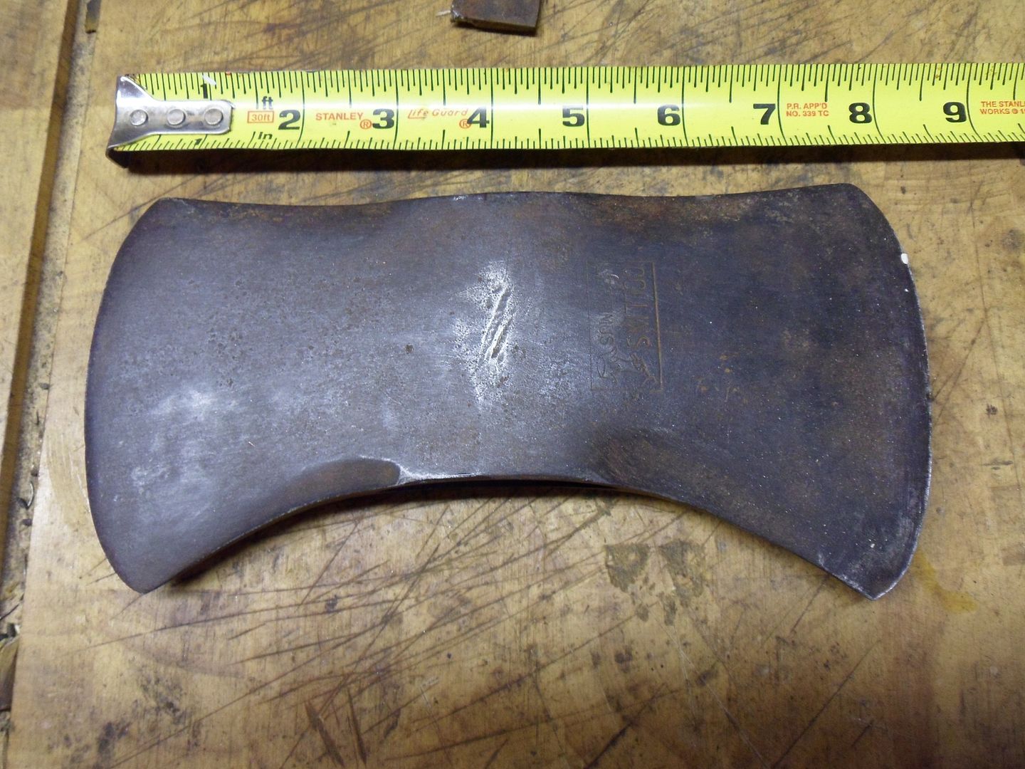

Ok Kelly Flint Edge with weird patina to it already -
And behold! Ridges in the eye!
It cleaned up ok, but still weird markings on it I could not get rid of with the angle grinder.....
Kelly Flint Edge is an extremely old line from way back - you can find almost any kind of axe/hatchet with the Flint Edge name on it from Kelly.
