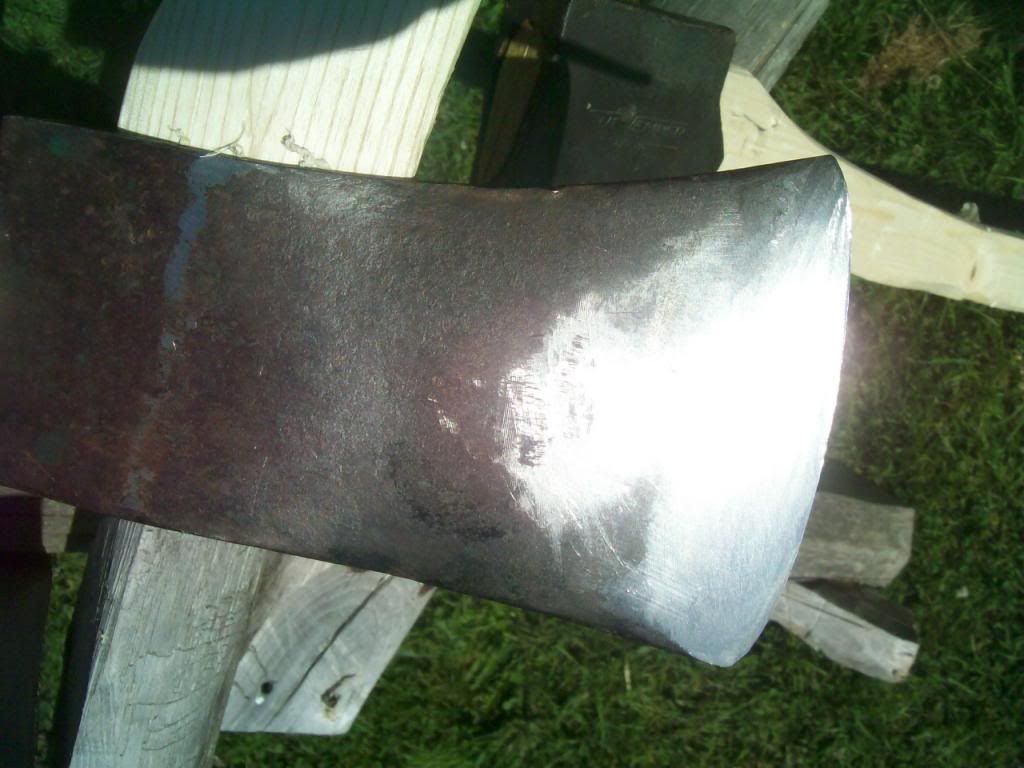

having a hard time visualizing this. Can you post a closeup picture of one of your sharpened axes
Sure thing coop.

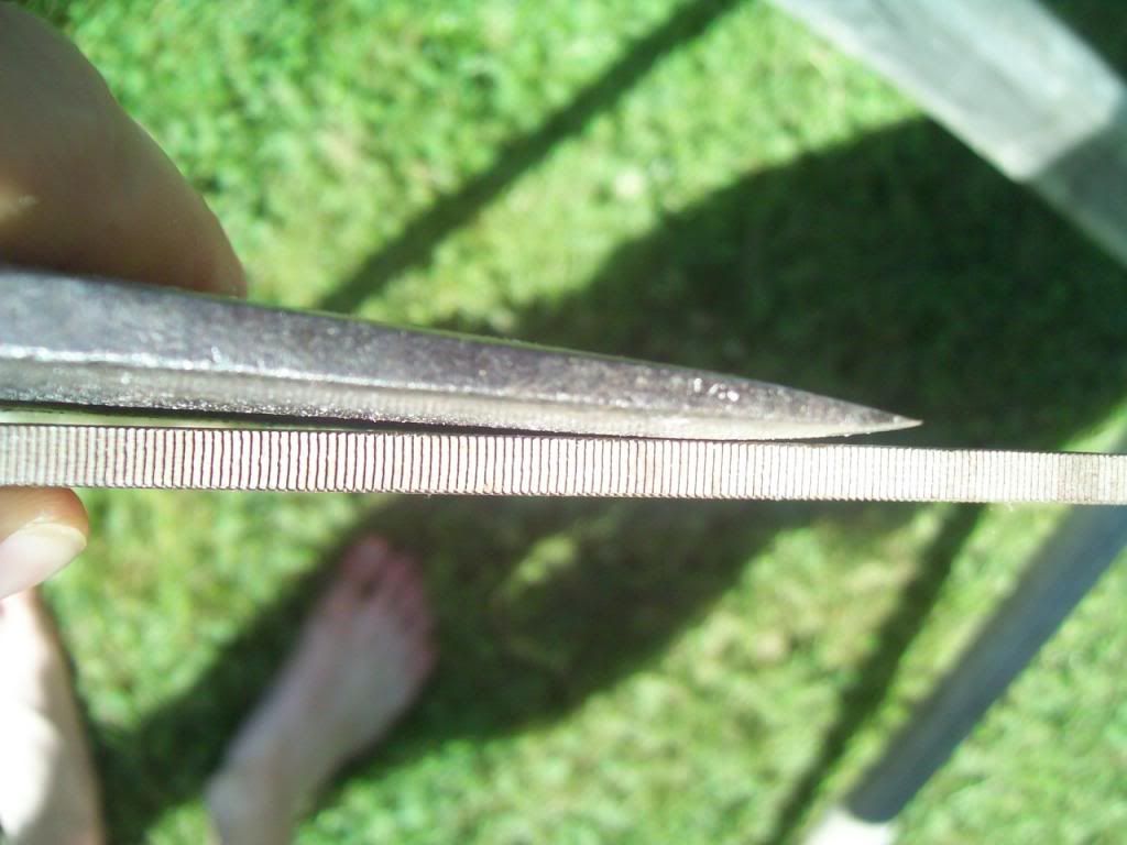

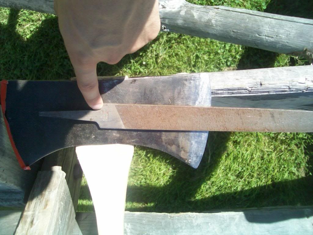

I just use the straight edge, or file, to gauge where I need to be doing more filing.
Looking this way ye can see the point of contact. That hump needs to be thinned down and gradualized into the context of the face of the axe. You can file the hell out of the face without negating the effect of the high centerline. If you just sharpen a bevel radially, the axe hardly penetrates at all, so the high centerline doesn't even need to be there to prevent binding in the first place. There'll always be a point of contact, its just a matter of optimizing the shape for the intended use. In this case, trying to gain more penetration.
Here's pointing to where it needs more filing. This changes and goes further back the more you file. You'll need to work on the rest of the face as well-- the first 1/2 inch or 3/4 or something.
Here's an axe done more up to my standards-- filed way the hell back from the edge. Almost "done" but I will leave it a bit meaty for durability sake.
