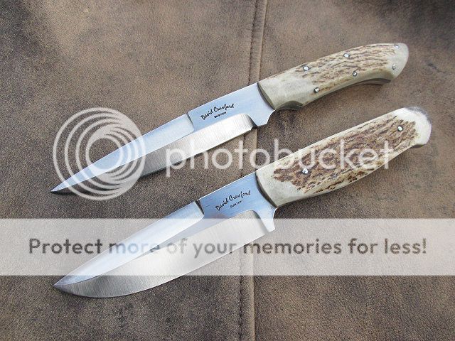

Here are a couple of double ground knives with Axis handles I recently finished.
Both are ground from 5/32" thick 1095 carbon steel.
Thanks for looking.

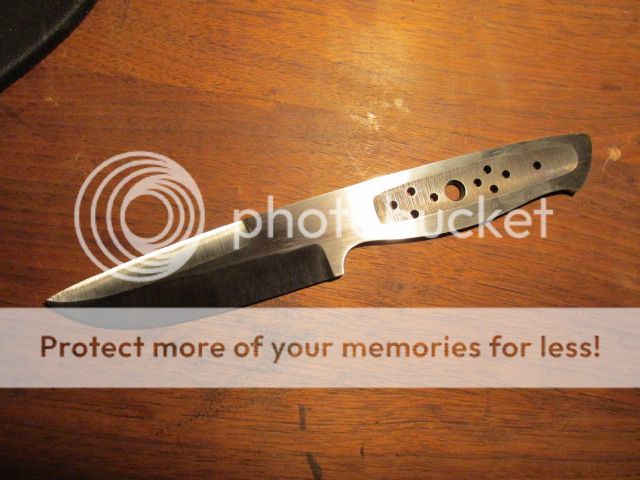

Good looking pair David...I especially like the top one. Nice handle shape and I'm a sucker for a sleek and pointy, double-ground sticker! Both certainly look like no-nonsense users to me. Just curious, are the handles attached by the pins only, or is there some epoxy, drilled holes etc. under there also?
Thanks Mike. The tangs are drilled thru and hollowed like so...
The first knife is also tapered. Also, both are epoxied with Hysol industrial grade epoxy.
The Hysol is really strong, has good shock resistance and cleans up very nicely with a damp cloth.

Good looking knives, David. Clean grinds.
