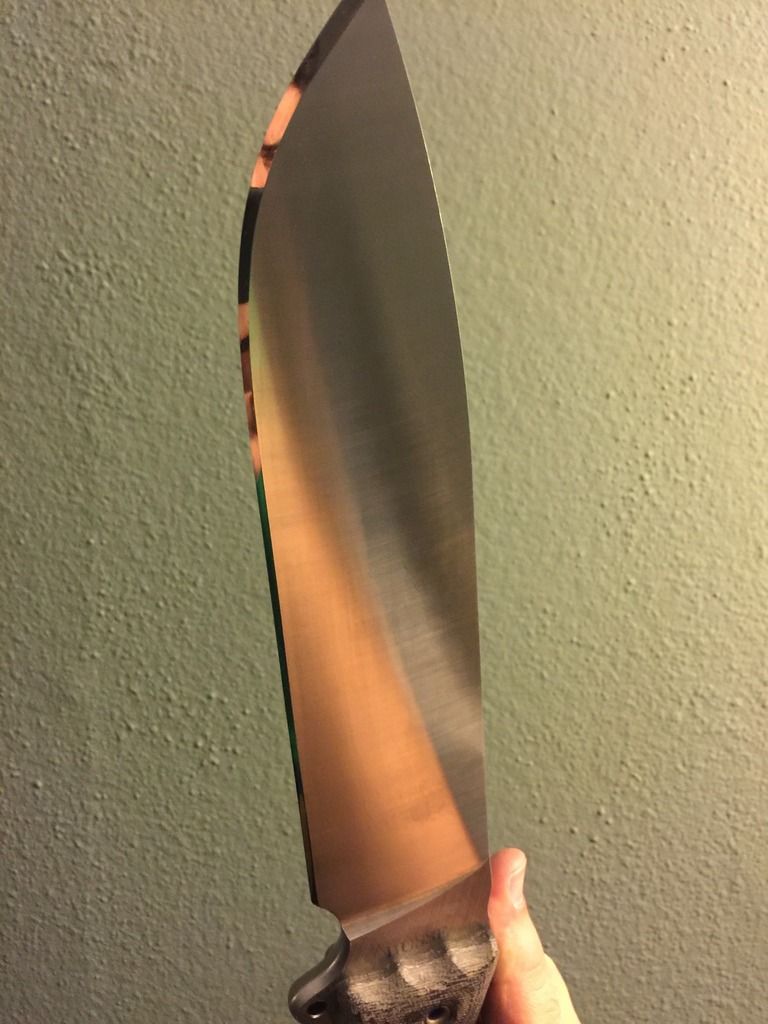

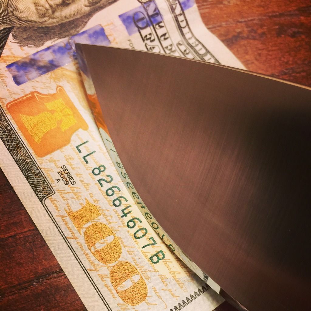

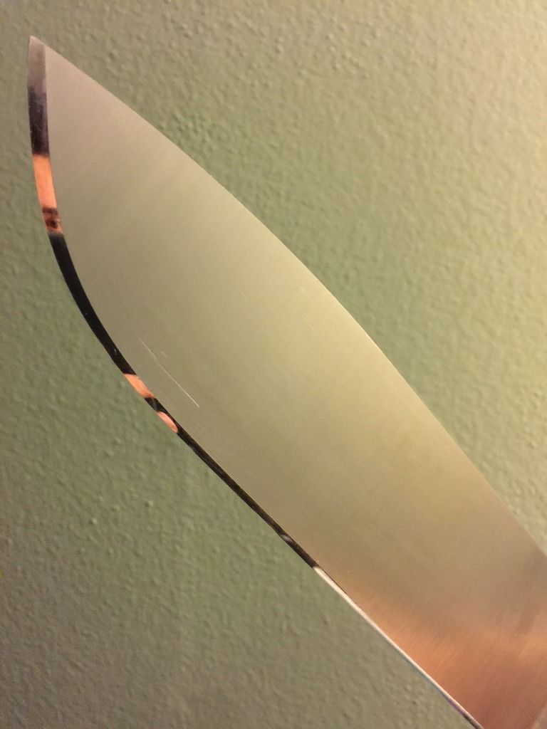

I decided to give my favorite 9 inch knife the long overdue edge/shoulder work it deserved. Now in the spirit of inclusiveness --- please feel free to post any pics of your NMFSH that you feel deserves the light of day. Here's mine --- I look forward to seeing yours :)
WOW, just WOW, that look so nice. From the looks I could only imagine that it cuts like a laser. It just look seriously sharp. Taking sharp to the next level. Along with that I would think the mirror finish would cut cleaner too. You would not even know your cut until the blood flies.

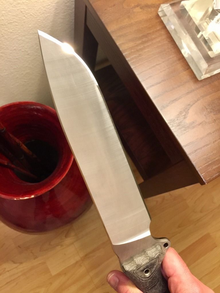

Heres Mine, doesnt have a mirror edge, but still shaving sharp. it started out as BIG finish, but previous owner sent it out, (i gorgot to who) made it satin, all but Ricaso, and put a Razor sharp edge on it. 1 of my favorite blades

Thanks guys!! I really appreciate the kind words. What can I say --- I'm obsessed with the Steel Heart series!! Thanks Jerry!!
For those wondering --- the edge was sharpened to 19 degrees (38 degrees inclusive). The following Grit Progression was used:
Diamond Stones: 100, 200, 400, 600, 800, 1000
Ceramic Stones: 1200, 1600, 1.4 micron, .6 micron
Balsa Wood Strops: 5 micron, 3.5 micron, 1 micron, .5 micron
