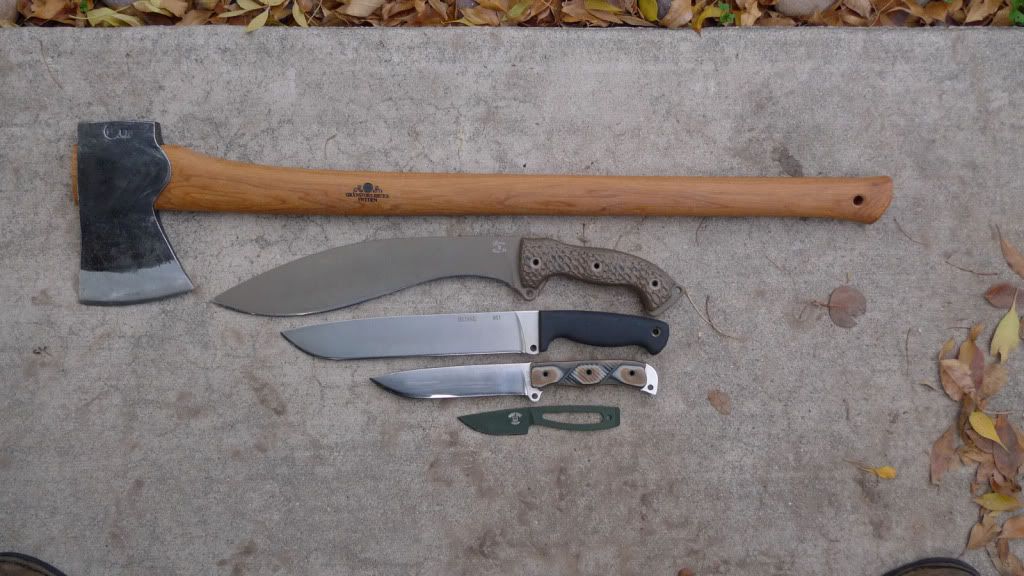

Got a basic 10 in the mail yesterday :D
Top to bottom: cs ttkz, b10, proto boss jack, scrap yard scrapivore
It's a really nice knife. Several people have said that they feel glad to have passed it up and kept the basic 11, or are keeping the basic 11 over it. I'm the opposite, I'm happy with having sold the b11 and gotten this. It's thinner, lighter, not quite as long, but with an equal amount of edge. I don't have any major problems with it at all, across the board. With the basic 11 I could also say "If only it didn't have a choil". While the basic 11 is a better chopper than this, it's a better chopper with a few small compromises, depending on what you want out of your knife. It's got a thicker edge, it's got a choil, it doesn't have as much belly, it's heavier, it's got a (slightly) thinner harder feeling handle. The b10 is lighter, has the same amount of edge, has a slightly softer slightly thicker handle, it has no snag points when chopping hard at vines or over expending your reach on branches, it's got a thinner edge, and it feels closer to being a heavy machete than a dedicated shopper.

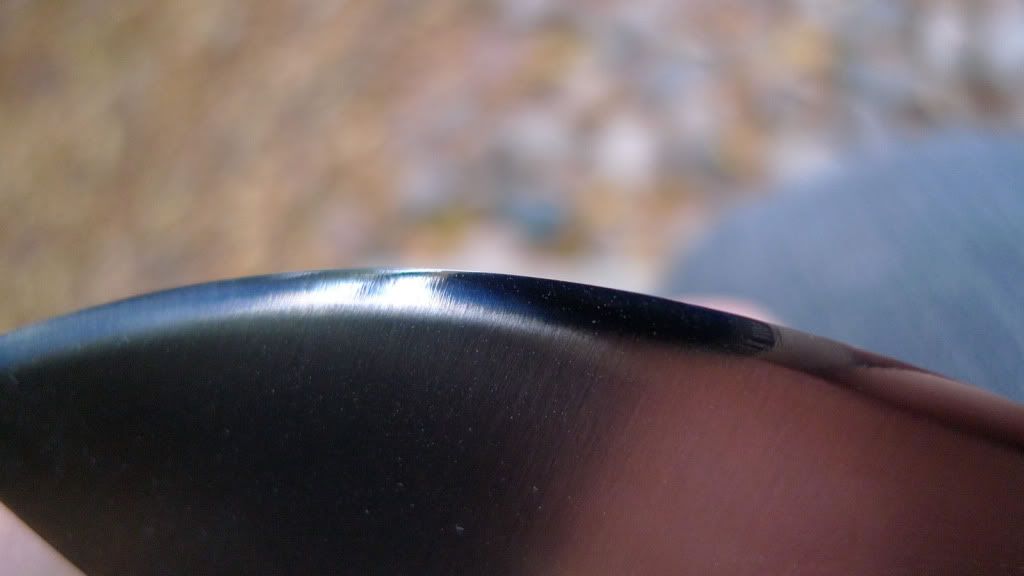

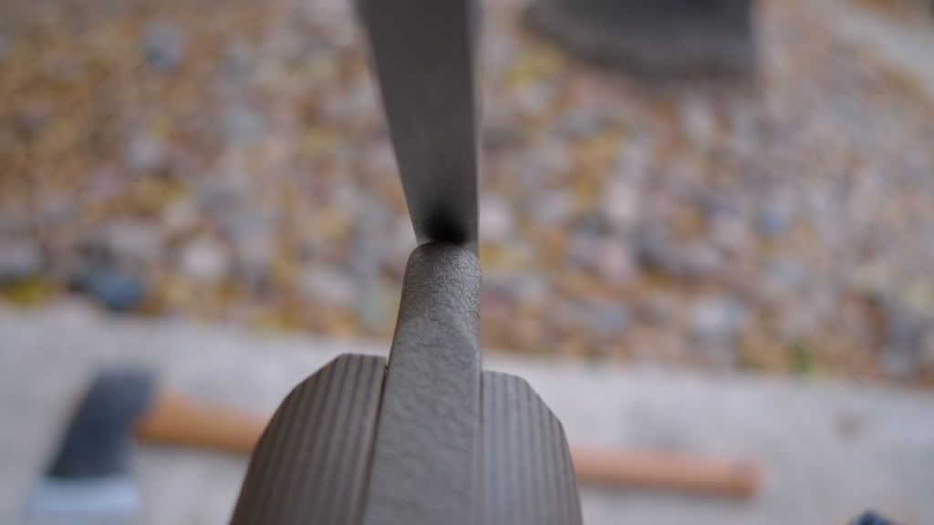

one of the other major differences is the spine. The basic 11 has a simple machinists style edge break of around .010", meaning someone took a file to the corner so it wouldn't be a razor sharp 90 degree edge that could cut you if you grabbed it. The result is a less-comfortable chocked up grip for skinning/other tasks, but it does have another advantage.
totally flat compared to something like the TTKZ's nuclear meltdown treatment:
.010" machinists edge break:
less comfortable with the sharp edges, but tolerable, especially with gloves of any sort:

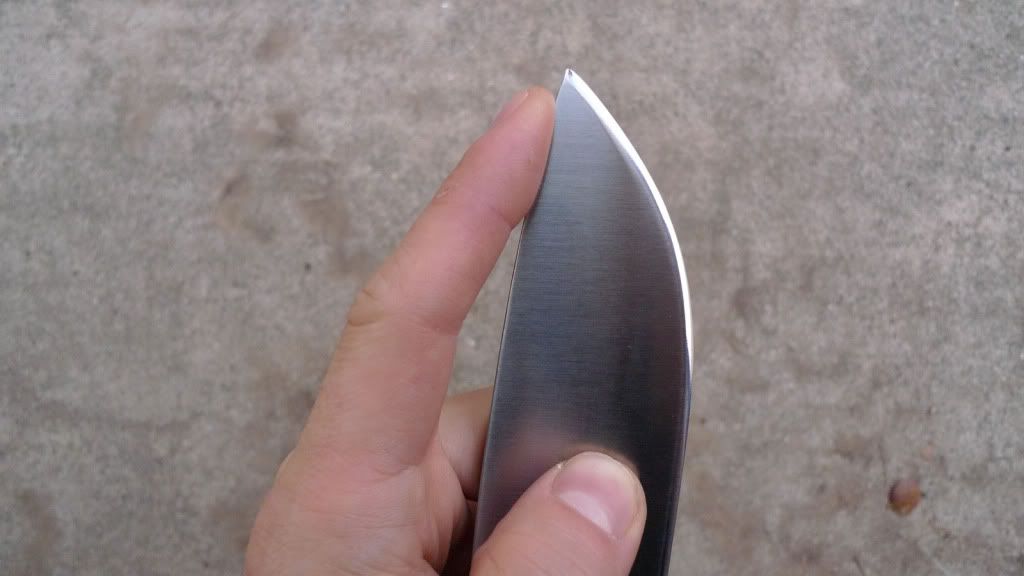

The basic 10 also doesn't have the straight edge at the tip:

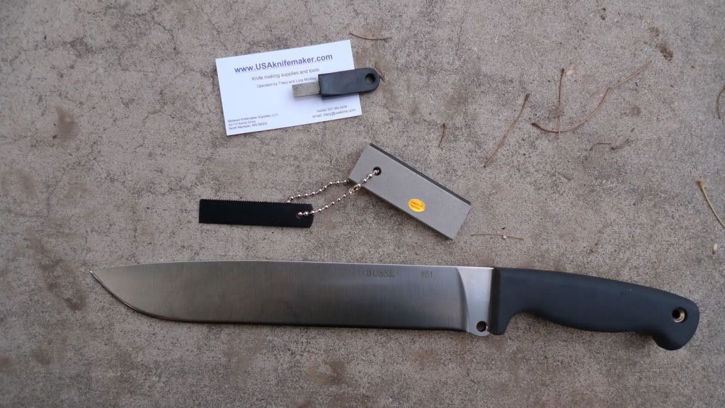

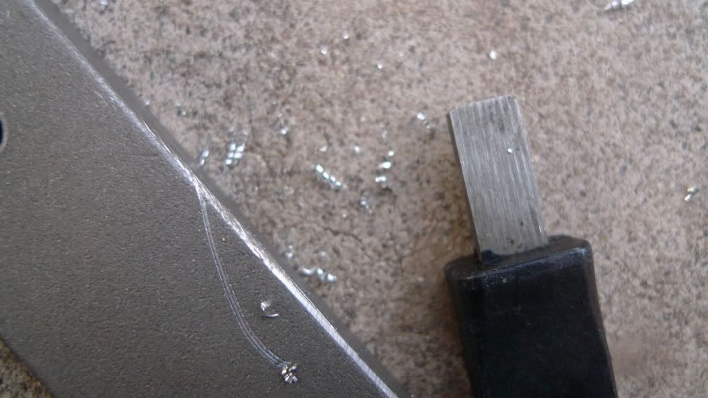

why would you ever want a sharp edge? heres an aluminum/ferro rod block with 3 edged tools. A small saw provided with the block, a carbide striker from usaknifemaker, and the b10.
the saw creates fine powder and throws it everywhere, hard to make a pile, it also eats up the block making it jagged
The carbide striker is by far the best, creating nice curly q's in a controlled pile
this is what you get when you leave an unbroken edge on a high hardness steel or carbide, an edge that can be used to scrape or cut as though it were a knife,
The basic 10 didn't fair as well, but definitely better than the saw. It created crescents in a controlled pile. Even with a .010" edge break, it's still sharp enough to scrape and strike with.

The straight edge at the tip on the basic 11 is just a little weird to me. I don't necessarily have a preference as I don't use the tip much, I just always have smaller blades with flatter tips for anything I'd ever need it for. I don't however have a broad radiused edge like on the basic 10 on me otherwise.
