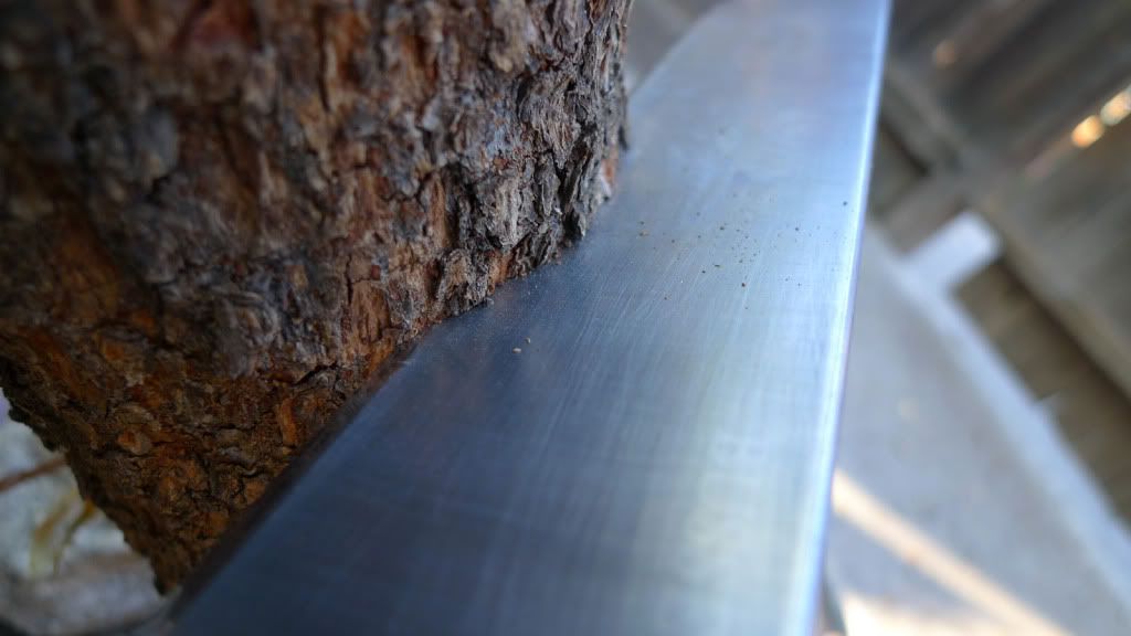

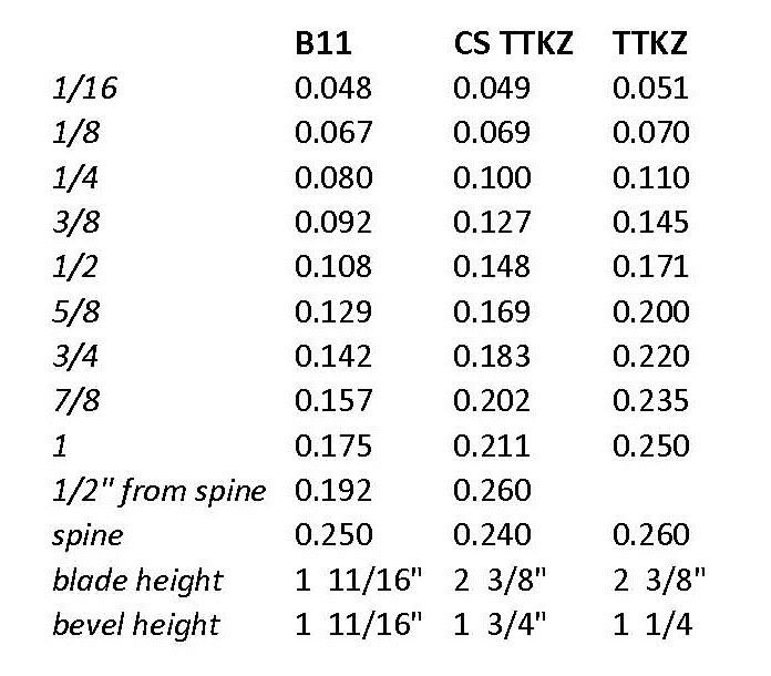

I beleive the sticking is entirely an issue of geometry. The basic 11 is a full flat grind and the CS TTKZ is very much a convex grind. The result is like trying to slice cheese with a flat knife, you end up getting the full sticky friction and pressure across the entire surface of the knife. With a convex grind you get a smaller percentage of the flats touching which results in less friction, less likelyhood of getting stuck, and less force required to remove it. Here's a small sample of the geometry difference between the original stock TTKZ, the Custom Shopped (CS) TTKZ, and the B11:
The vibration issue is likely due to a combination of the CS TTKZ having a taller blade with more curves, and a full exposed tang handle. The thinner tang on the B11 is probably doing what jerry described when talking about gutting tangs and acting like a tuning fork.

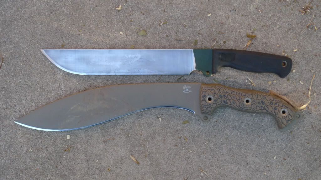

The knives, Basic 11 and CS TTKZ. Both knives have had the same edge treatment, a 24 degree per side primary, and an 18 degree per side relief bevel, brought to a mirror polish:

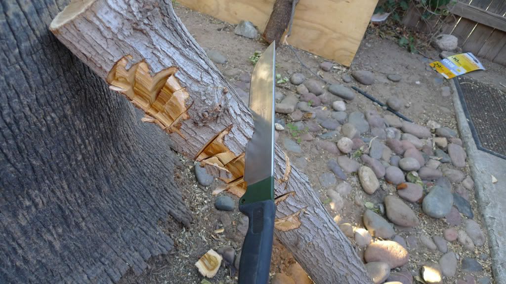

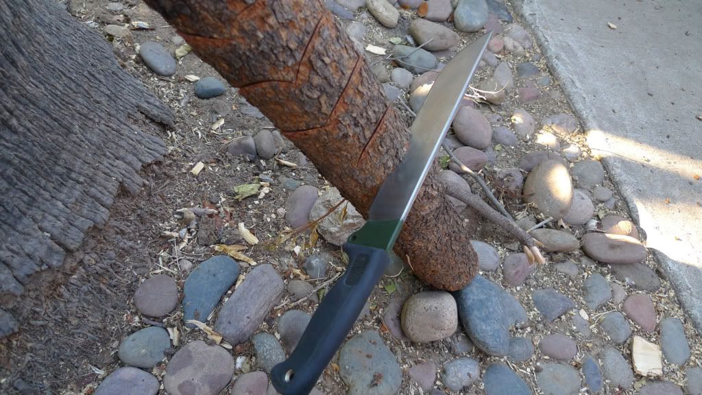

B11 in Mulberry:

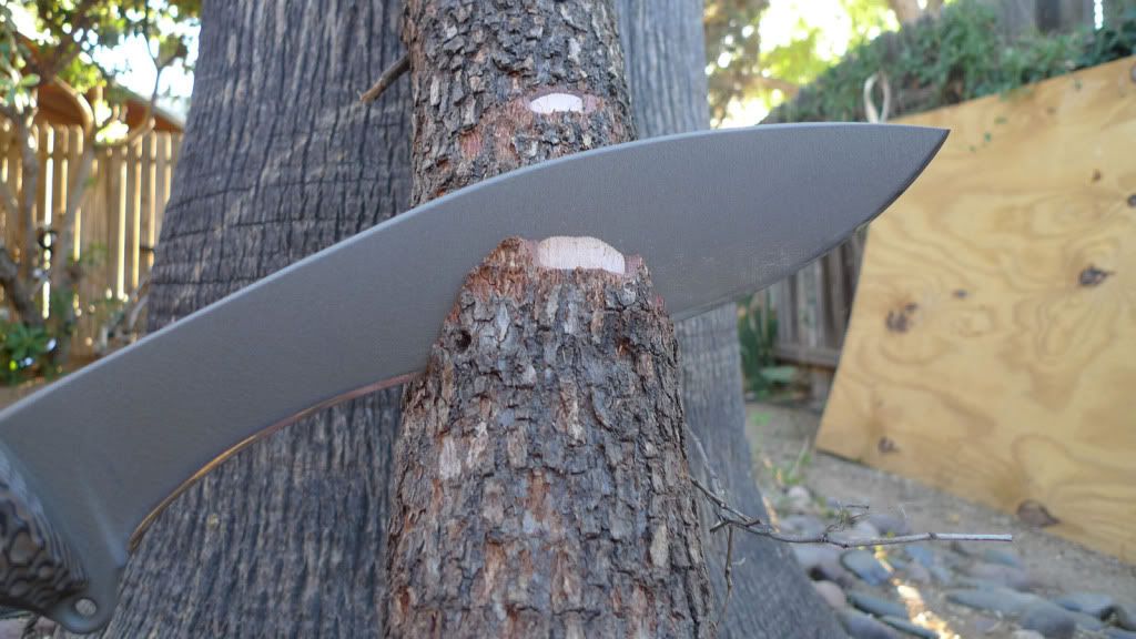

CS TTKZ in mulberry, deeper cut with less forearm strength, more in the shoulders:
Basic 11 sticking in the mulberry. It does this much worse when splitting, trying to extract the basic 11 from a knotted round of apricot wood required a wedge.

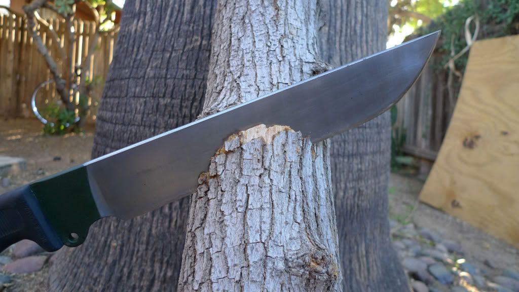

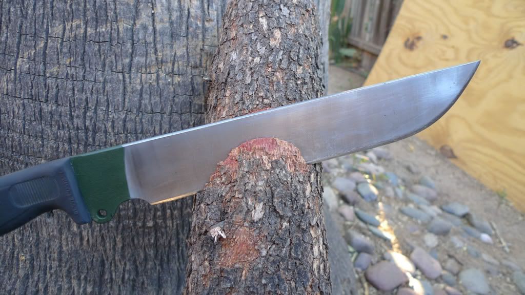

Basic 11 in mesquite:
CS TTKZ in mesquite:
it was a pretty deep cut:
This is the basic 11 sticking in the mesquite:

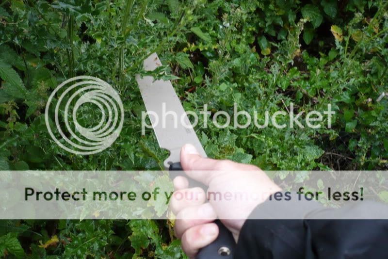

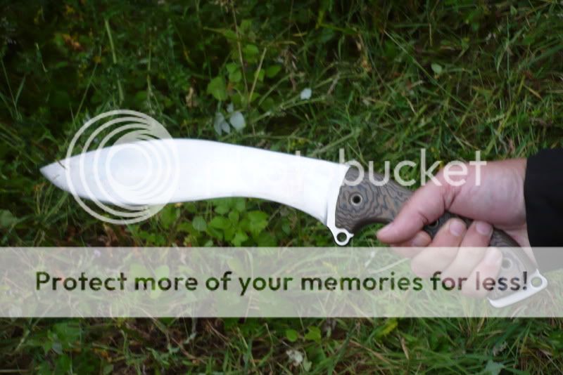

A while back I did a comparison of chopping a tree down with my modified TTKZ and a Gransfor Brux Small Forest Axe ... here is a pic from that review ...
If you look at the shape of the handle on the TTKZ you can see how holding it at a 45 degree or so wrist angle is similar to the angle you get on the end of the axe haft and both have the contact edge still below the wrist ... the axe more so ... but the khukri shape means it is not too far behind ... and the power and comfort you can deliver from a hand position like this is infinitely more than you can deliver from a flat "in line" blade ...
Here are a couple of shots to show what I mean about the grip angle ...
and this IMO leads to whatever vibration is generated being much more noticeable in your wrist and arm ... particularly with hard wood ... and this for me is why a khukri "design" just "works" so well as a chopper ...
You can see from simply looking at the knives that the angle of your wrist on the TTKZ Khukri is going to be in a stronger position.

The thickness at .260 to .280 could be thinned a bit so long as the ratio of the apple seed curve on the new CS blades was kept and combine this with some of the light brigade skills on the hilt and balance weight reduction there with a little off the length so the over all balance is the same and you start to make serious in roads to having the "ultimate" fixed tang carryable khukri ....
Now if you were to take a mold of the TTKZ grips and make a Res C slide on grip to match them ... then go for a Basic style tang you could seriously drop weight and by shortening the length retain the same balance and striking power ...
A 10 inch Khukri with .240 thickness and a Res C handle would probably come in at the weight of a B11 and again in my best "guess" would certainly out chop it and probably give the chopping power of a NMFBM or more ...

That makes a lot of sense. I still think that the handle the thickness of the resiprene-c on the basic series (thinner than the swamp rats) combined with the smaller overall handle plays a part in allowing the vibration to get to the hand on the B11, but the wrist position definitely seems like a huge factor in how it's felt.
The current TTKZ has a 12" blade and 6.5" handle, making it similar to an 18.5" Ang Khola, albeit half as thick and with a lot of weight in the handle. I'd love to see a span of models like the basic series -
