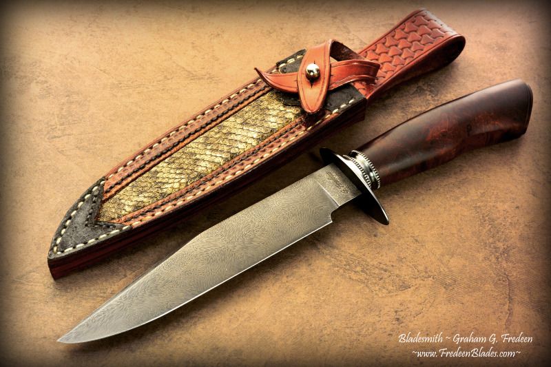

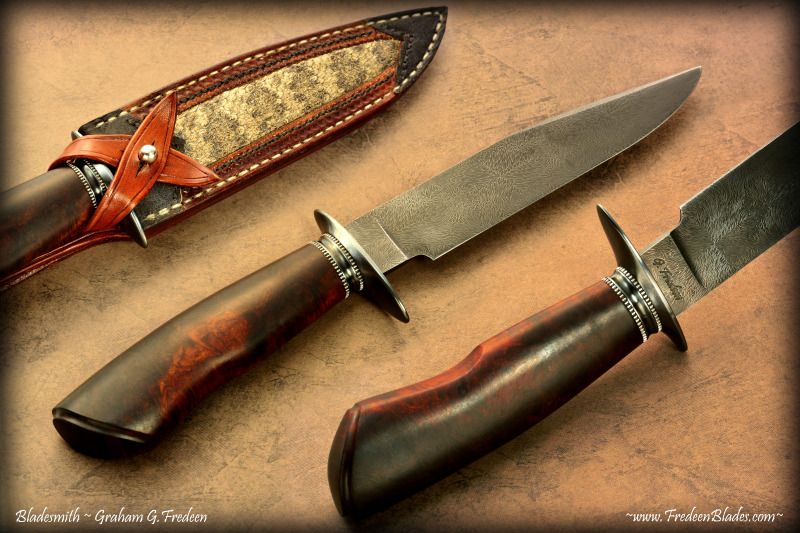

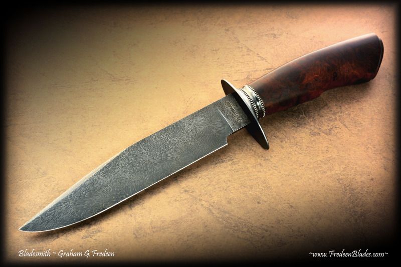

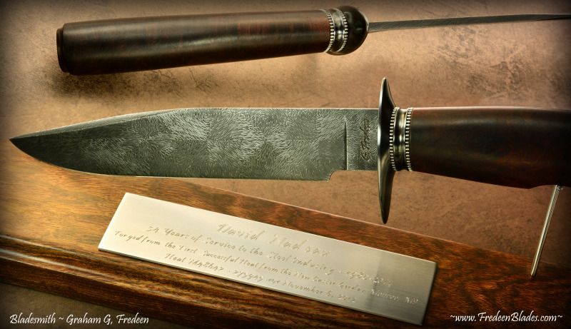

So without any further writing (hope this will be worth all the reading) here is the result:
I started the knife back in July of 2014 over a vacation I took the week of 4th of July. I did most of the pattern welding then and then, forged, ground, and heat treated the blade over various weekends in between, and finished the knife over Thanksgiving of 2014. From there it took me quite awhile to get around to making the sheath, and then up until now to finally get proper pictures of it taken. So it's been a bit of a work in progress for a good long while. I wanted to do everything on this knife myself, 100% sole authorship, due to it's personal significance, down to the pictures. While they aren't on the level of Jim Cooper (for example), I think I did ok.
As for the knife itself, here are the stats:
OAL: 10.875"
Blade Length: 6.25"
Handle: Desert Ironwood Burl
Mosaic Pattern Welded Blade composed of 15N20, 1095, and roughly 30% 1040 from the first heat from the New Caster.
Guard: 1040 from New Caster, Nitre Blued, 410 Stainless Spacers, coin edged
Sheath: Crafted by me, with Diamond Back Rattle Snake Insert.
Custom display stand with engraved plaque
Overall, not too shabby for someone as rusty with his knife making as I have been.
